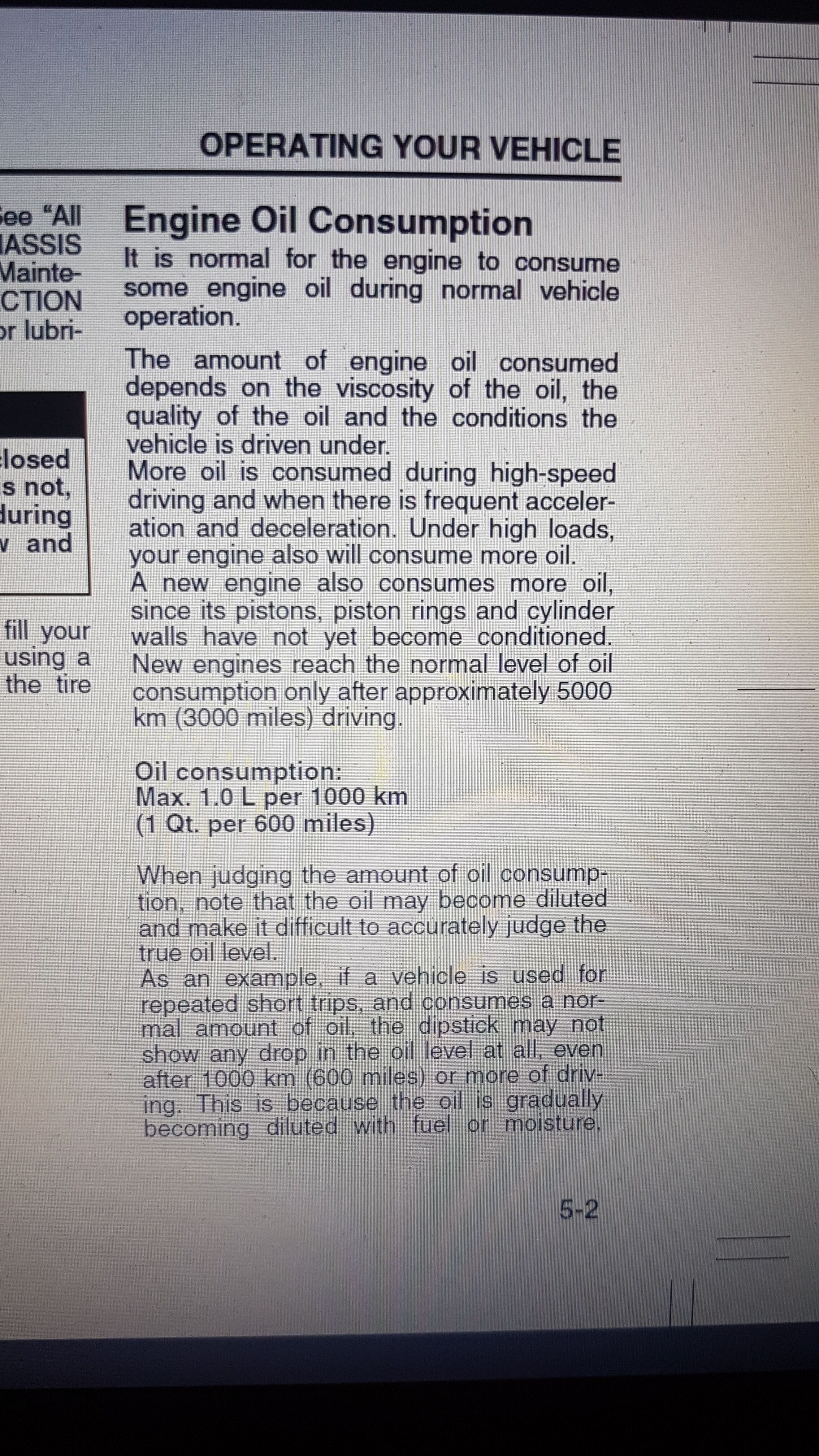

Suzuki jimny K6a engine is turbo charged and it naturally consumes oil however please donot change rings nor do open up the engine for repairs unless you see black smoke or reduced power. It is mentioned in the car's owner manual as well.
Great learning...
Dear very thankful. Great piece of information. I was really worried that why my Jimny was reducing engine oil and still it is. Yesterday I poured 200 ml of oil. I was afraid of checking with local mechanic or opening the engine.
Bro Thanks a lot that was indeed quite helpful. Sorry i am posting this after a long time as i wasn't available but as soon as I saw your reply your praise was due Can I know from where did you source out this manual? It would be kind of you to share with us. Thanks

Bhai indeed this owners manual
Hello everyone here is Jimny's user manual.Suzuki Jimny Owners Manual.pdf (4.1 MB)
