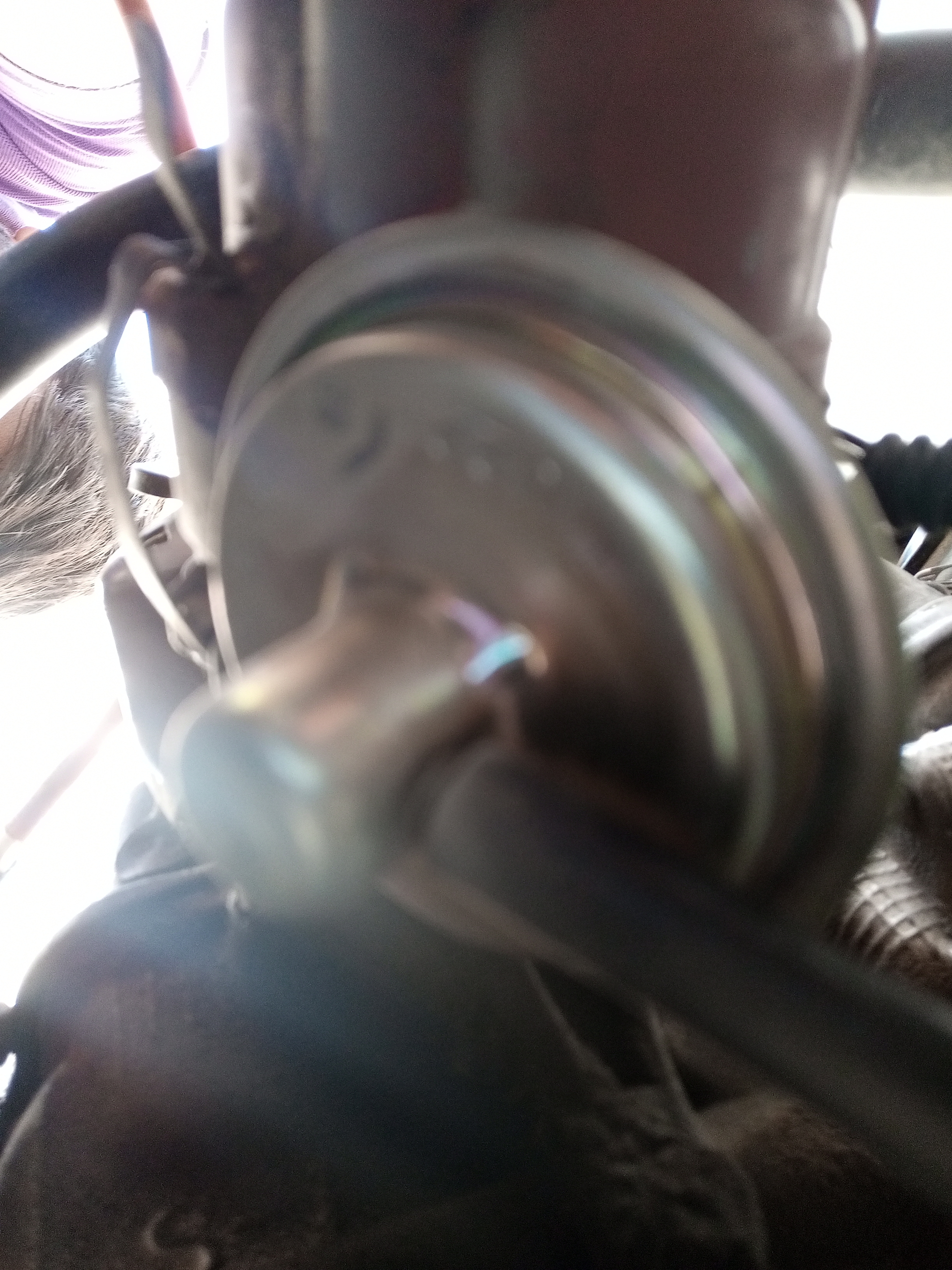

I am currently facing 2 problems:
Problem 1:
Whenever I use AC for longer duration in Khyber and then park the car, Next time it doesn't have enough battery left to start. I checked with multi-meter and found that Cars battery was not charging as per normally on AC load. I suspected alternator first but 2 mechanics said it is ok. Now I suspect that alternator is good but not powerful enough as my Khyber didn't came with AC from factory so I think smaller alternator was fitted.
Problem 2:
My car is giving 6km/l with AC and 8 km/l without AC, which is very bad and not economical considering fuel pricing and where they might be after sometime. everything from engine point-of-view is checked like gap of values, air-gaps, air-fuel mixture etc but still facing the issue. One thing I remembered that my fuel tank was rusty and had specs of rust after cleaning also. I am changing my fuel tank, lines, fuel filter and changing carburetor kit with Japanese one and will notice the fuel average again. Also, kindly suggest best carburetor mechanic in Karachi if it doesn't solves the problem
