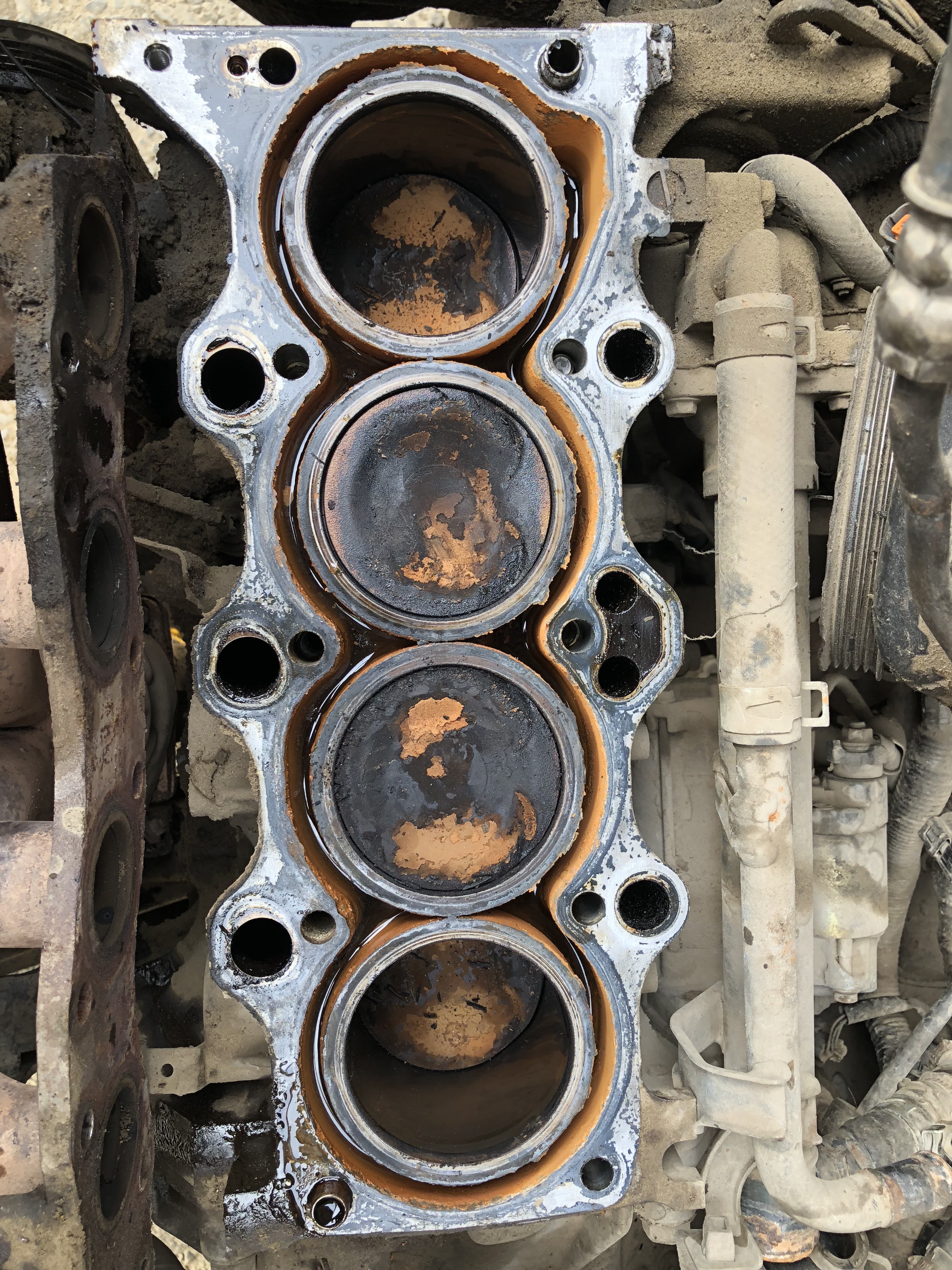

It started missing, low fuel average around 6kms/Ltr. was running fine with a bit of struggle. The second gear lost power sometimes. So got it check everything was fine, the fuel pump, injectors, plugs, coils, throttle body, air filter etc.

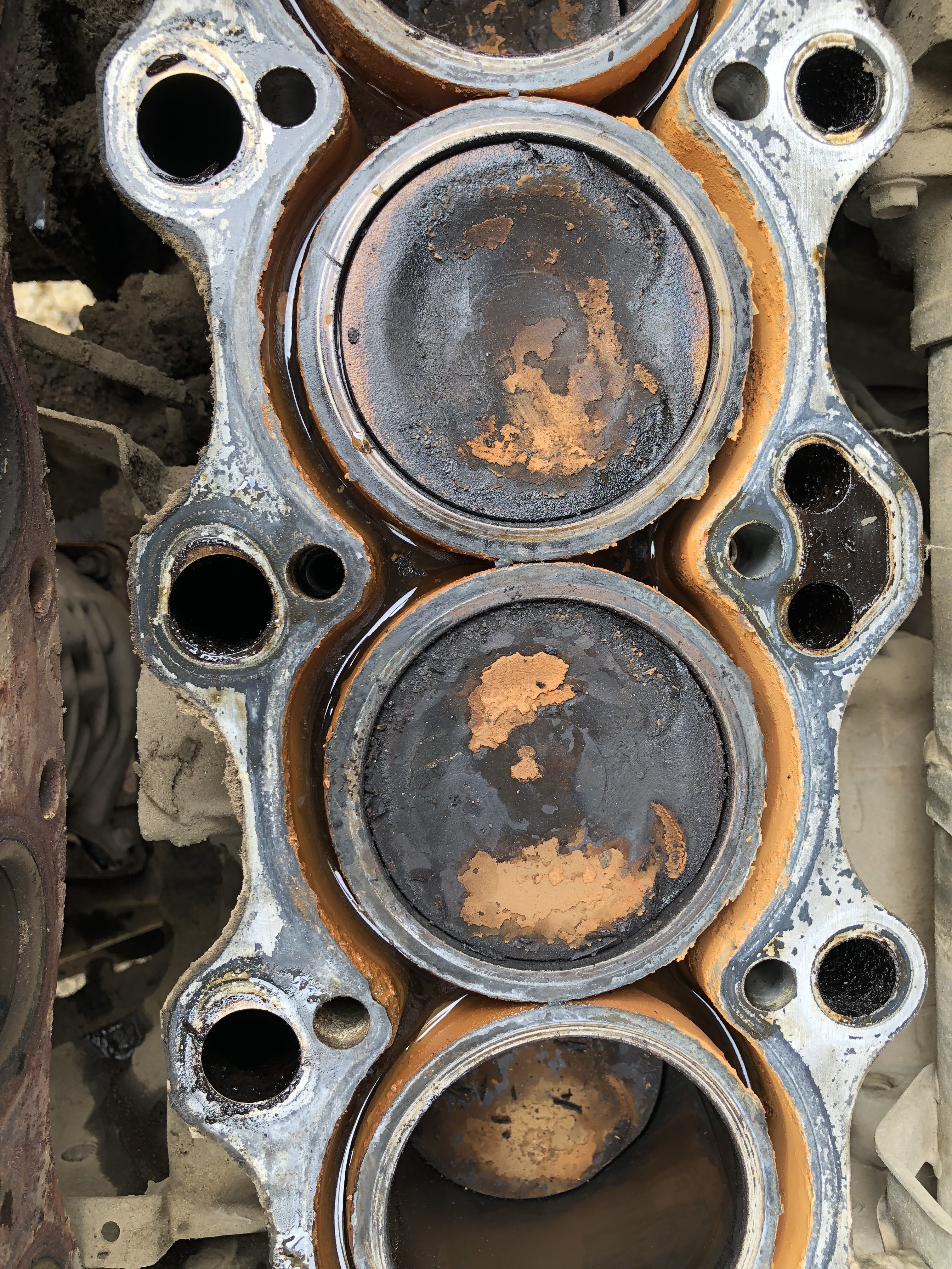

so got the taped cover opened to check things inside so found out the tapped where jammed, so got the head opened after that so the position of the head was not of (I have attached pictures when it was opened) the sides walls were chipping and water was coming inside the chamber. so in all the head had to be repaired or replaced.

It was a perfect swap in all and its running fine now as it was bought new.
Attaching some pictures:
