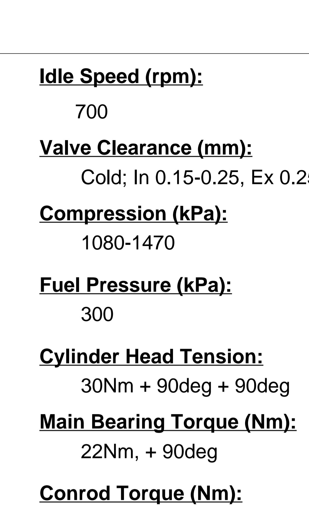

Rest for any engine 170-190psi hot is a compression of 10/10 engine.
And 150-160 psi hot is 8-8.5 kinda engine.
And below it the engine is 4-5 out of 10 pretty worn out. But you are a basic end user, you can not inference any results from compression tests.
Since you have to observe some other important factors too.
If its like 145-144-143-145 then you can say engine is worn out but it doesn't have any problems.
But if differences are greater than 6/7psi it shows there's some problem
