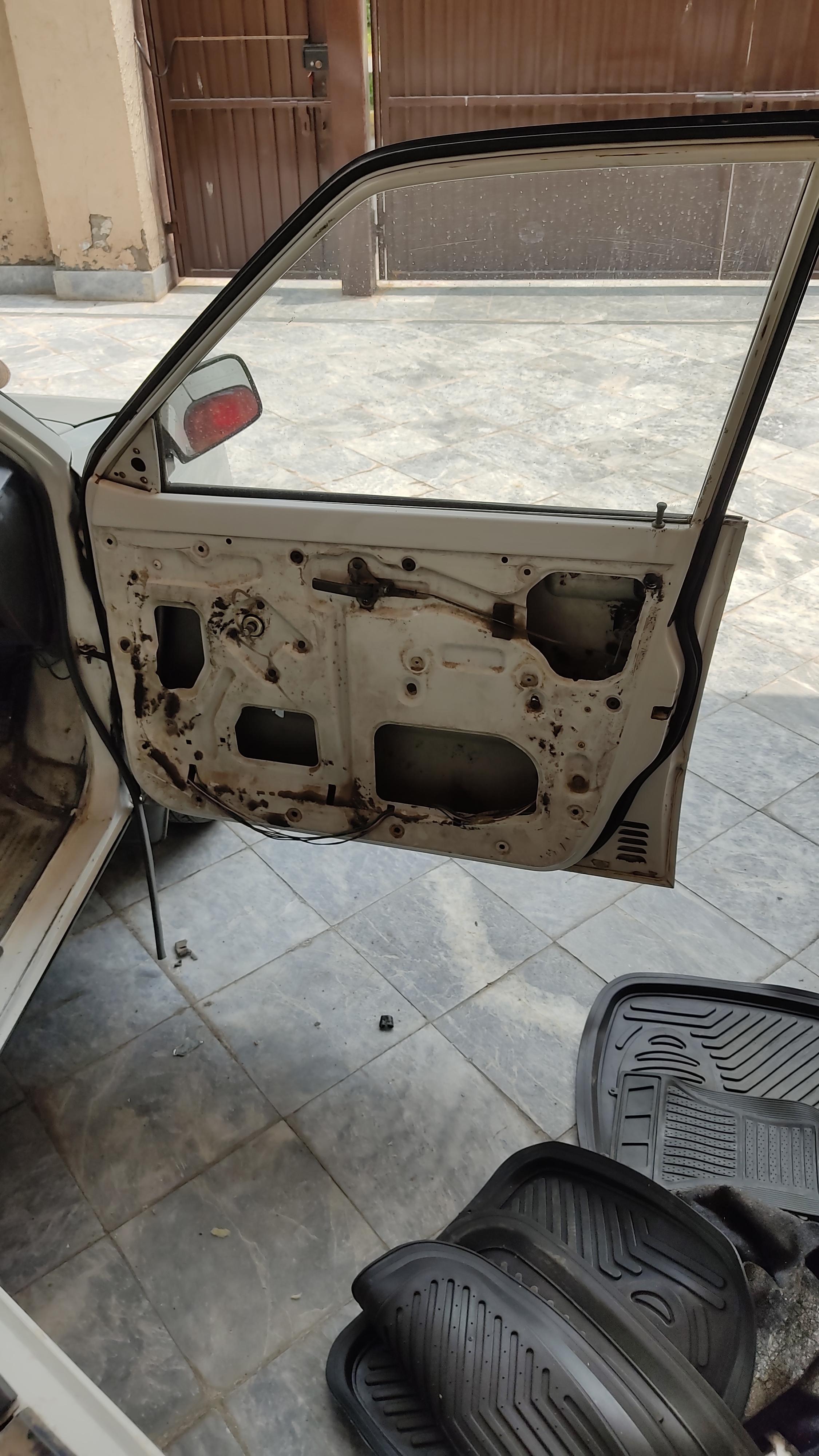

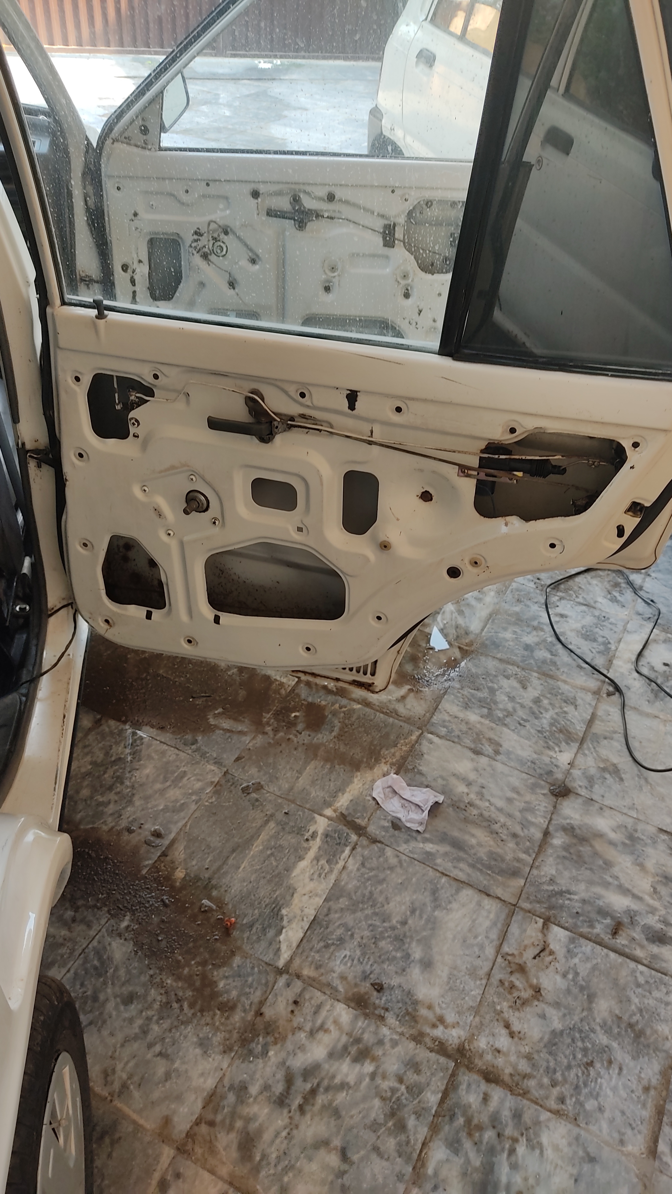

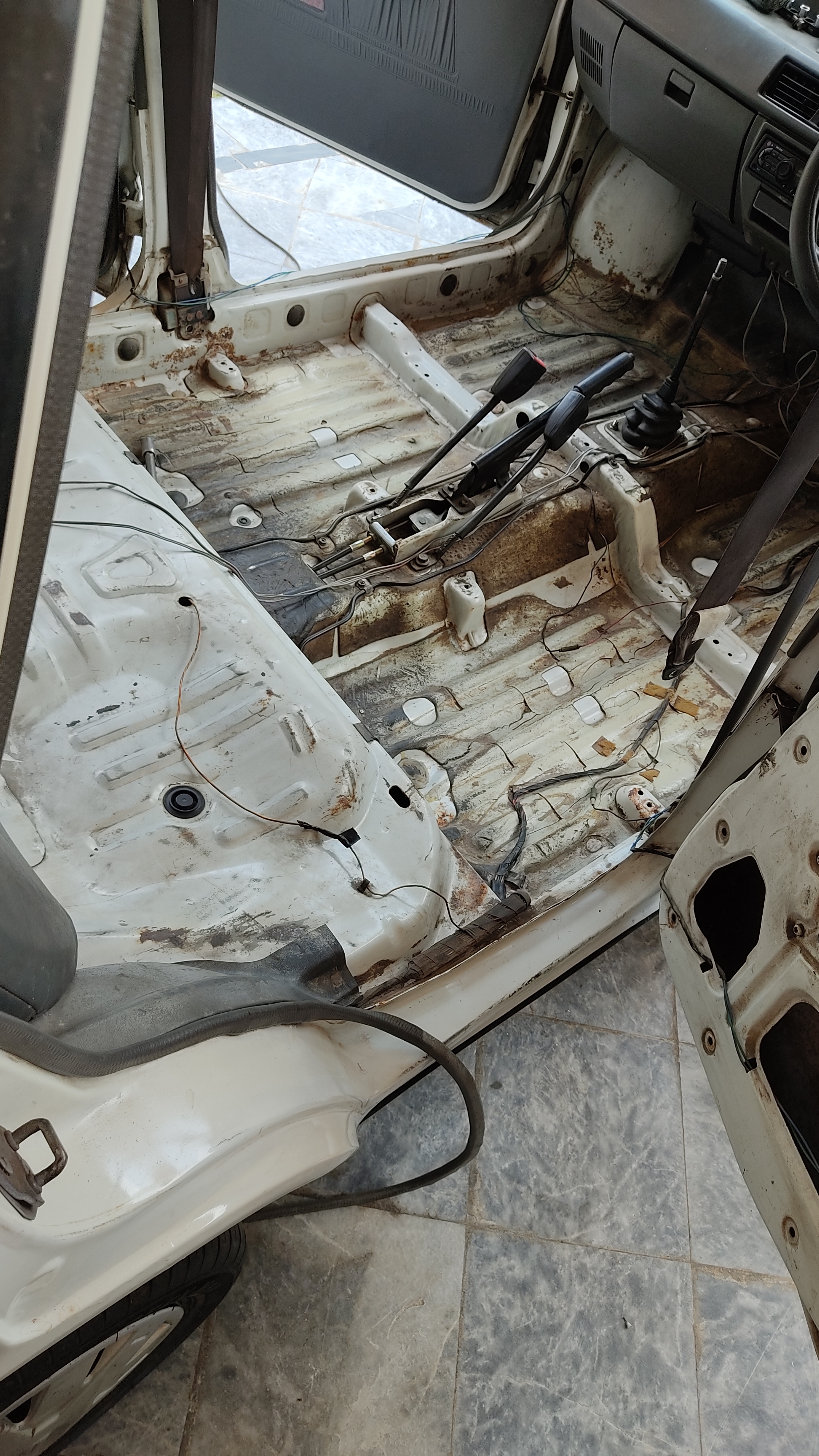

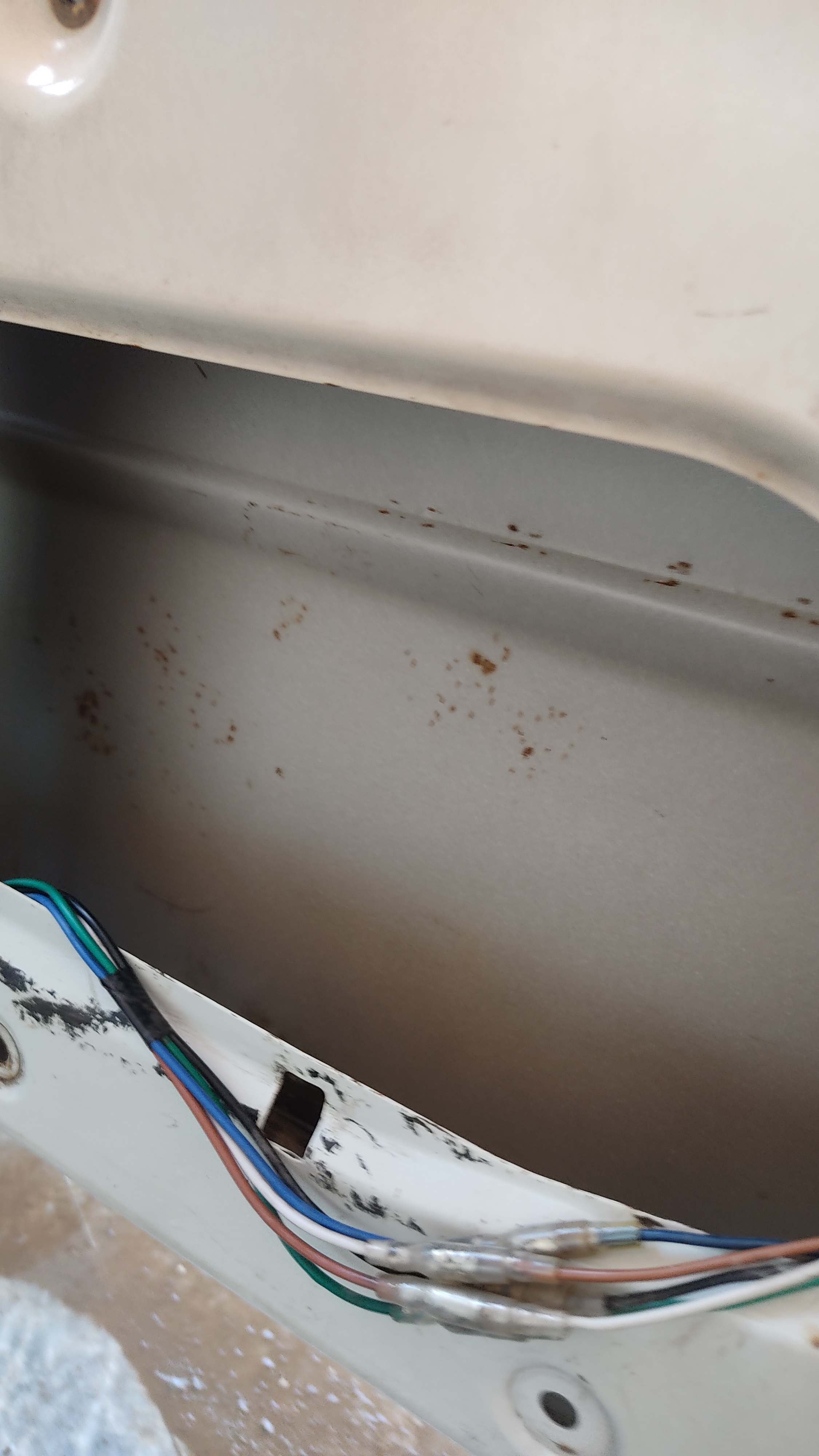

I'm going to try and insulate my 2005 Suzuki Mehran VXR using carpet foam I have read different threads about car insulation so I thought why not do it myself at home I have done research and have measured the car's dimensions , I am thinking of doing the floor, roof, doors and trunk most people say that all the ac cooling in Mehran is mostly lost through the doors.
Below are some measurements I have taken:
Full car insulation = 40sqft.

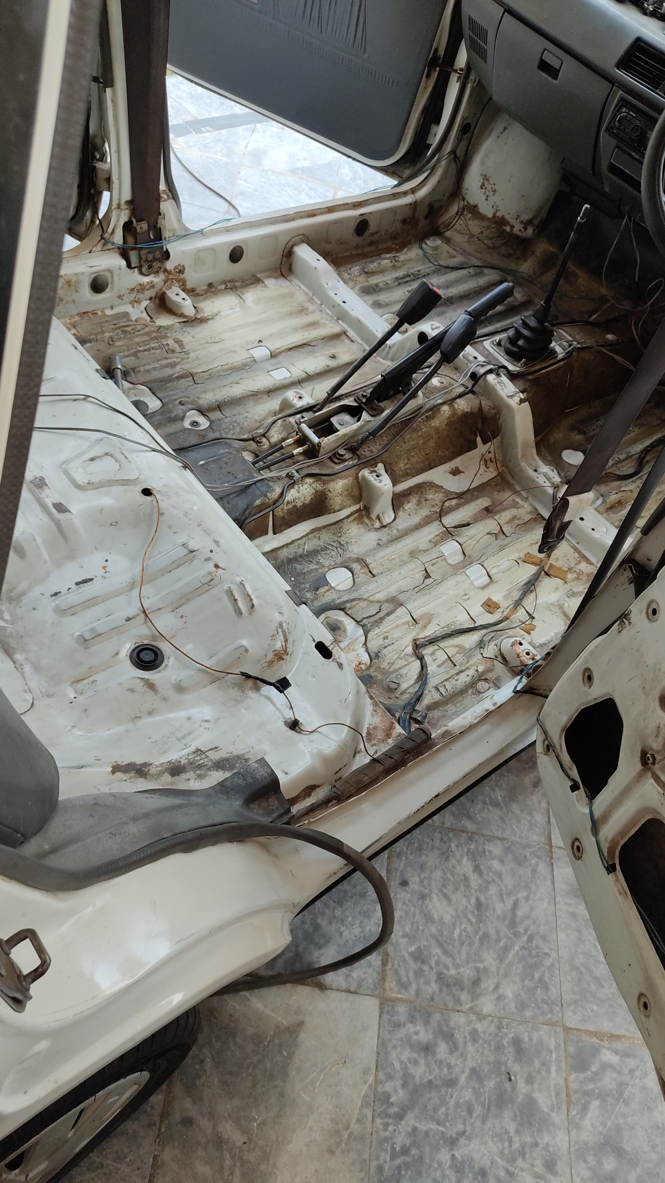

Floors :
Front = 32x28 (x2)
Rear = 26x18 (x2)
Roof = 50x30
Trunk door = 30x9
All the measurements are in inches and are given as (length x width)
Still have to measure the doors, will attach pictures when I begin my work .
The foam I chose is of 10 mm thickness which is available at Rs .20/sqft. From carpet shops.
Going to stick the foam using samad bond or
elephant bond.
Wish me luck
