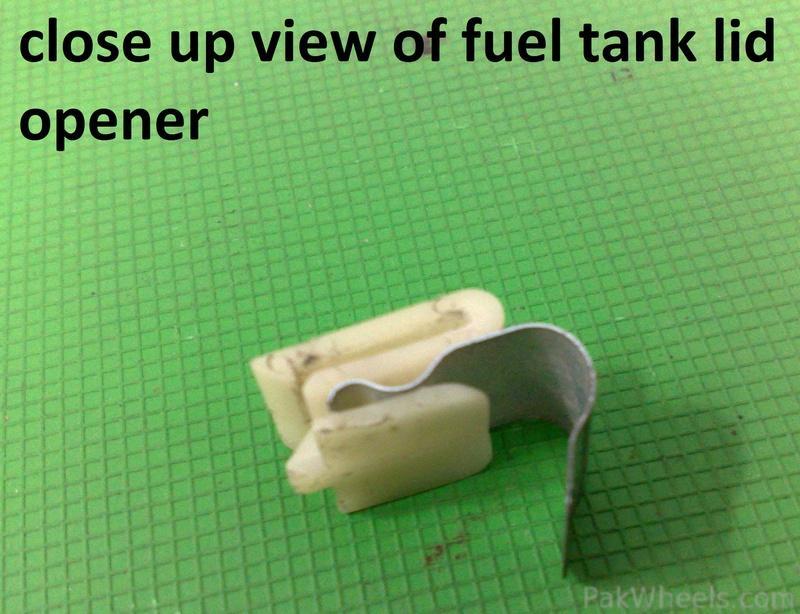

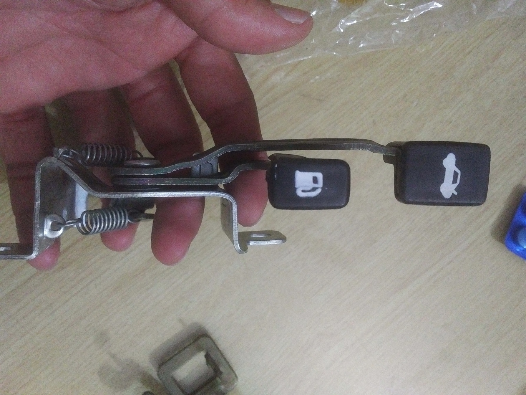

1. Fuel & Diggi Strainer Lever

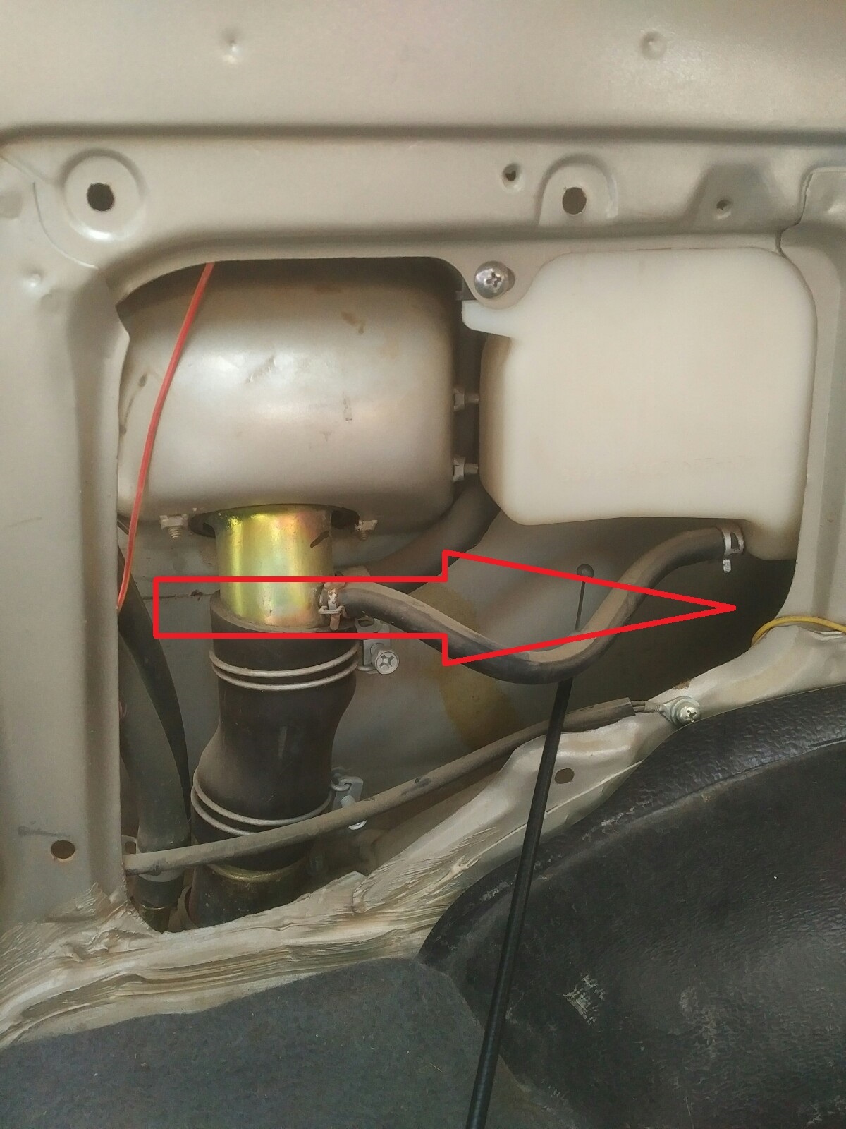

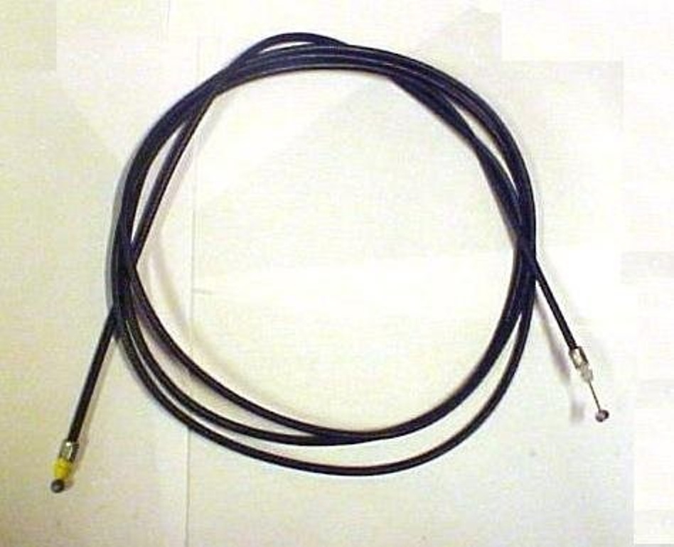

2. Cable for fuel lid

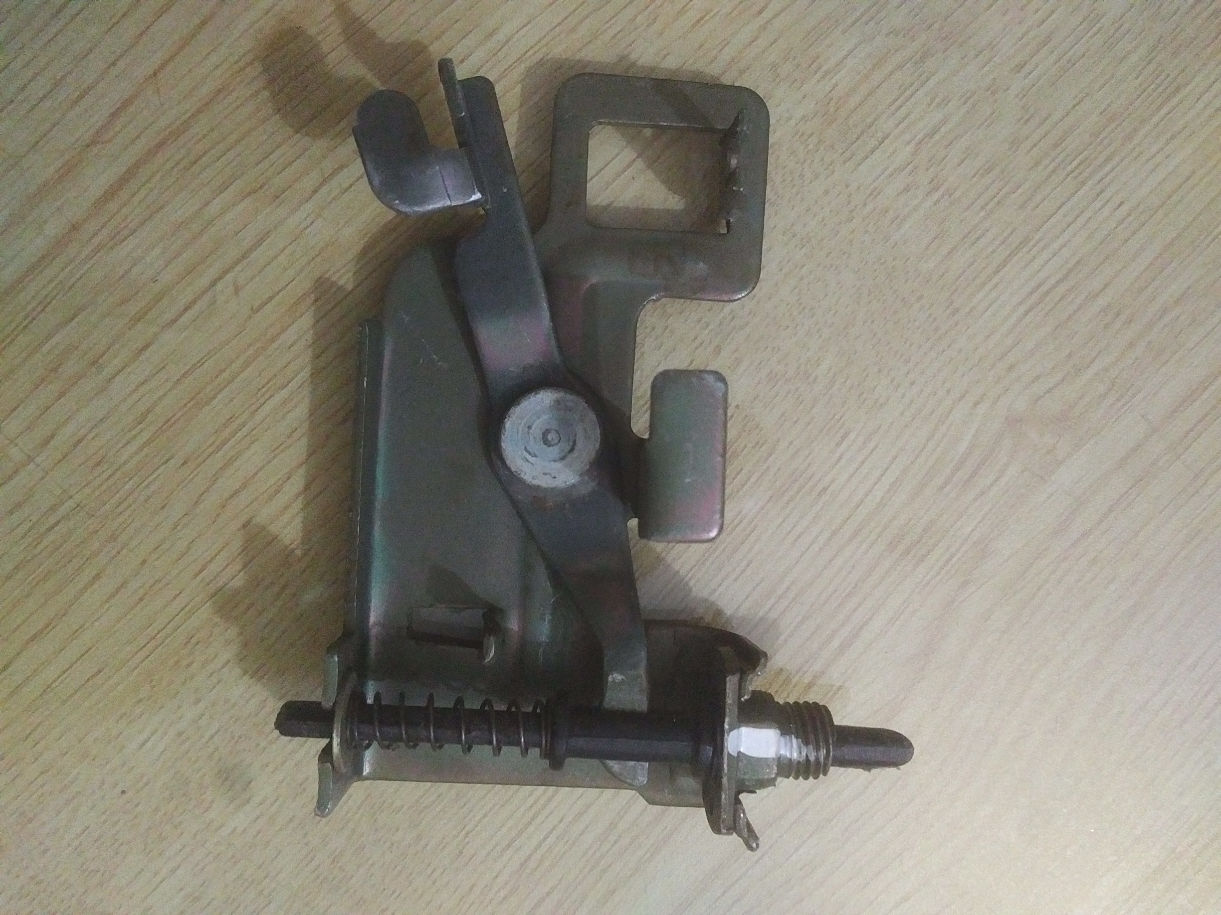

3. Lock mechanism required at fuel filer mechanism

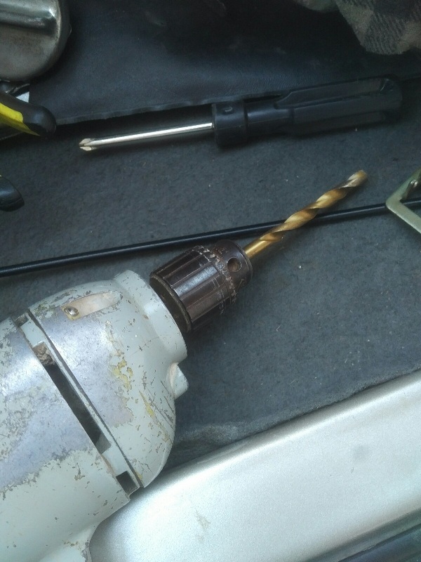

4. Drill machine with steel bit

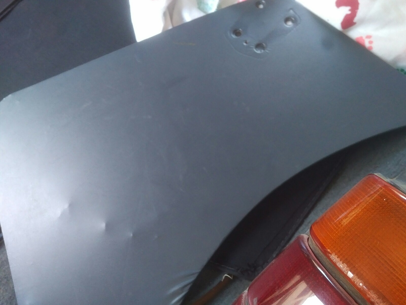

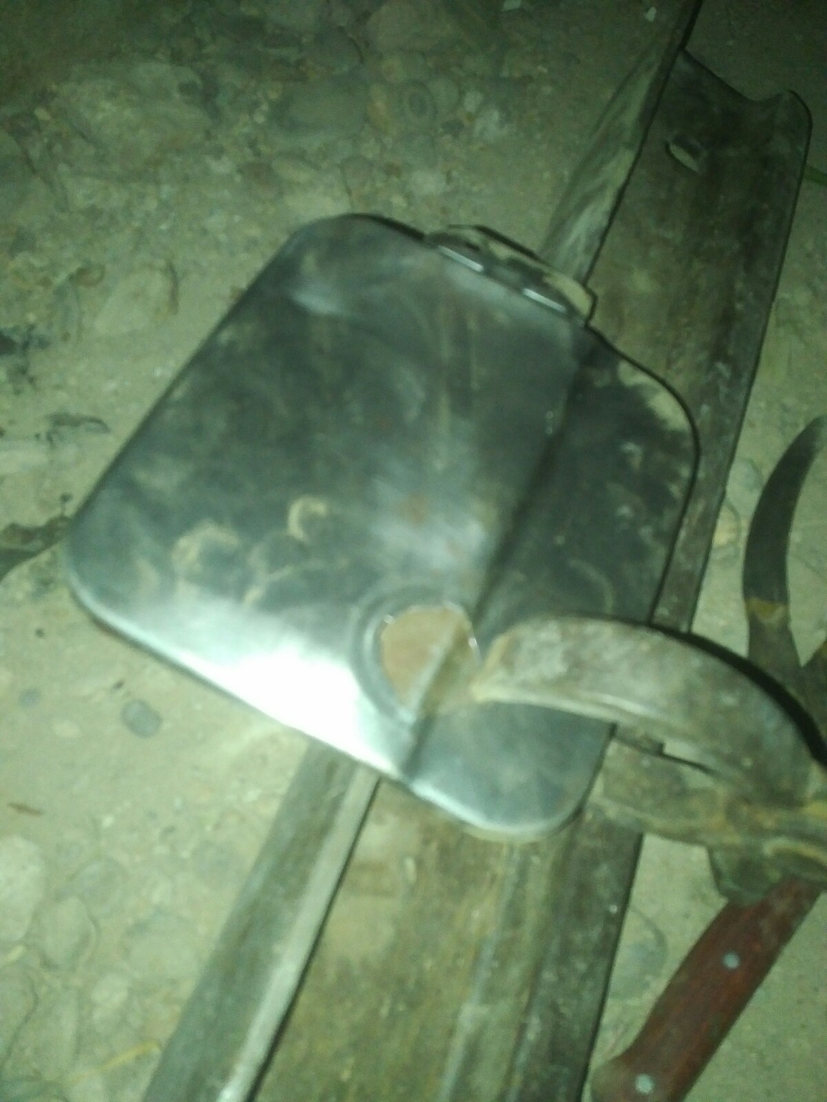

5. New Fuel lid plate (to be used while original will be removed)
Cost:
1. Fuel & Diggi Strainer Lever – Rs.200/-
2. Cable for fuel lid – Rs. 250/-
3. Lock mechanism required at fuel filer mechanism Rs. 200/-
4. Drill machine with steel bit – (already at home)
5. New Fuel lid plate (to be used while original will be removed). Rs. 100/-
All the above parts used were from Suzuki cultus except for fuel lid plate which was mehrans. Pictures are attached in sequence for parts. after that i will post step by step process pics.
