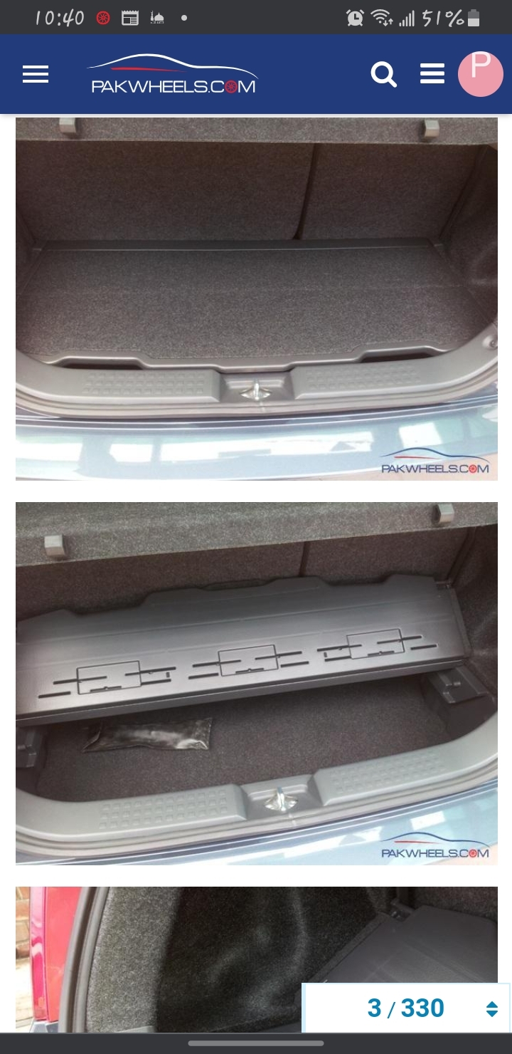

Also @mohsan87 Bhai I would like to take advantage of your knowledge regarding Suzuki swift. I have a 2010 model that did not come with the trunk divider. I was wondering if I could install it in my car somehow. I'm in Karachi currently and would be moving back home to Islamabad soon but I'd rather have this before driving that distance to have a separate compartment for my car maintenance items from the rest of my luggage. Is this doable?
This screenshot is from another thread for reference of what I'm talking about.
I think this divider is available at dealership. I have no idea about the 2010 model whether it have base foundation for this divider or not.

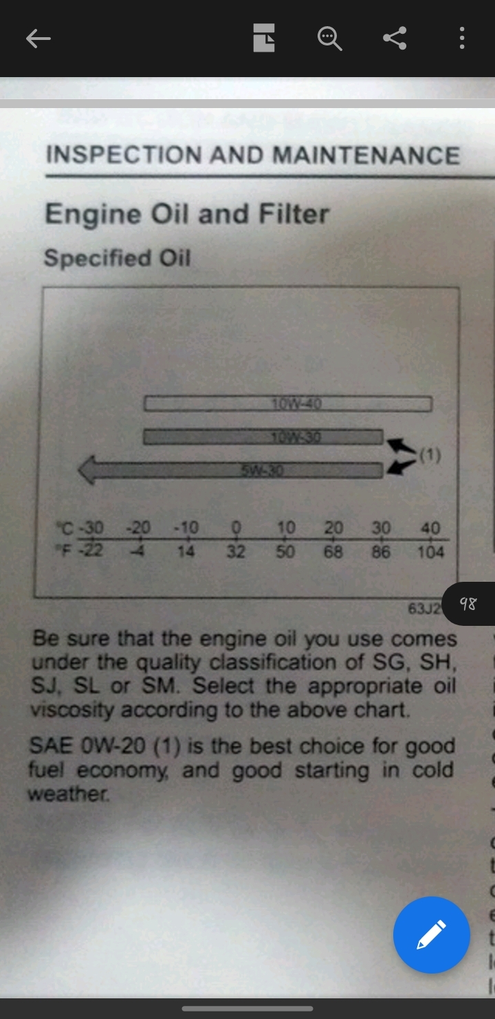

But the manual doesn't mention SN, only SM Can you please explain the difference between the two?

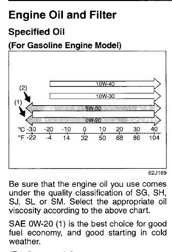

Because internationally swift came in 2004 and has 2 decade old engine. Us zamanay main SM tak hi chalta tha. SN started in 2011 and swift was discontinued worldwide in 2011. U can even use sn plus as all are backward compatible and really mean nothing as a benefit to you. SGO is very decent oil and is guaranteed genuine which is kore critical in our market
Do you know Suzuki Pakistan is still selling API SG oils..
SN plus is the latest and backward compatible.
SM, SN, SP all are good and meet the requirement of swift
globally for swift, last owner manuals printed were in year 2010, later on this gen discontinued, at that time, api SM was the latest, that's why owner manual mentions SM, not the SN, and SN, SN Plus, SP, all are backward compatible, you can use allregarding grades, 0w20 and 5w30 are recommended on top priority, paksuzuki also recommends both grades for swift, 0w20 and 5w30 both are available in 4L packs at dealerships

20w50 is not recommended for swift, but If you already using it, downgrade to lower viscosity is not good at this stage.
What grades of mobil oil are recommended for swift and need to know that are led lights are plug n play
5w30/5w40 are ideal

You Must Use 5W-30 instead of 10W-40 and you can also change @4000
