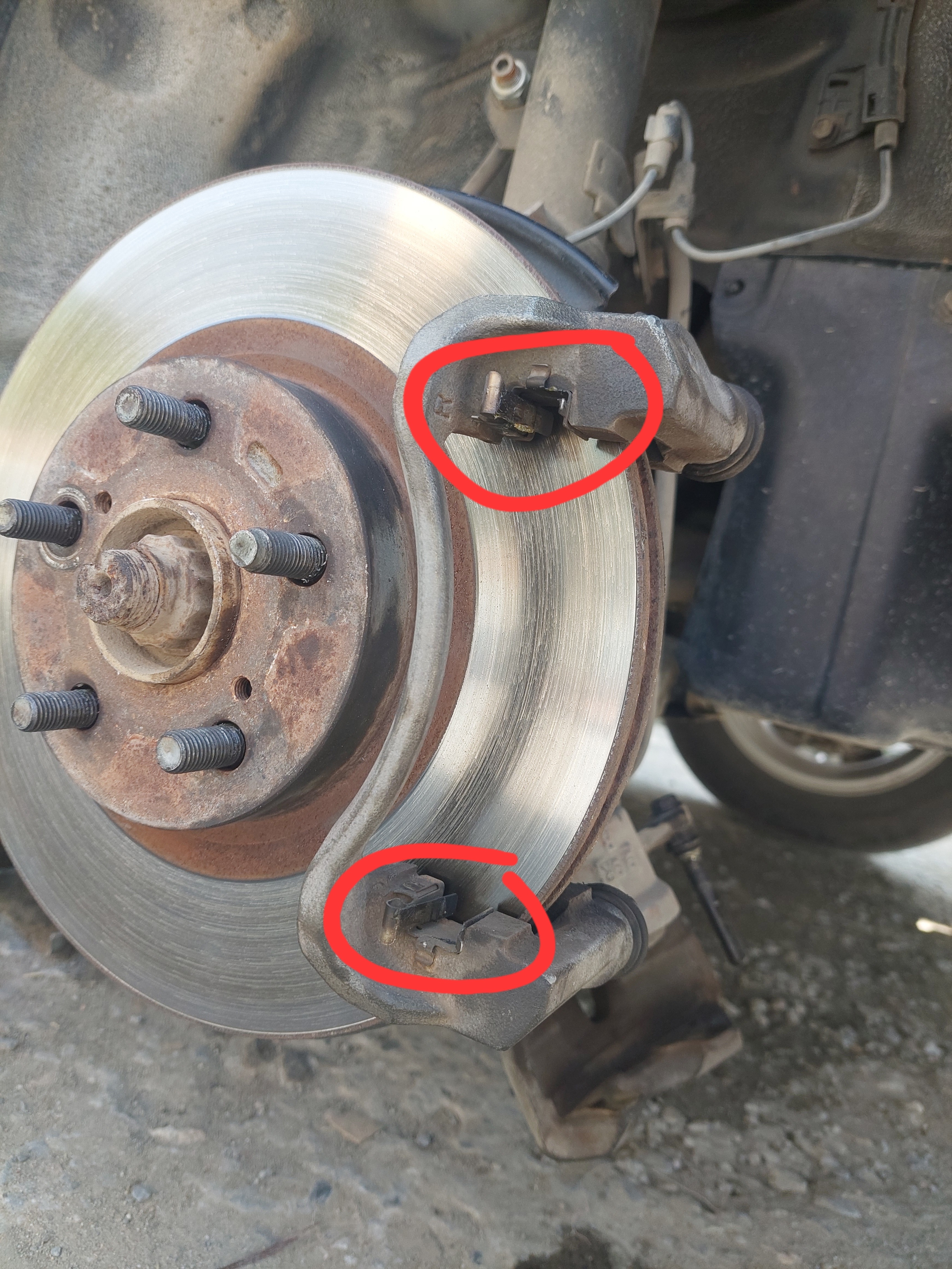

Did your mechanic install new anti rattle clips on the pad carrier?
Are you talking about these caliper clips or the steel sheet that goes on the backside of pads?

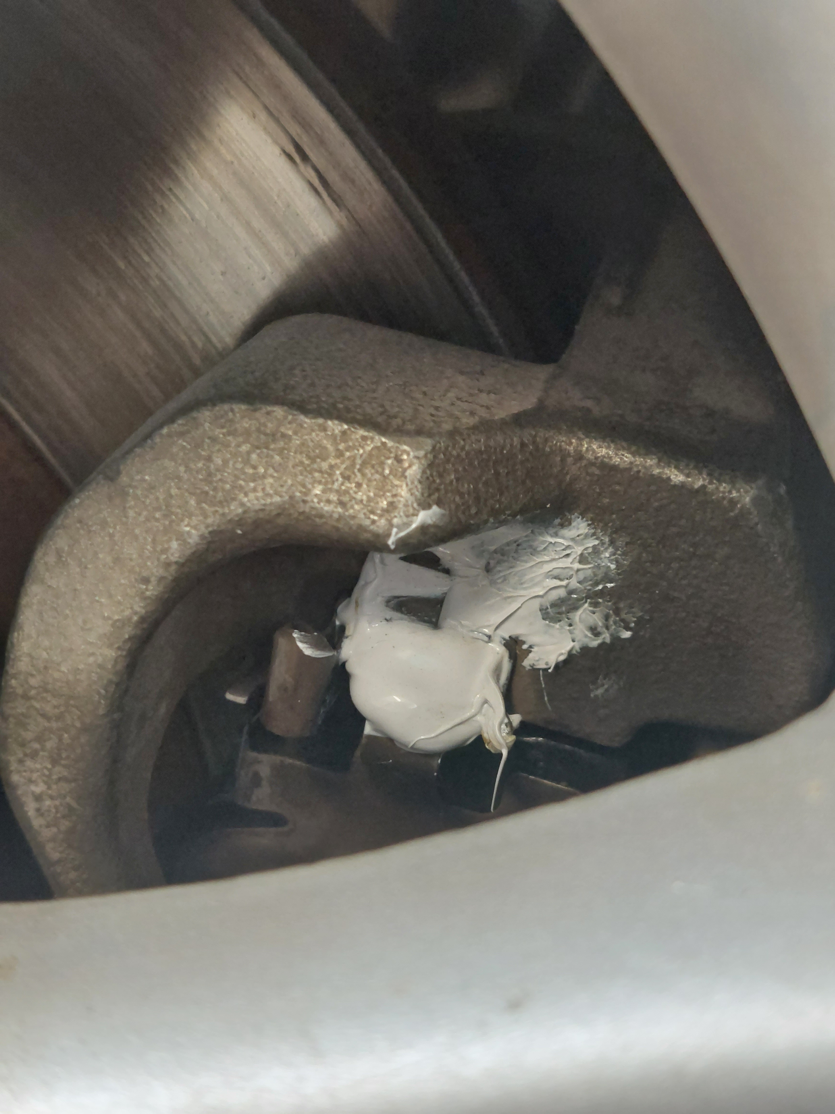

I took it back to the mechanic today and the Tukk Tukk noise was coming from the driver's side front wheels.
He applied a lot of this "Silicon Adhesive Sealant" and the noise disappeared (at least for today).
God forbid if the noise comes back, I guess I have to find new Kabli caliper pins in the used market.
Now, one wheel has silicon sealant while other three are on grease
