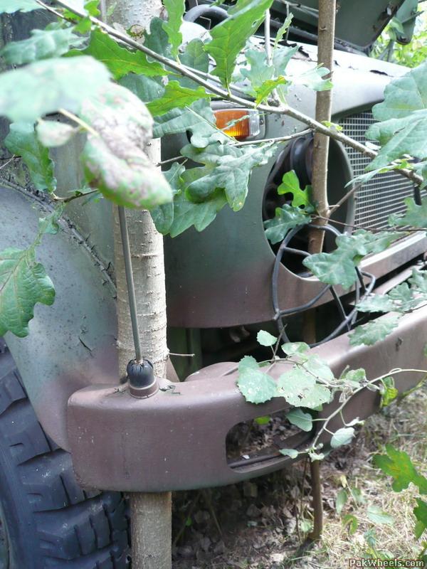

thx brother, it was realy a pain in the ----- to find original parts as market is loaded with indian parts, even Pak army dont put original parts in thier vehicles mostly.
thanks God now the parts hunt is over. I have got according to the list.
1-Fuel pump is overhauled with replacement of plungers, delivery valves (all original).
2-Injectors have been replaced with new one.
3-fuel tank serviced.
4-rediator serviced.
5-brake drum polished and brake shoe purchased.
6-engine overhaul kit, ring, piston, and a list of parts for engine overhaul purchased.
7-hand brake cable purchased.
8-differential master cylender overhaul kit purchased.
9-master cylender servised.
Everything is ready and just have to assemble in couple of days.
Waiting to hear the sound of engine and there i go off road Insha Allah.
Believe me when i started the project i didnt have the source where to buy parts? how much these will cost? where i will find mechanic of Mog? what should be the budget? but by the grace of God now everything is sorted out smoothly and accordingly as i was wanting. The parts list was longer than my monthly grociery list.
thats why is purely a punga and nothing else.
