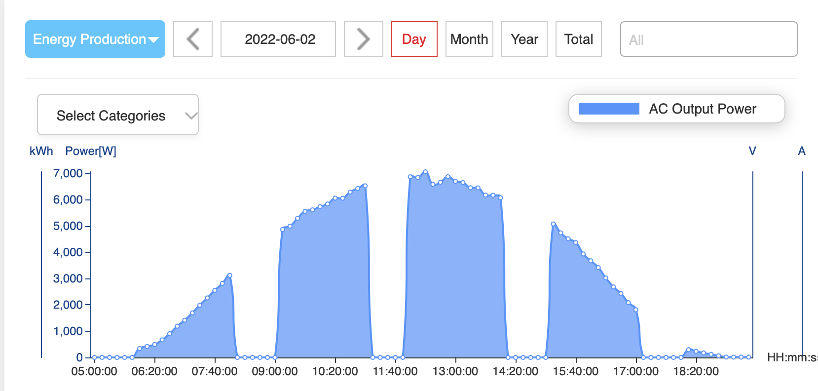

Same bro. It's always good to cross reference because my ac keeps running at 10-11 amps even if I set it to 29. Room temp comes down to 27 but ac keeps taking 10 Amps even when I've set it to 29. In evening it goes down considerably.
