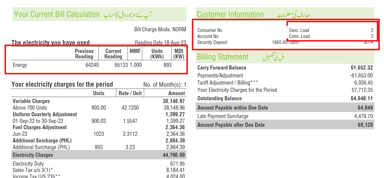

Typical household bill these days is 50000 @ 8 months in summer and 10000 @ 4 months in winter for Karachi weather. So total = 440000
In 03 years your investment will pay back in full and the remaining 12 years are a bonus. Moreover you will be serving the country by providing cheap electriity to Wapda and also helping to end load shedding.
