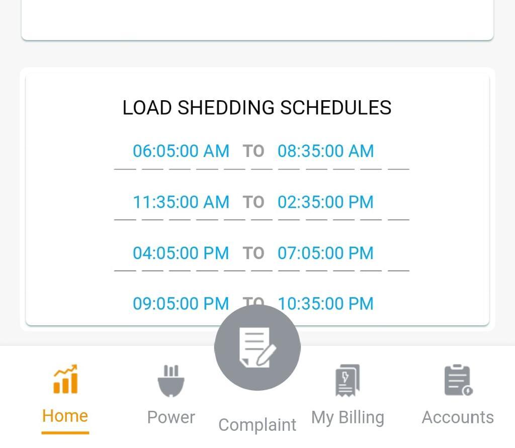

If budget is an issue than you can use truck batteries but they will die in 12-18 months while tubular too will only last 2-3 years unless you don't use heavy loads while power is out.
In your case you need lithium battery. Both truck and tubular will die sooner than their normal life because they won't get enough time to get charged before power goes out again. They would be cycling at low depth every day.
if a 5KW system is installed is it possible to use the washing machine a conventional Dawlence twin tub. in day light morning hours.
sirs this is schedule of load shedding, @saqibhassan95

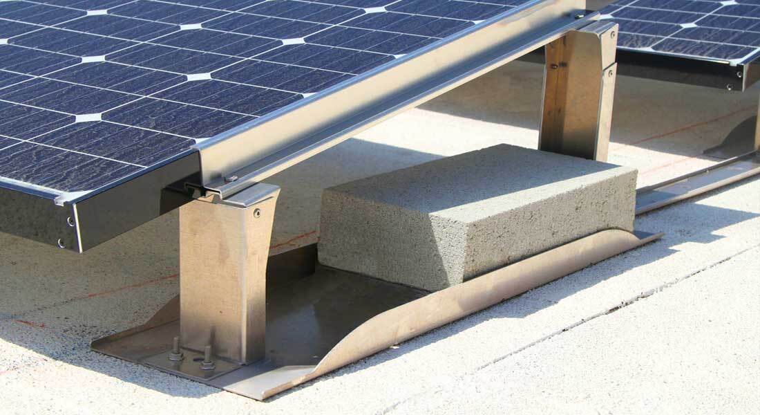

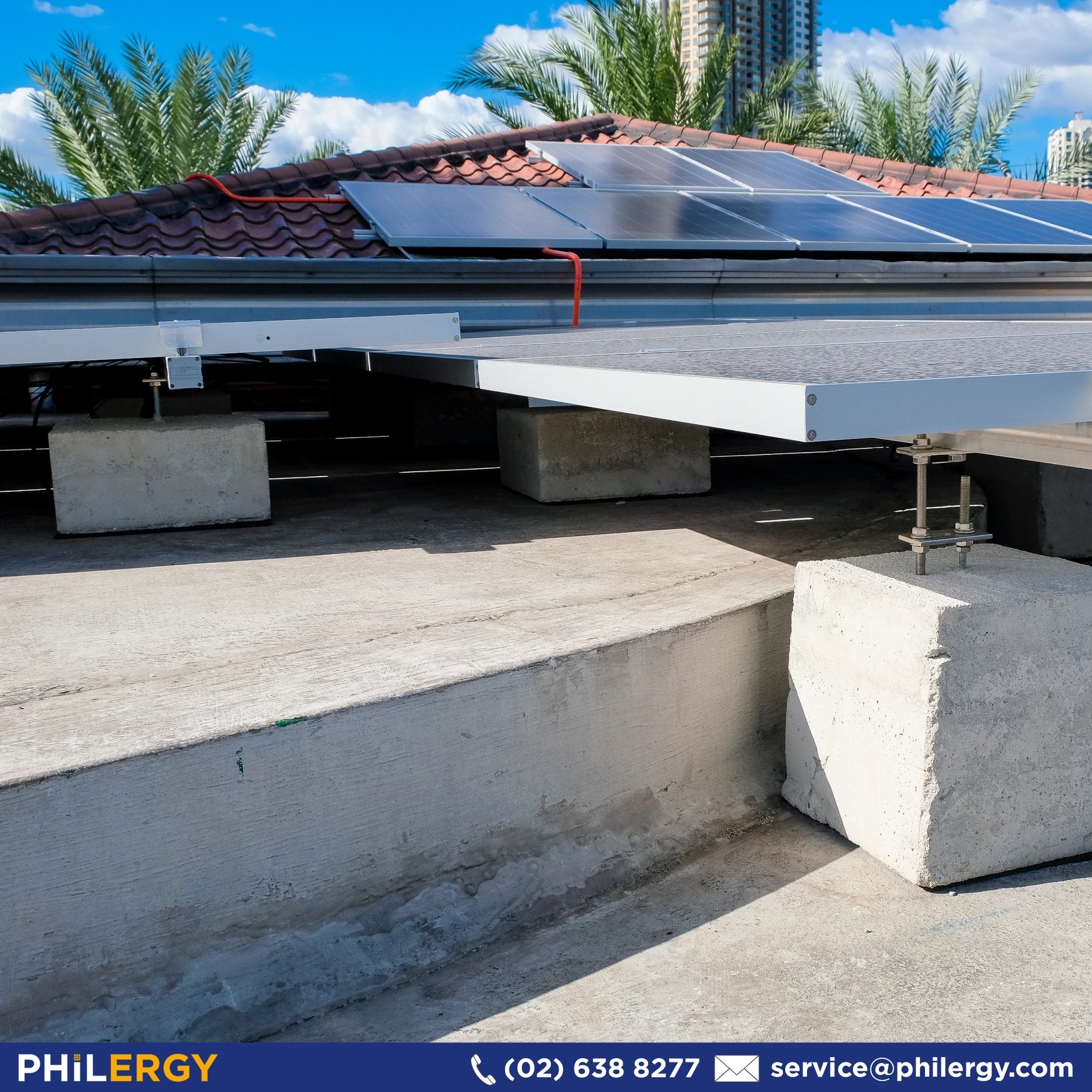

Is anyone here familiar with concrete blocks as ballast to secure solar panels? I don't mean pouring concrete on site and drilling holes on roof. I mean just using large concrete blocks and mounting structure on those blocks? Its common in other countries but never seen it in Pakistan. To me it seems like that approach is more economical and avoids damaging the roof?
sir such concrete blocks can be purchased from different vendors
https://banumukhtar.com/concrete-blocks-2/
https://envicrete.com/#

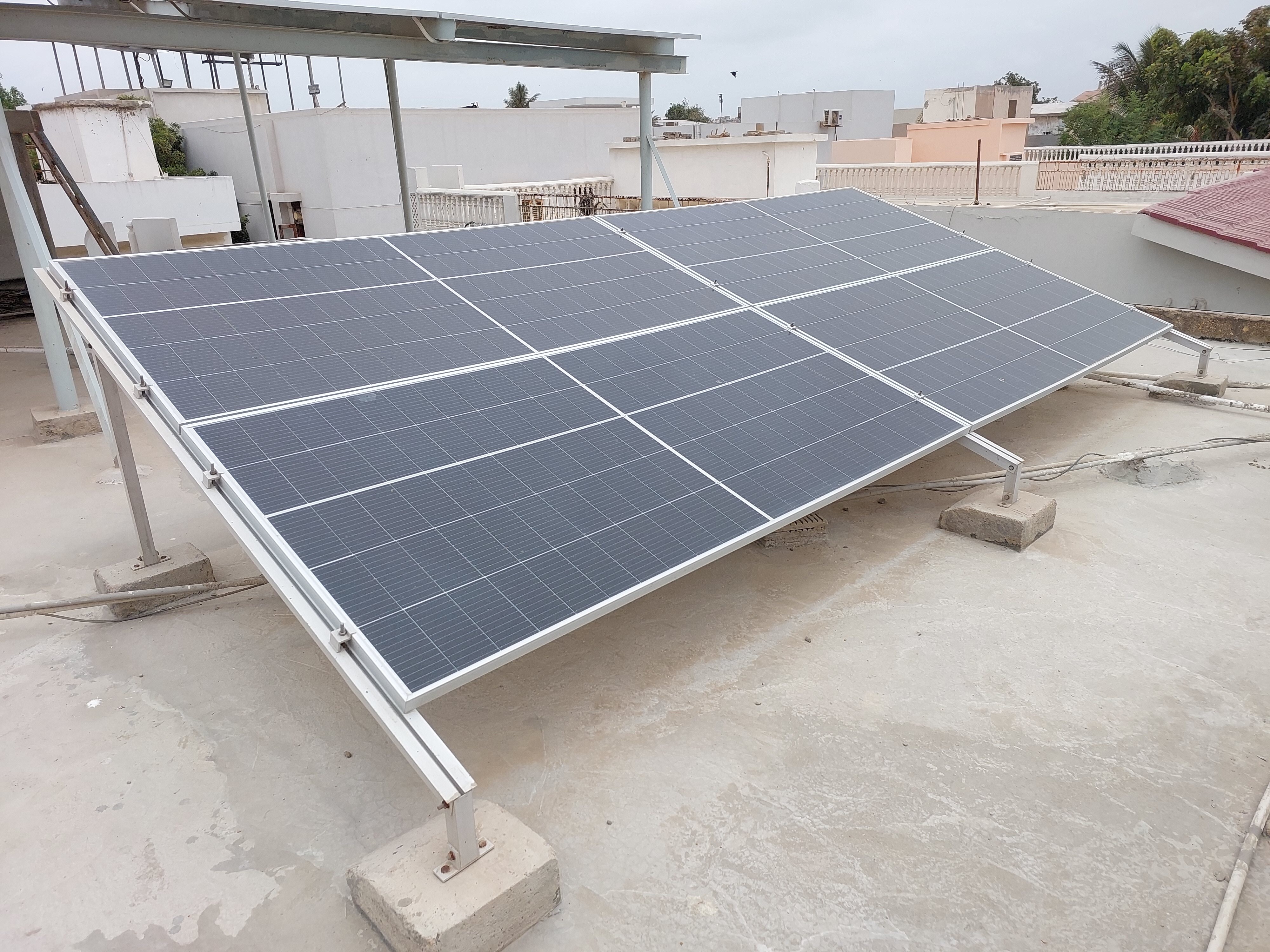

For roof mounted panels, yes one can use bricks instead of drilling directly onto the roof.
Sample pic attached.
Do you know if the blocks are just placed on the roof or glued/cemeted to the roof?

They were just placed on the roof later they got partially cemented as I added a lawyer of cement / crush to the roof for waterproofing.
Forces of nature are too strong. If you follow this approach I'll suggest to use concrete bonding agent like sika latex to attach them with roof. Even if you go for drilling and building concrete pad on site, it'll provide strong adhesion to increase strength of structure.
