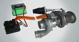

There are actually two distinct types of electric boosting devices for engines that have emerged in the past several years.
The first type that is already in use by Volkswagen Group and Mercedes-Benz is an e-booster. This is essentially just the compressor side of the turbo paired with an electric motor. The size of the compressor is inherently limited by the size of the motor required to spin it at high speeds and e-boosters are used in a sequential combination with exhaust driven turbos. The e-booster gives quick low-end response from the motor and then as pressure builds, the larger turbo takes over to provide maximum boost.
