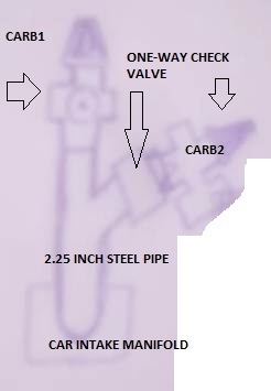

Now - keeping everything I've said above about the sizes of the throttle openings on the carb and the restrictions placed on the air filter housing - The following is what I thought of and want your opinion on.
a PZ30 carb, from what I've seen online, has a 30mm outlet through which the engine sucks in air and fuel in the correct stoichiometric ratio. Its roughly the same size as the e13 carb outlets.
Why not connect 2 PZ30 carbs in the following way:
Sorry about the quality of the image, but atleast you get the idea.
PZ30 Carb1 will act as the primary throttle connected to the accelerator cable. PZ30 Carb2 is connected to the same 2.25inch intake pipe via a one-way spring check valve. It will not be linked to the accelerator cable. It's throttle cylinder will be removed and jets re-fitted if necessary. The check-valve will open up and let in more air and fuel via Carb2 when you accelerate the car.
Considering the e13's own carb has 30mm-ish openings, this should work without compromising the engine right?
I know some of you will think, why not just properly tune the e13's own carb - less hassle and what not. I've tried that countless times - the max mileage it gives is 11km/l. If i can get this to work - and if properly tuned both carbs bump up the mileage to even 15-18 km/l, I'd be a happy man.
