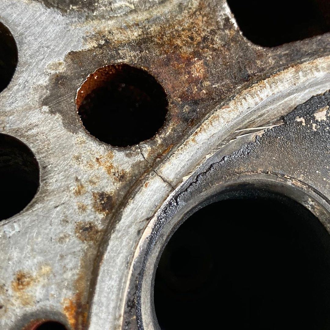

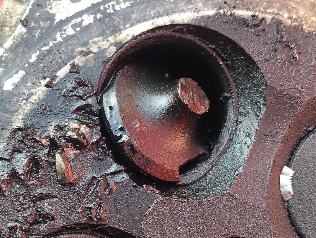

This is what happens when
Thermostat valve is removed.
Tap water is used,
Wrong lube oil grade is used
fans are running direct
and PCV valve is blocked
and road side ustaad is considered GAWD.
If you can read this forum and still believe that such ustaads are better then your membership to this portal is only waste of time
