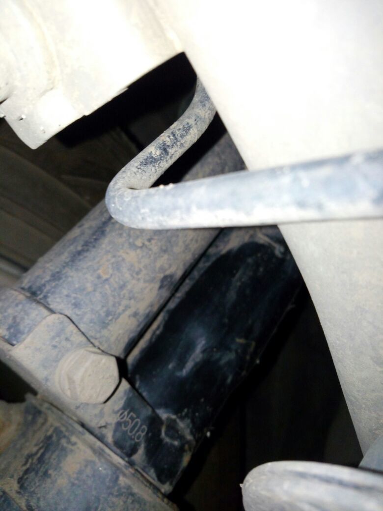

To start, few months ago i got Kabli rear shocks installed. Though i went to get new shocks as there is not much price difference in new and kabli, and i personally never had good experience with Kabli parts but mechanic was unfortunately able to cast spell on me and lure me into buying kabli shocks. At bilal gunj new story started. Shopkeeper showed me two type of shocks, the normal ones and the other ones that i bought, bit heavy with bottle on side and shocks really looked something. Firstly i need to know what is the purpose of side bottle and secondly they are very very stiff, is there any way to soften them? @xulifqar
These are the twin tube shocks installed in vehicle uses for motor sports and they are stiff because to keep the ride smooth on harsh and rough surface.The bottle attached is the fluid reservoir.
Can it be made softer by removing some of the fluid?
