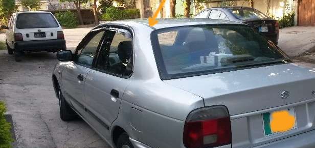

Hello friends,koi bta sakta hai yeh roof moulding set kahan milega ar kitna tak ka?? i am in karachi, picture attached
ye tou after maket lagg jaegi from Waterpump or decoration market kahin se bhi
This isnt after market

exactly.... I saw it on pakwheels auto parts section, price 9000 for set.... i mean seriously?? @saboor73 @abid110
