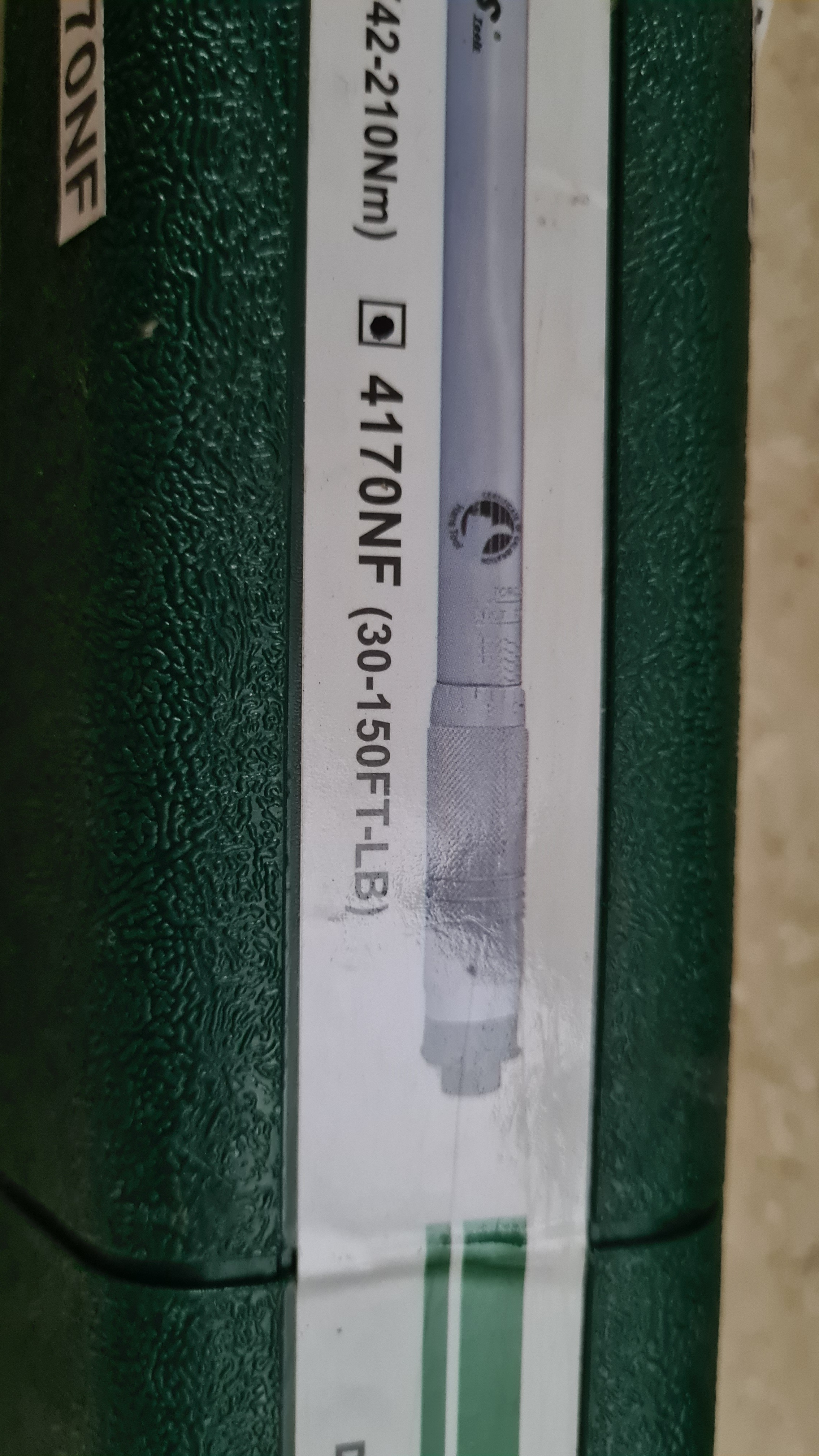

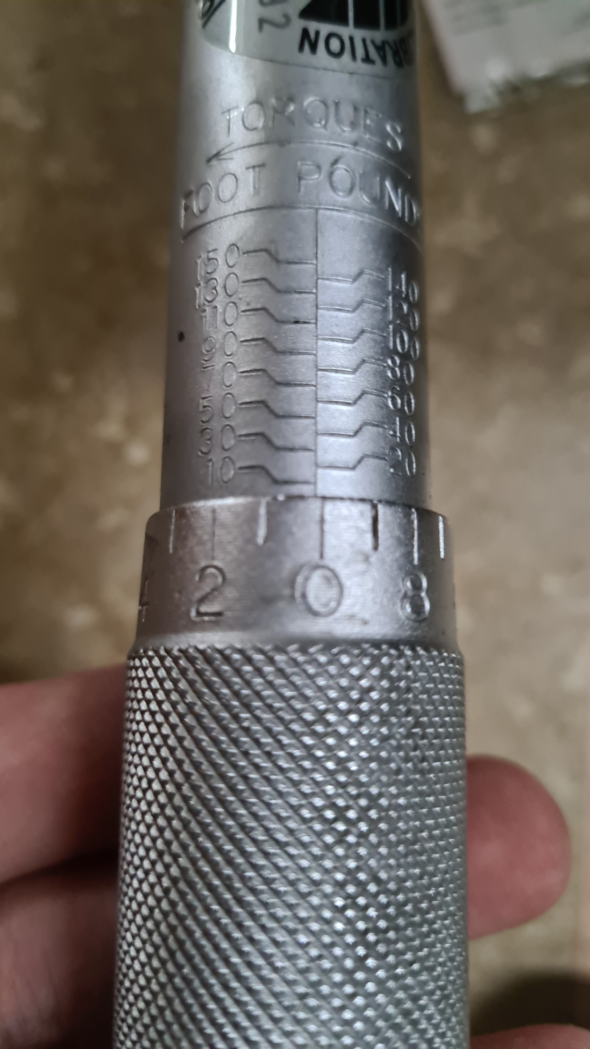

You can buy high quality click type torque wrenches too in Pakistan, they cost a lot of money too - e.g. any decent one will be about 100 USD at minimum no matter if you are in USA or Pakistan.
