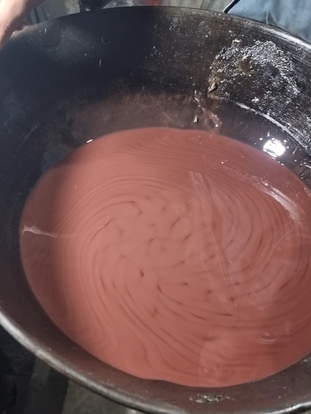

If your cooler in the radiator had failed and it put coolant/water into the gearbox - then kiss it goodbye too - the glue that holds the friction material to the clutches in the transmission is water soluble. - They will delaminate and cause severe shuddering and eventual complete failure.
Its quite easy to rebuild the gearbox too provided if you can find a mechanic who
1 has the tooling
2 is willing to do it
and customer is willing to spend the amount - a rebuild kit for it will cost about close to 1200 with a rebuilt torque converter.
