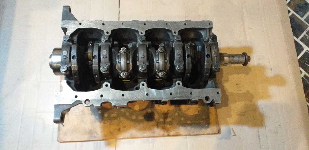

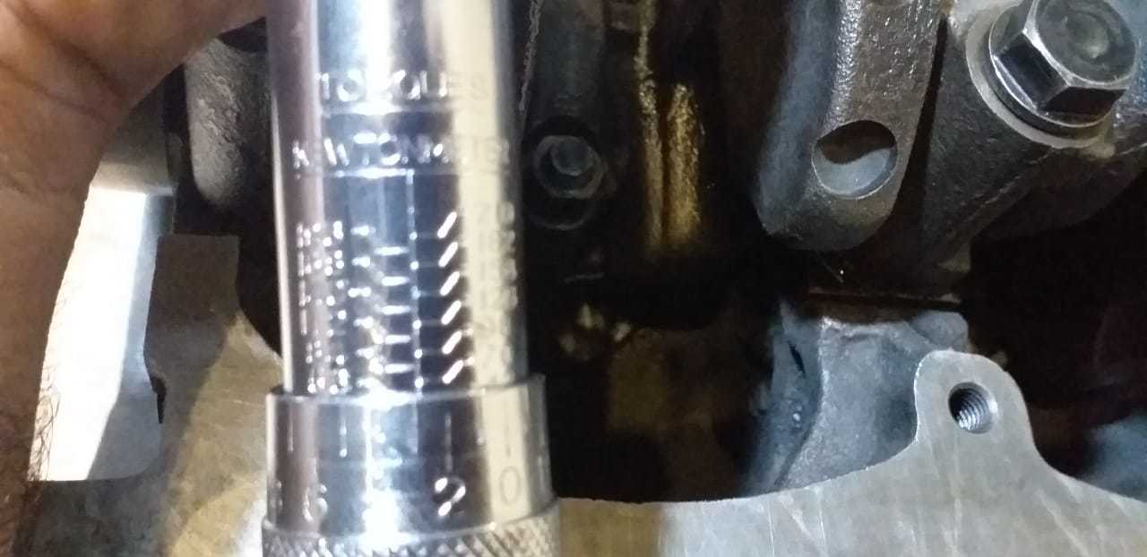

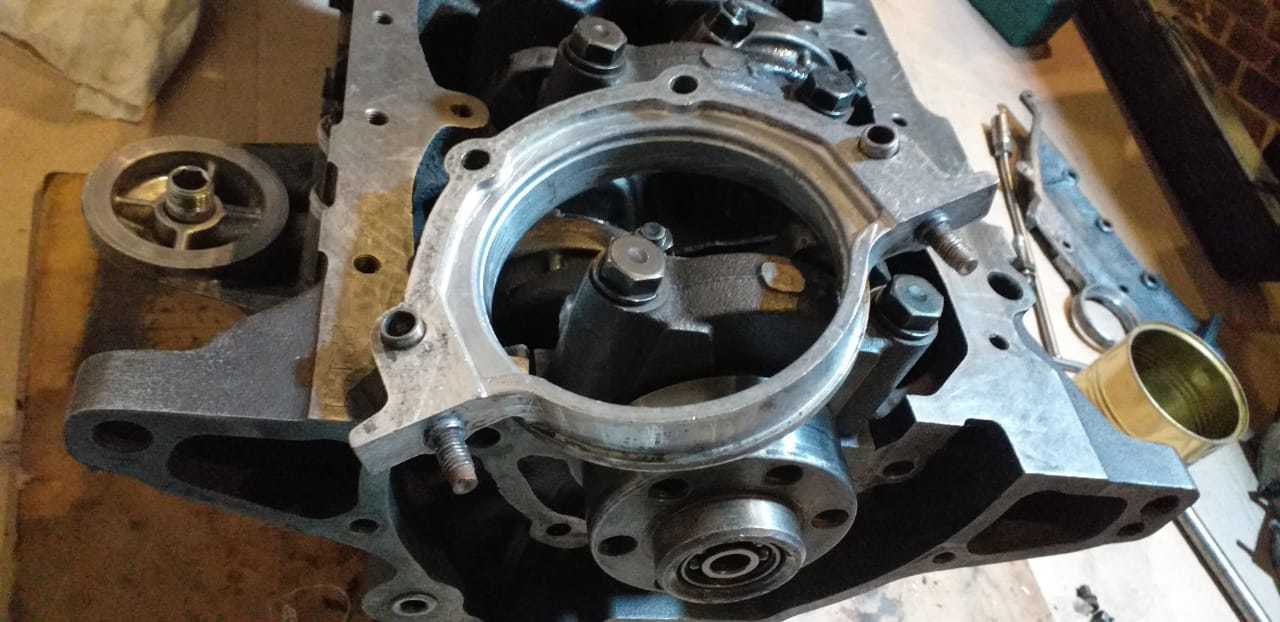

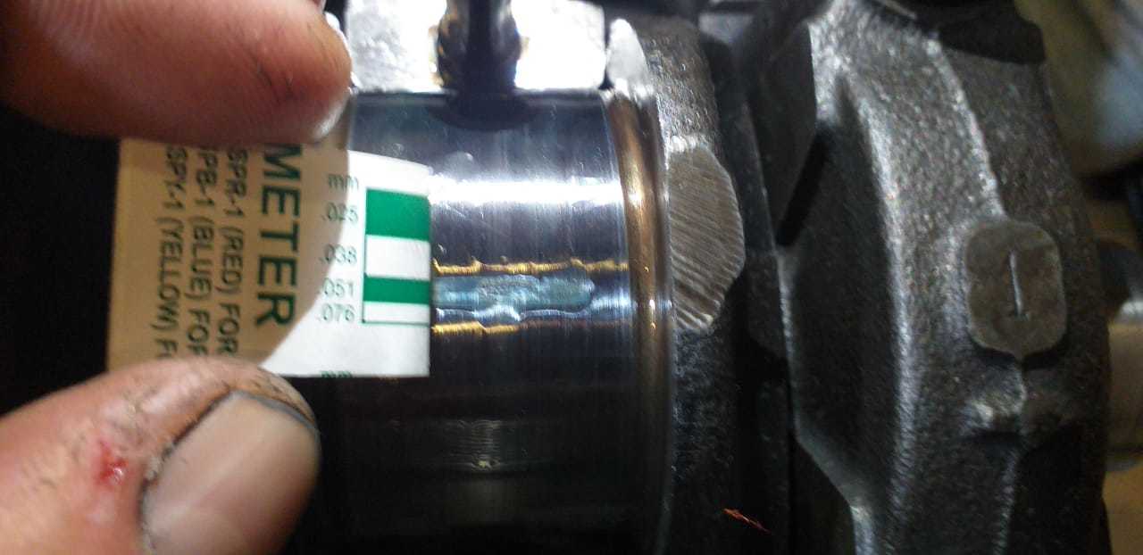

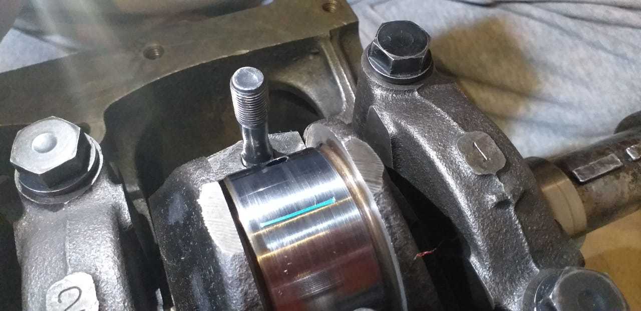

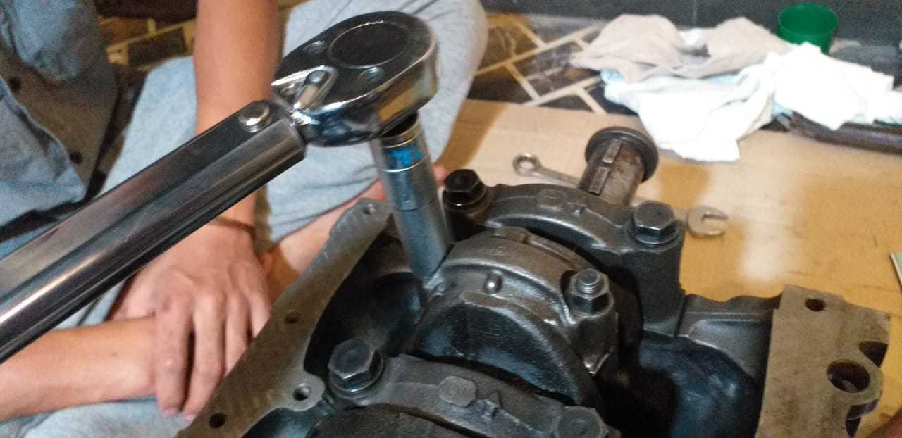

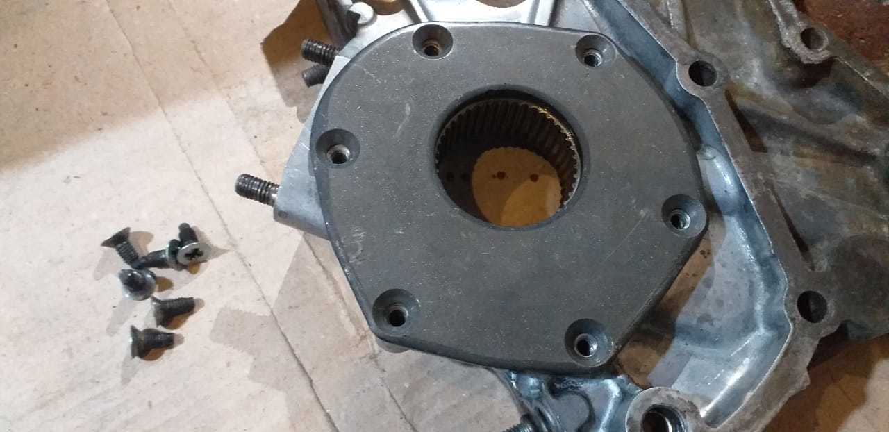

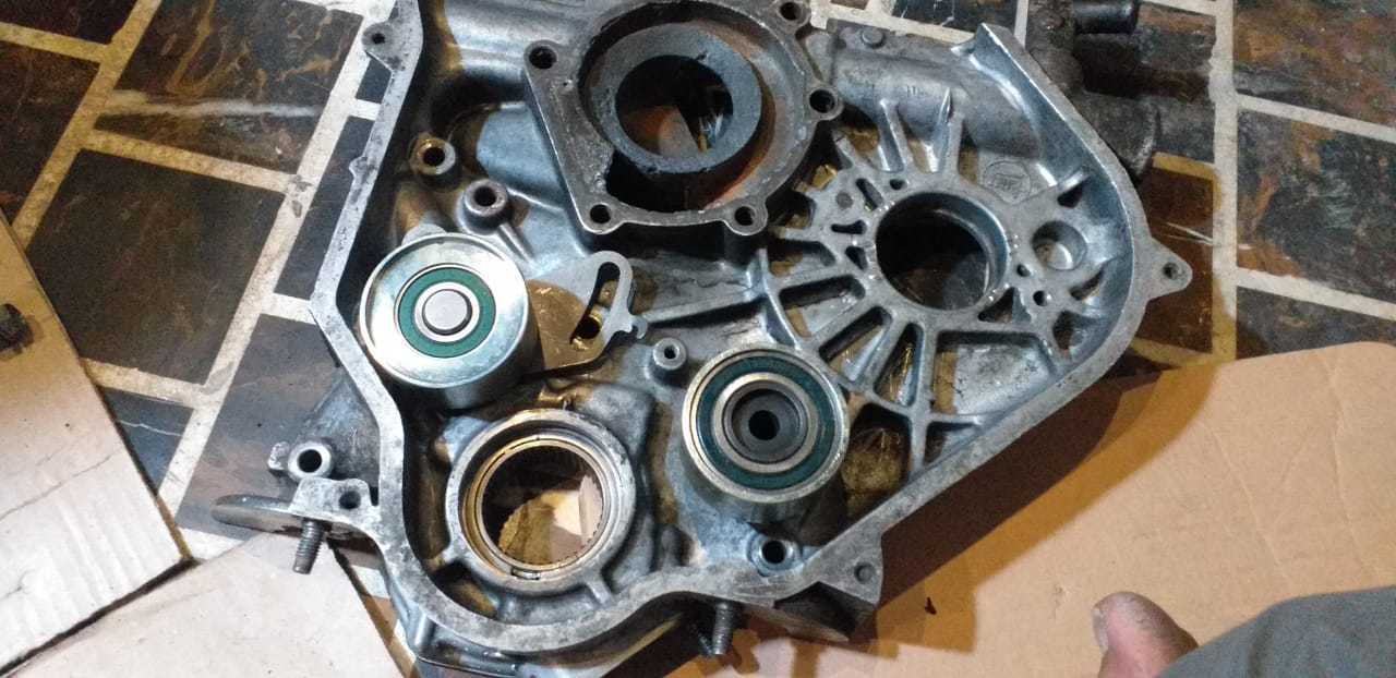

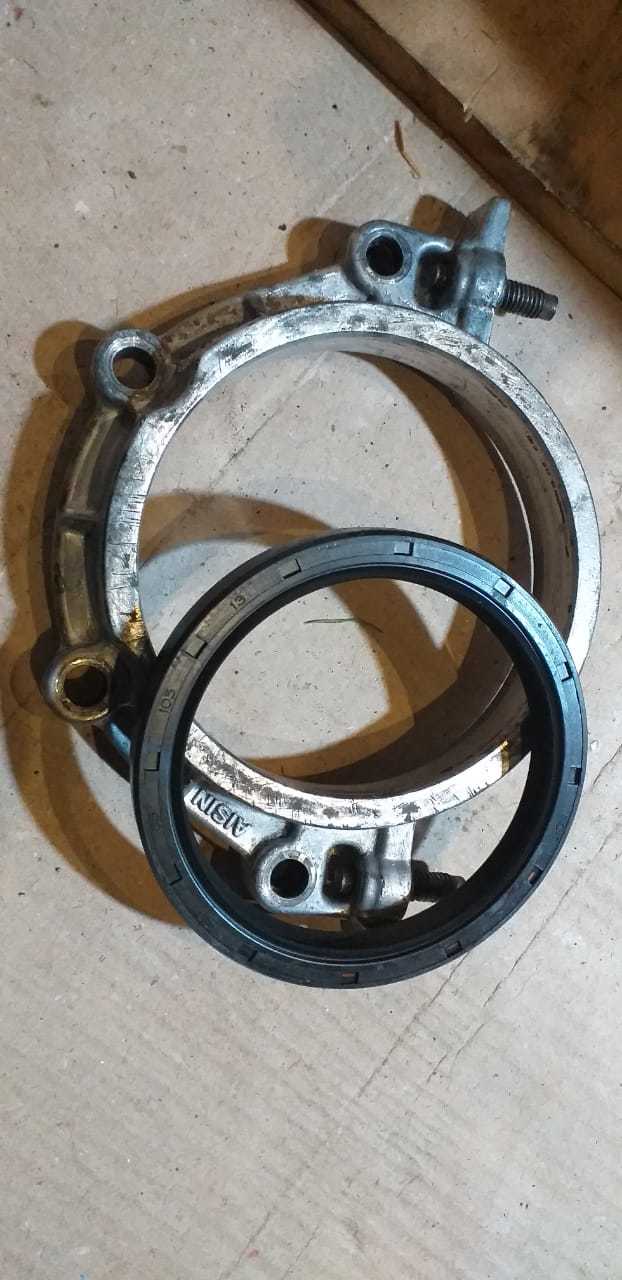

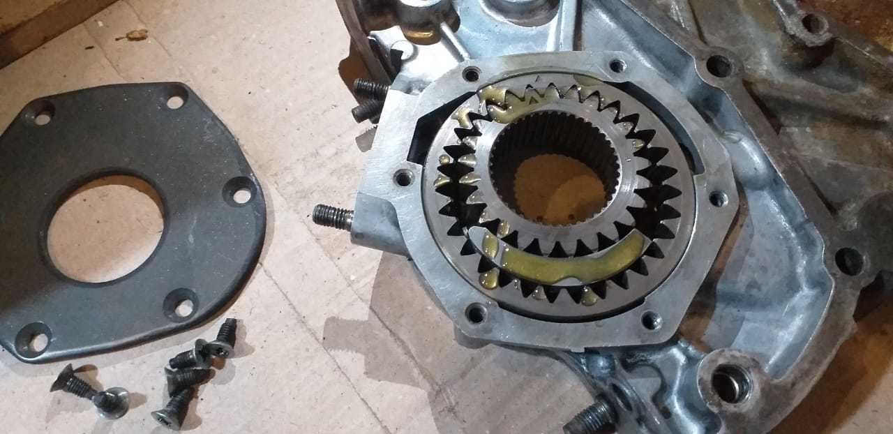

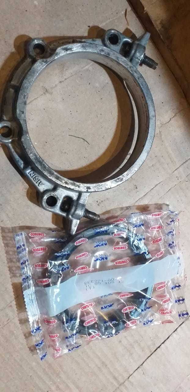

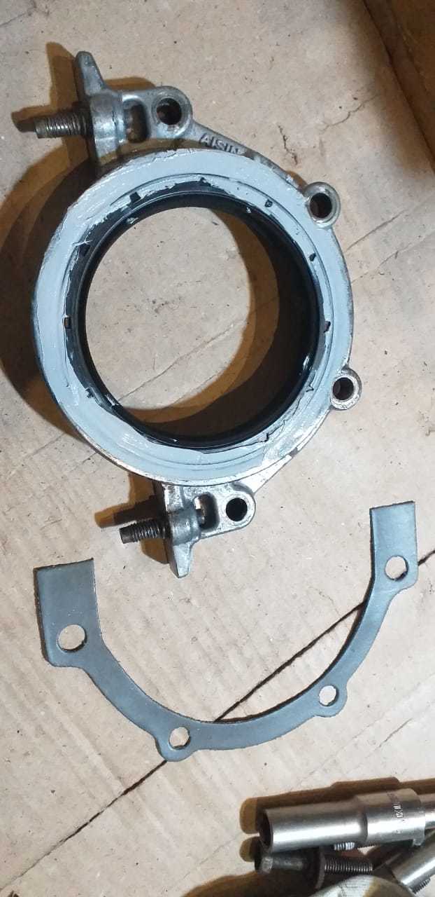

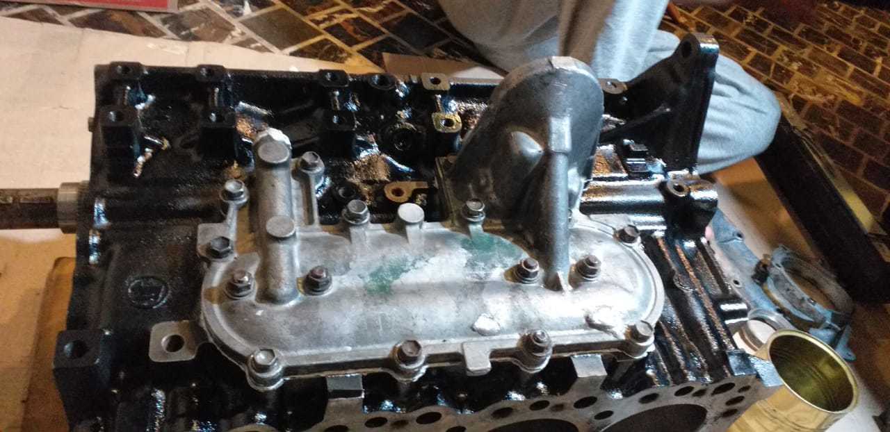

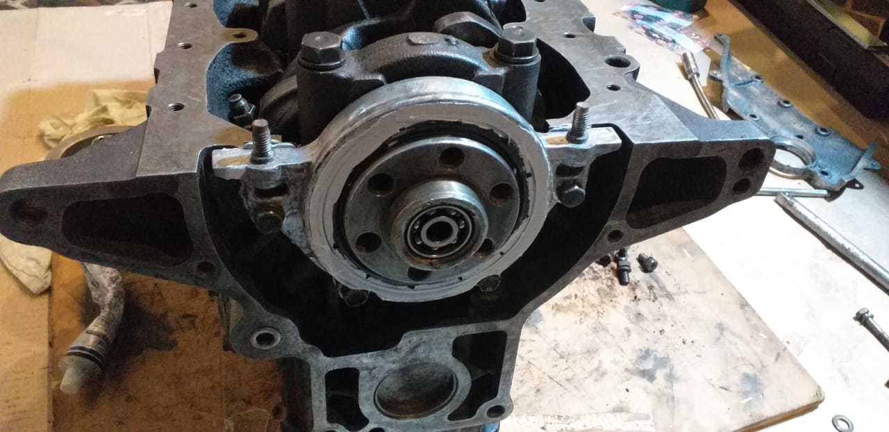

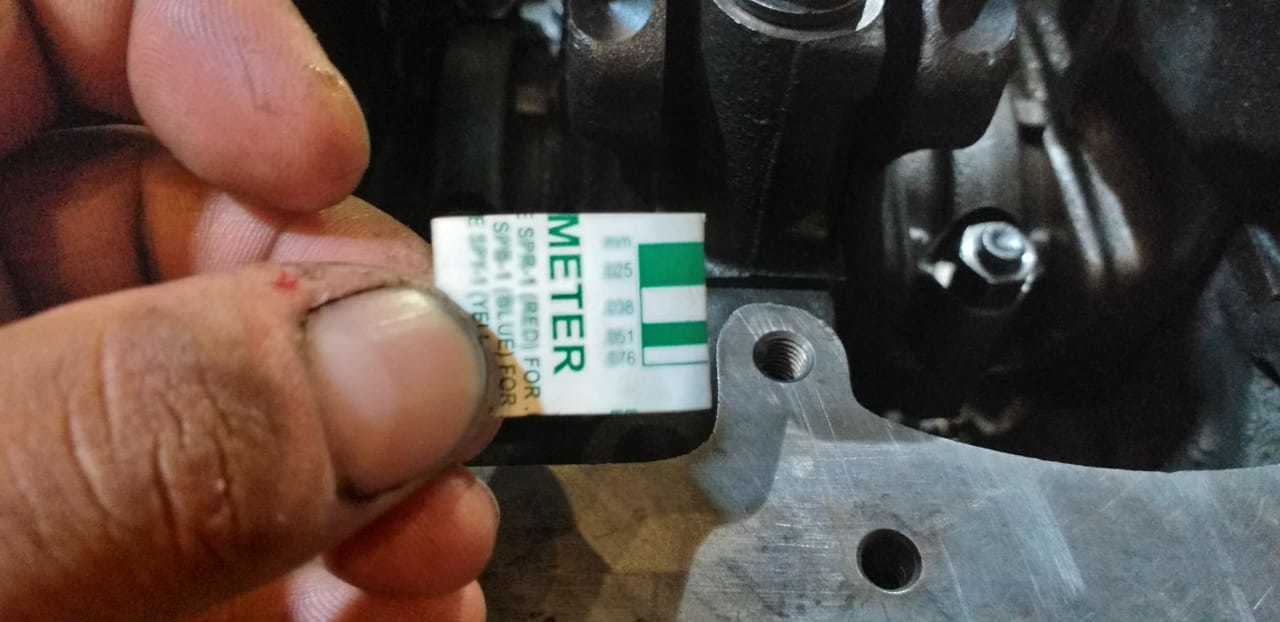

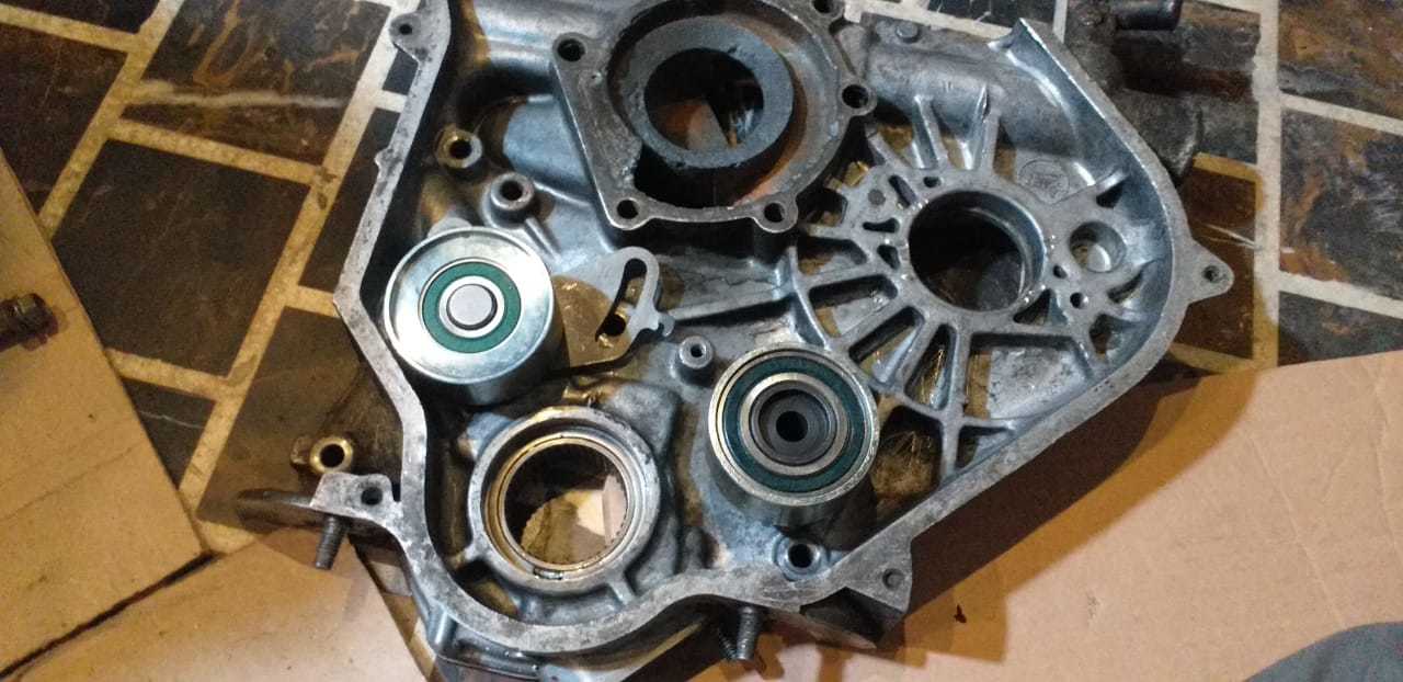

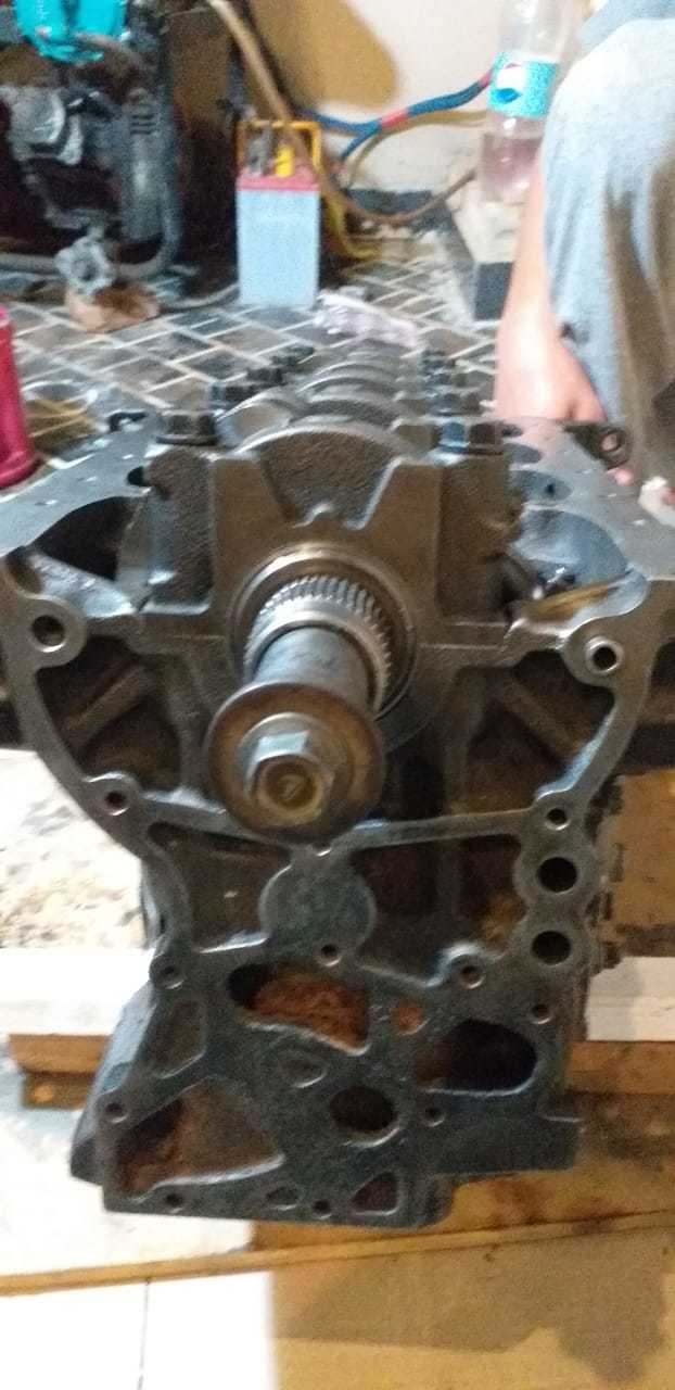

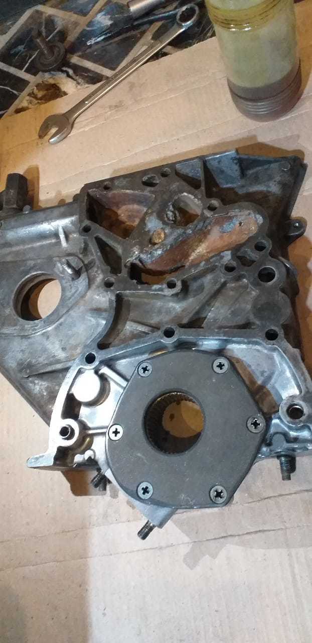

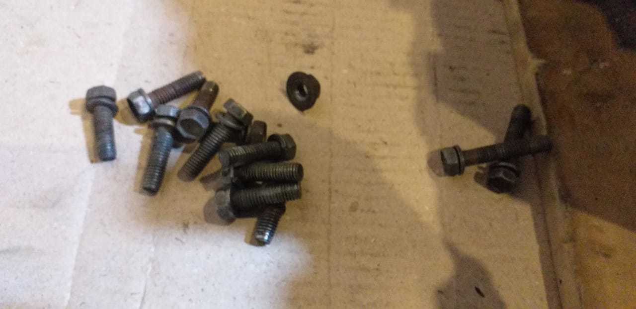

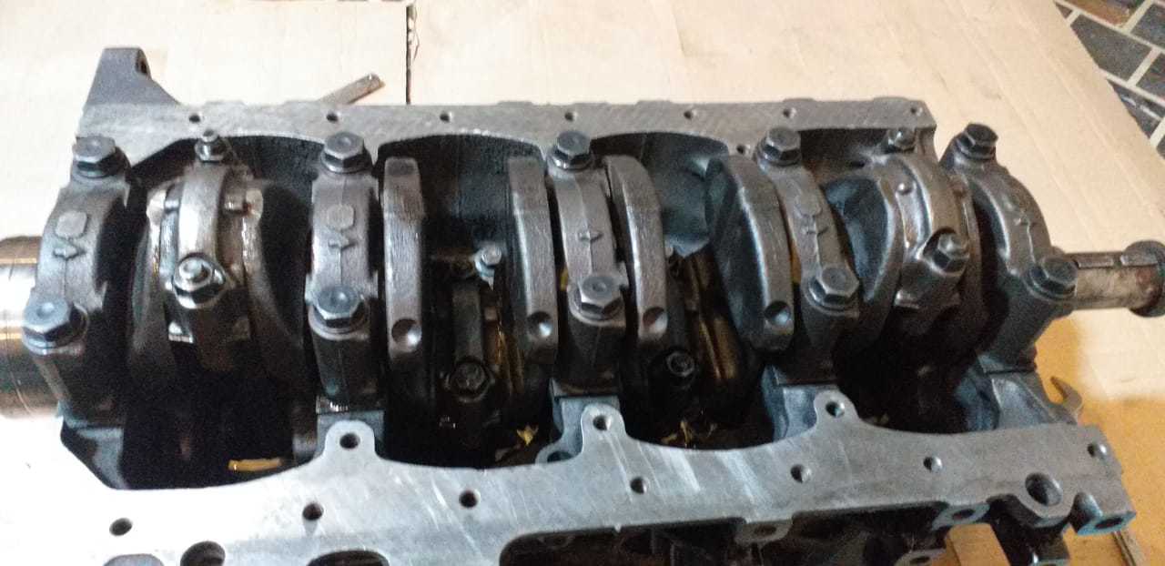

ok so last night i checked the connecting rod journal bearing oil clearance ,,,,, find it with in specs but again at the least corner ,,,,,,, proper torque it down ,,,,, also fit the fly wheel oil seal ,,,,, could not able to fit the oil pump because of idle bearing/pulley ,,,,,,,, previously some one has fitted 2C idle bearing,,,,,,i replace it with correct part but later came to know that correct part need a separate bolt as well ,,,,, so today source that bolt from old parts store ,,,,, hope so tonight will complete the block ,,,,,,,
