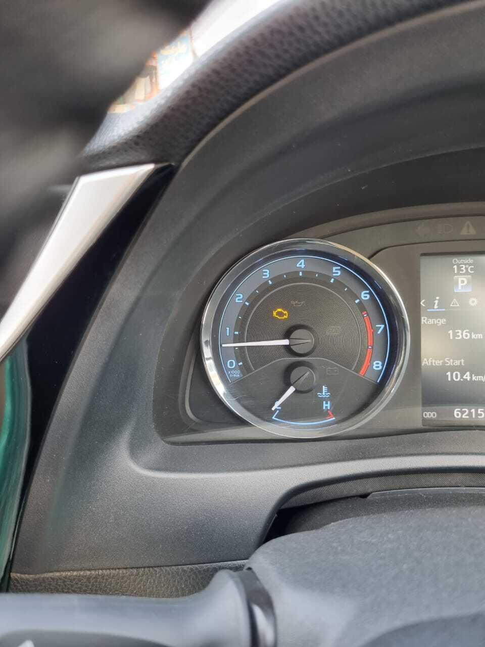

On 24th December 2022, my parents were on their way back from Sargodha to Rawalpindi. After entering the Motorway M2 using SIAL INTERCHANGE, they noticed a yellow light on the cluster and the thermostat meter fell down below the zero mark (Picture that my dad sent me on WhatsApp immediately is attached).
Taking it to be an electrical malfunction and considering the young age of the car, I advised them to stop at the nearest Rest station and contact the motorway assistance team. The hour was near sunset and fog was on its way.
After merely travelling for 5-7 Kms, the car stopped in the middle of the motorway . Our driver was able to manoeuvre the car to safety saving his own and my parent’s life.

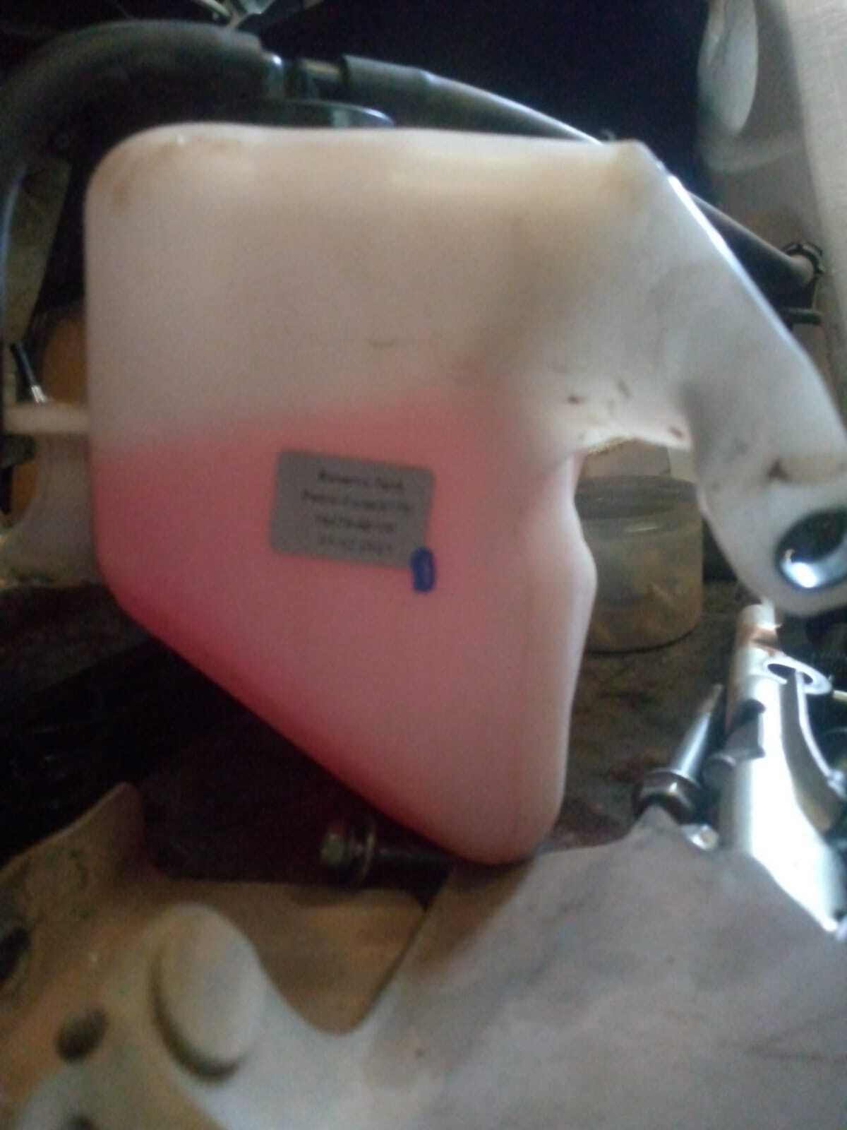

MOST IMPORTANT POINT: On the next Wednesday, a person named Shehbaz came from Lahore to survey the vehicle. He told me that the car had overheated which led to the engine seizure. The person told us that the cause of overheating was that there was no water in the radiator. I am attaching a picture with this post which will prove that the radiator bottle still had water even after reaching Toyota Sargodha. He said a water stain could be seen on the inside of the bonnet, and made an assumption that ‘probably’ the radiator cap was left open. It is important to note we have always maintained our car at Toyota since the start. In fact, we had the last oil change 2 weeks before at Toyota Sargodha Motors. We have been driving different cars for 25 years and we are careful enough not to open the main radiator airtight cap unless extremely necessary (You are supposed to see the transparent bottle that shows low and high levels of the coolant and keep the other one airtight). Our driver doesn’t get the car key except when he is with us. Even if the car did get heated, the thermostat meter had malfunctioned and it didn’t show that the engine was getting overheated for any reason. And this person was checking the car after roughly 2 weeks, how is a water splash supposed to stay there after 2 weeks? (And here’s the funny part: Roughly 1 week after this inspection when we opened the bonnet again, there was no stain. HIGH POSSIBILITY THAT THEY HAD MARKED THE STAIN THEMSELVES. But I won’t blame them for mere ‘assumptions’.) After getting the last oil change from Toyota (just 11 days before), we didn’t even open our car’s bonnet so how is a radiator cap even supposed to get lose all by itself?

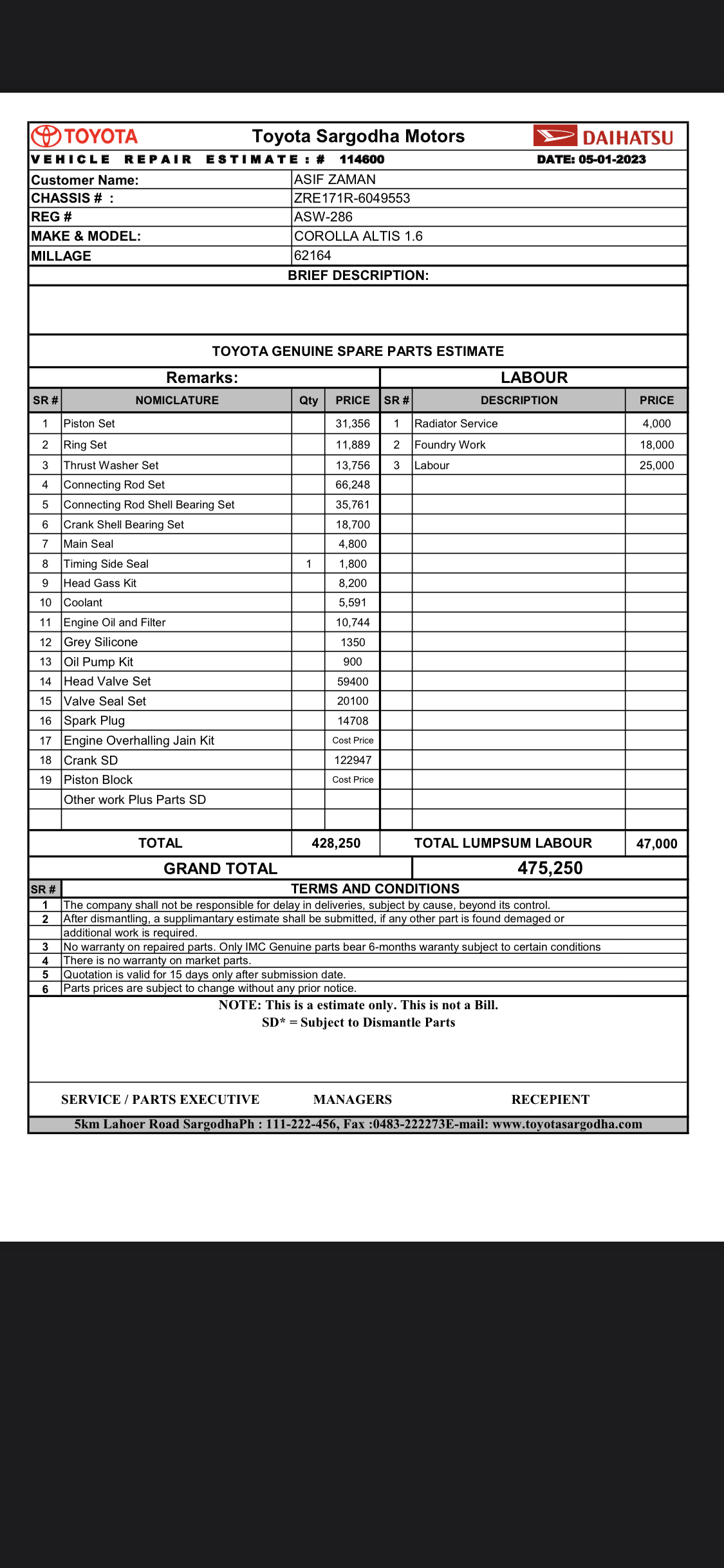

I am attaching a picture of the total estimate they gave us (PKR 490,000/-). They are literally offering us a lollipop of 40,000 out of the real 5 lac fraud.
