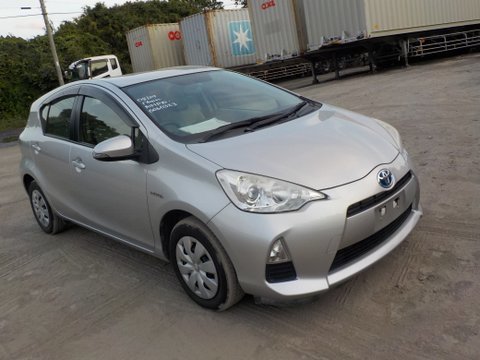

so i have now gotten my hands on this Toyota AQUA 2014 and have now kept it for 8 months .
having thoroughly driven it on mountains, cities and long distance, i want to write this (honest) review ..

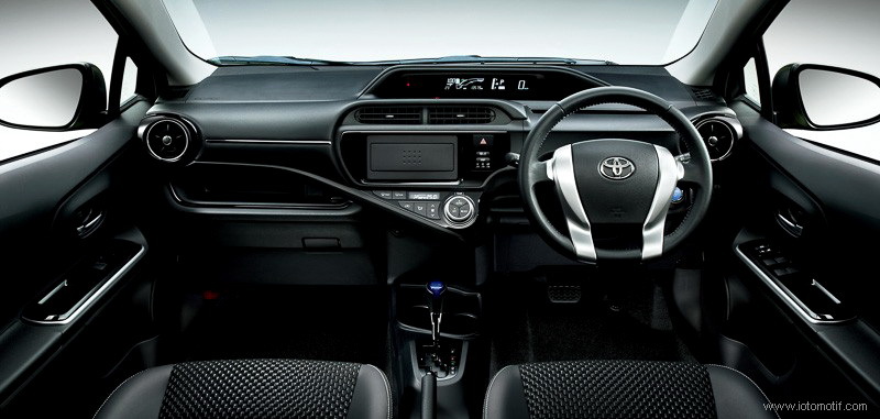

not so in reality, the cabin has a quality feel and is well equipped. the ac is superb and noise cancellation is excellent to the point of being eerie. the steering feel is a bit damped and aloof yet comfortable nevertheless , legroom is adequate if not spacious. the stock speakers are OK .
LCD is typical japanese, useless in pakistan but you can play music and have camera installed etcetre. i have not changed it.
there are 2 airbags ( base variant ) power windows and remote lock . there is no immobilizer in base variant
