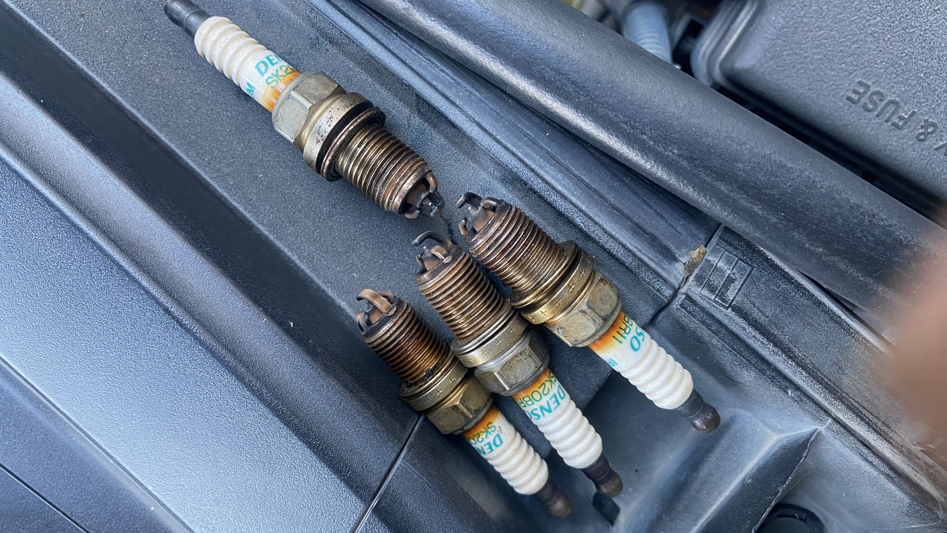

Engine Shudder/Missing
The engine has a noticable missing / shudder when in low RPMs / speeds upto 30/40 km/h / when HV battery is down to 2 bars. Except for these conditions, the engine and throttle response is stable. If I engage cruise control at speeds between 50 and 55 km/h, i can feel and see the RPMs(techstream + bars in the eco meter)moving between 900 and 1200 in a pulse-like fashion on a straight and flat road. This does not happen at speeds above 55/60 km/h.
There are no codes. The car is about 194k KMs driven and maintenance has NOT been neglected. Would appreciate if i could be pointed in the correct direction to resolve these issues. @haseeb.basharat @Xulfiqar @syncview @capsat @Storm
