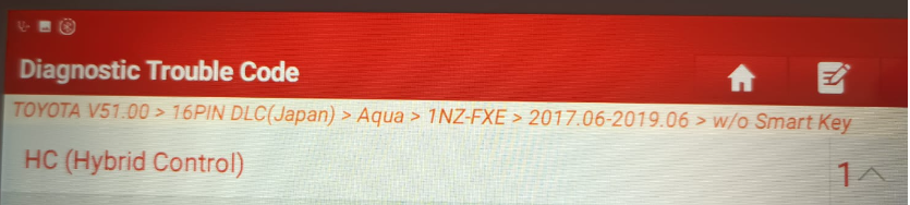

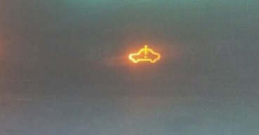

I have a Toyota Aqua, displaying a hybrid sign with an error code U0110: "Lost Communication With Drive Motor Control Module A." Attached are some pictures for your reference.
This yellow hybrid warning sign only appears when the car is started after being parked for 3 to 4 hours. However, if I open all the doors for air ventilation for 5 minutes before starting the vehicle, the yellow sign does not appear. Additionally, it does not reappear while driving once I clear the warning sign. In summary, this sign only appears when the car has been at rest for 3 to 4 hours with the windows shut.
