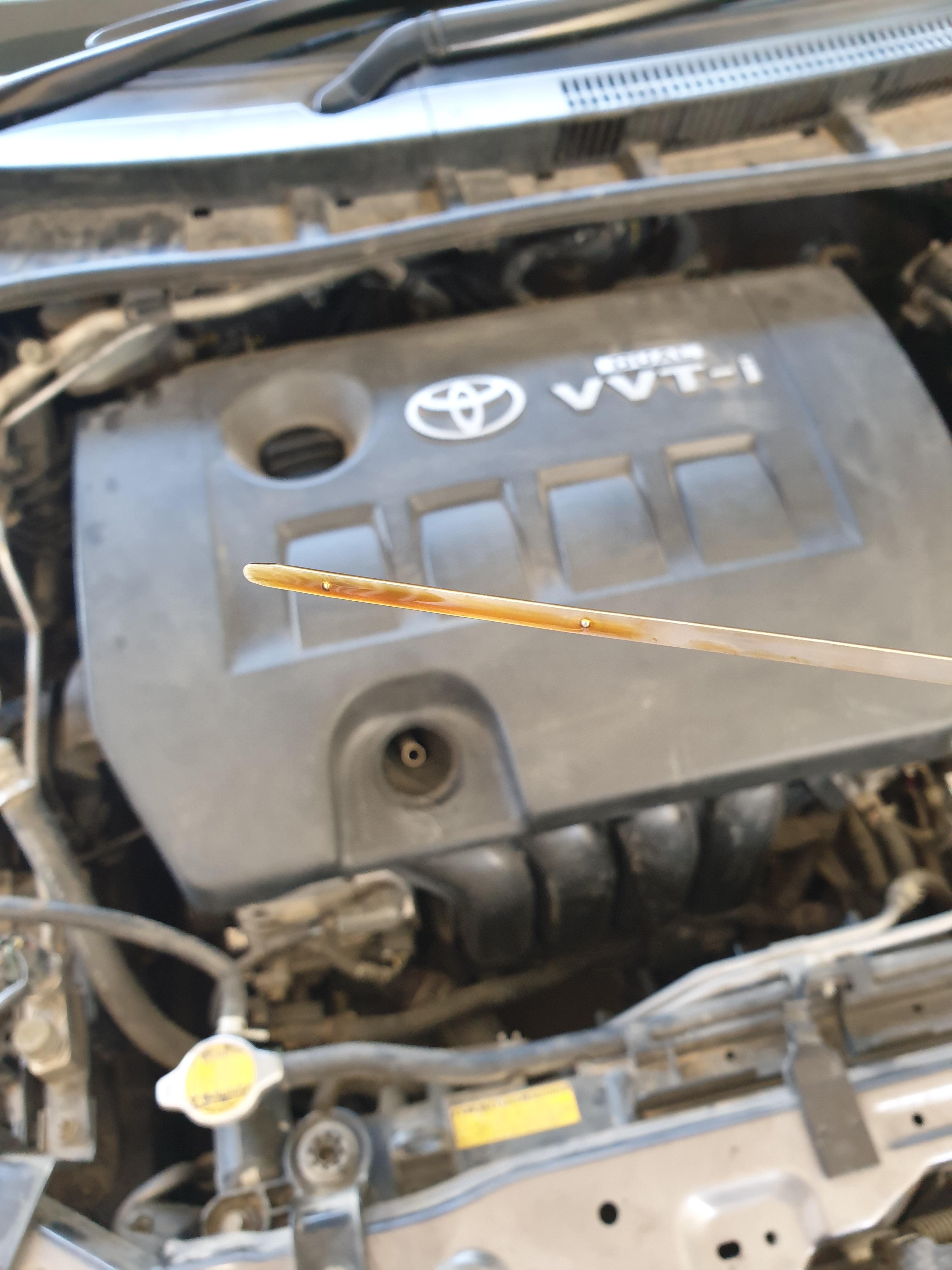

Pic of oil stick from today morning.
As per dipstick's reading, it is "overfilled" and that is not good for your car's engine.
How much oil is recommended for this engine sir ? 4.7 or 4.3 liters ?
For 1.6 Altis Cruisetonic and1.6 Altis Manual 6 Speed, 4.2 Litres of Engine Oil (Including oil filter) is recommended. Here is the picture from Owner's manual
