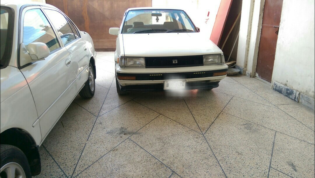

Bhai fronts are stock shocks and stock cutted spring ( i cutted one round) rear are stock ae90 shocks with ae90 lowering springs. I played a trick with fenders and total up down movement of the wheels.
I had installed rubber washer type packing in the shocks rod with decreases the movement. And other work is done with the fenders i rolled all 4 fenders and pulled front fenders out using jack and also hammered the floor panels back. So 205 profile goes inside easy.
