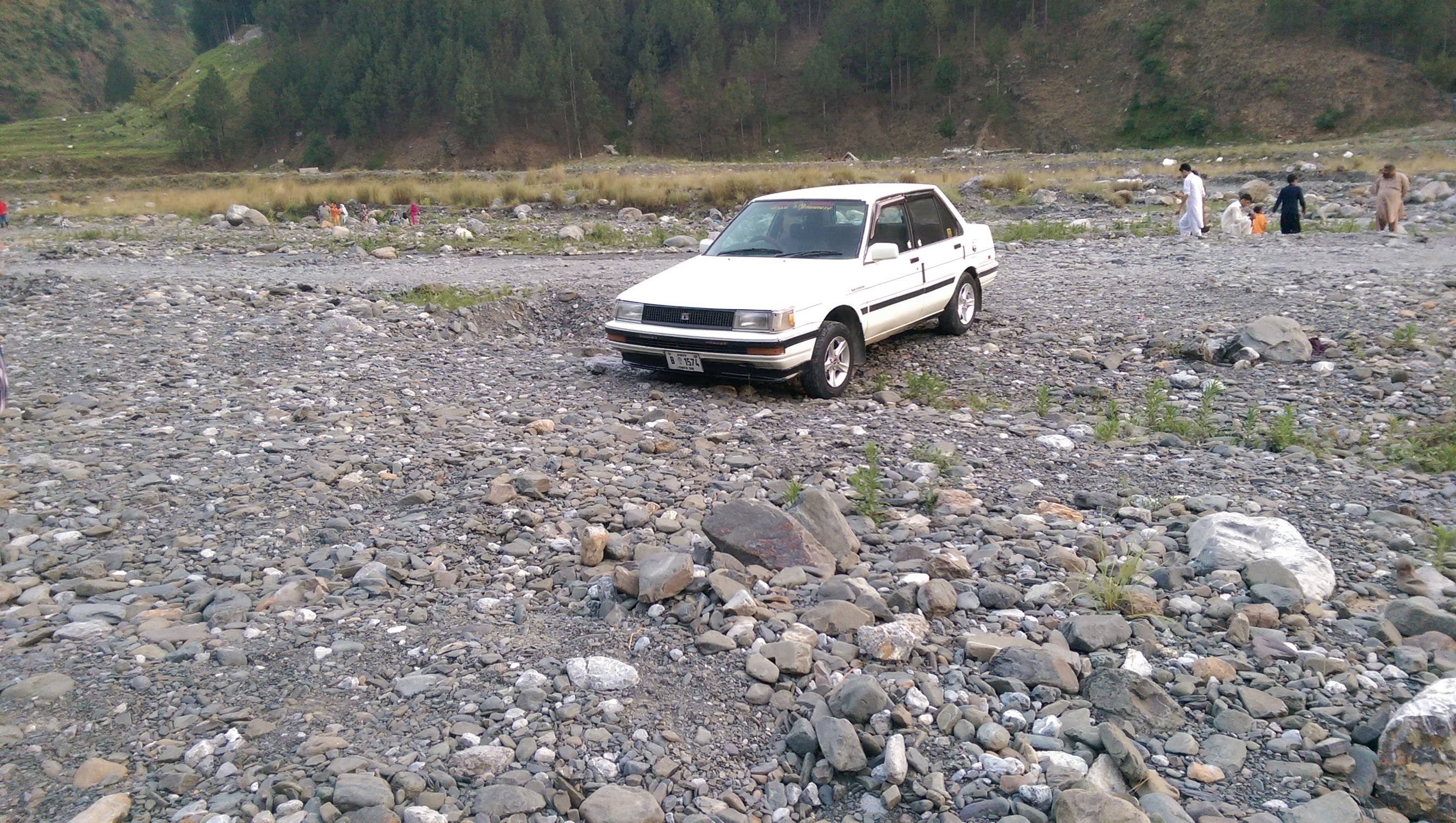

don't rice your 86 just install lip like @rockstar.mij bhai's 86 and spoiler similar to GT ......FWD's don't need such spoilers.you can get them for any body kit shop.
Bhai...car is looking fantastic Mash Allah..Want to see the front look..With new lip on front.
Thanks bhai. Sure
Do you know of any shop in Islamabad/pindi? and kindly share the pic of the lip you mentioned. I do like the GT spoiler but if it comes with clipper to the trunk, dont want to bolt a fully genuine car
GT lip is expensive and so does the spoiler....i'm not saying to install GT Spoiler i said to install Spoiler similar to GT....they also come with 3mm tape. Sorry i'm from Lahore.
ok lip to the front the what about the back? i wanted to extend both. otherwise i did install a rubber spoiler and decorated sports look
Remember rear lip increases drag force.Front lip allow less air to go beneath the car which increases stability but installing bigger lip then required also increases drag. And honestly rear lip looks super awkward not only in 86 in every car.

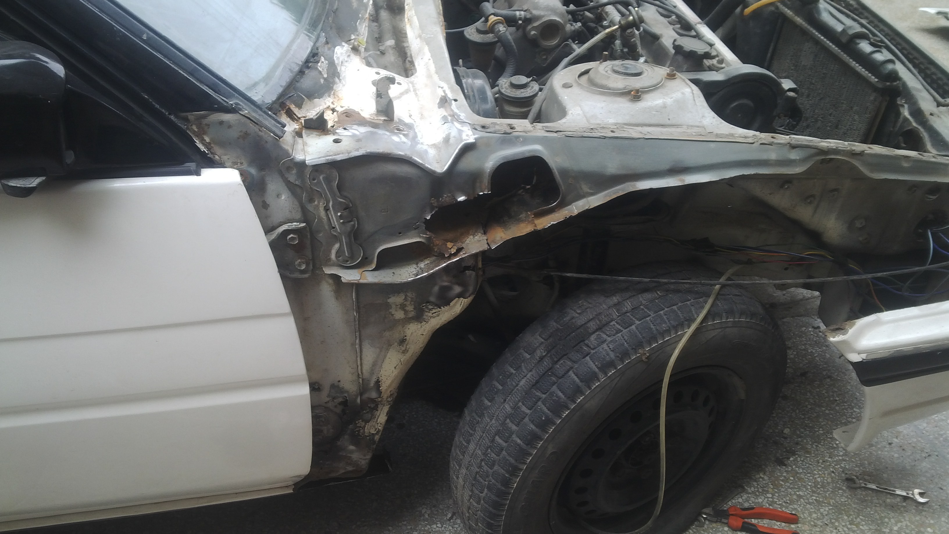

yes those fenders are welded

Cutted.....or jo ander hai uska to poucho hi na After hammering

yar yah spoiler ka faida kia hota hay?
konca lip speed taz krta hay bhai?
Han gii nangibhai spoiler ka kaam hota hai rear ma grip zeyada krna means air drag ko increase ab keu ka RWD ma zeyada grip rear pe chaya hoti hai is leya inka zeyada use RWD cars ma hota hai FWD ma ya front or rear air drag ko balance krna ka liya lagaya jata haiLip ka depend krta ka gari kis cheez ka liya build honi hai either for drag or for drifting but main concept ek hi hai neecha sa jana vali air ko kam krna han ap bilkul neecha sa air kam kr daien ga to uper jo air drag ho ga vo bhot zeyada ho jae ge to basically ya gari ka aerodynamics ka hesaab sa calculated hota hai abroad ma log calculations krta haien yahan aanaa vaah. isi leya GT ka prefer kiya jata hai.
Thanks brother.
