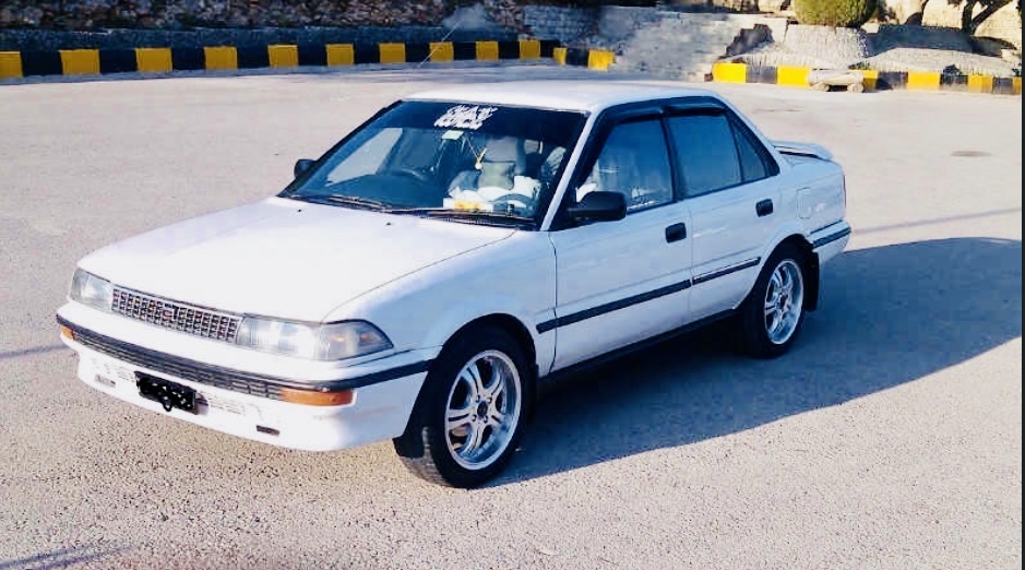

If steering rack has problem it should produce kharak at uneven roads. But no khrak no extra sounds. Just feel unsecure at speeds above 80 and one front wheel bearing is also shot. Lets see i will replace all new bushings new brake pads and will see if any chimta or end need replacement. And also it has rear spacers which i want to get rid off. Car is high from rear and low from front. In front 3 finger gap is present but in rear 7 finger gap. I want height to be same for front and rear. Bro the car is super smooth on cng but on petrol it does like phrak phrak from cylencer and car is like ghuti hui and drinks petrol.

I have 195/65/15 installed in my AE90 i think they rub on full turns. Donât have budget atm else i would have gone for 185/65/14. Bro what is cost for power pump of 4efe, its all soaked in oil and also has constant whine.
Yes 3.7,195/65R15 is a pretty big profile for these cars....gari to bhot zeyada lifted ho ge....install 195/55R15,best profile for these cars show+comfort and stick with 15's.@rockstar.mij bhai got 4efe also facing pump issue.Between pump will cost about 2~3k.

Bro 195/55/15 wont rub with body? Because atm 195/65/15 rubs with body very badly. In 15 max 185/55/15 because bigger then this will rub with body. Else 185/65/14 is what ideally looks good and doesnât harm the car. Genuine size of my car is 175/70/13.
It will rub but not too much as you car is lifted why too much.The profile you installed is too big as i already told you. Total diameter is big that's why it start touching.Yes 185/65R14 is ok but if you don't want to install 195/55 you can try 185/60R15.
