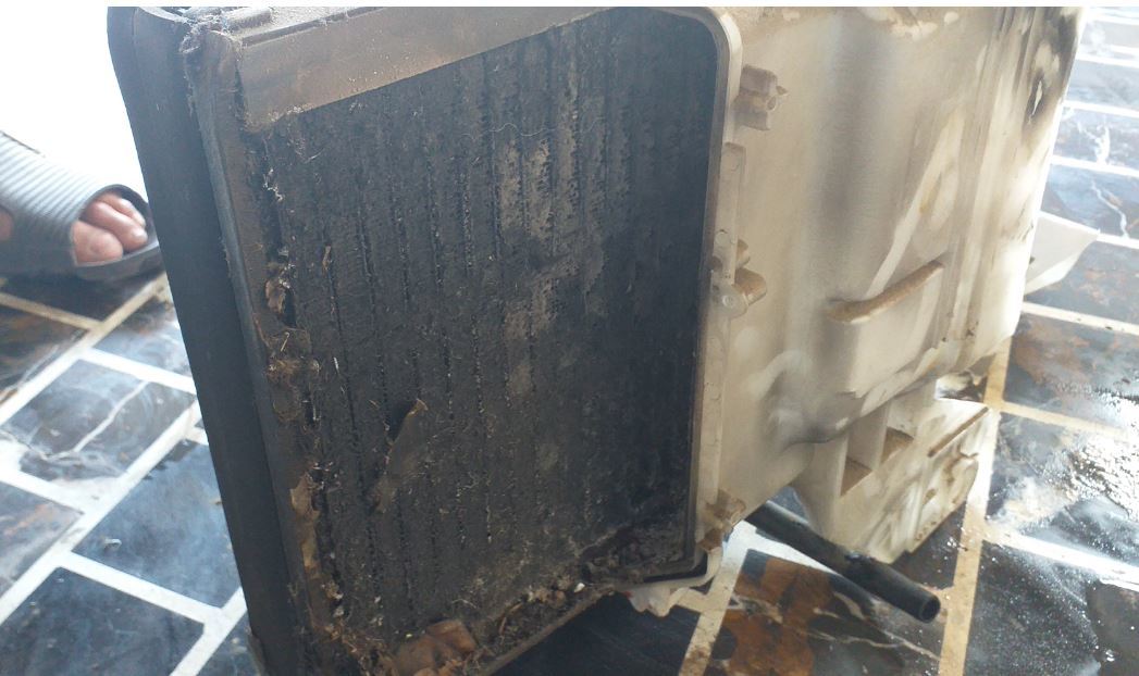

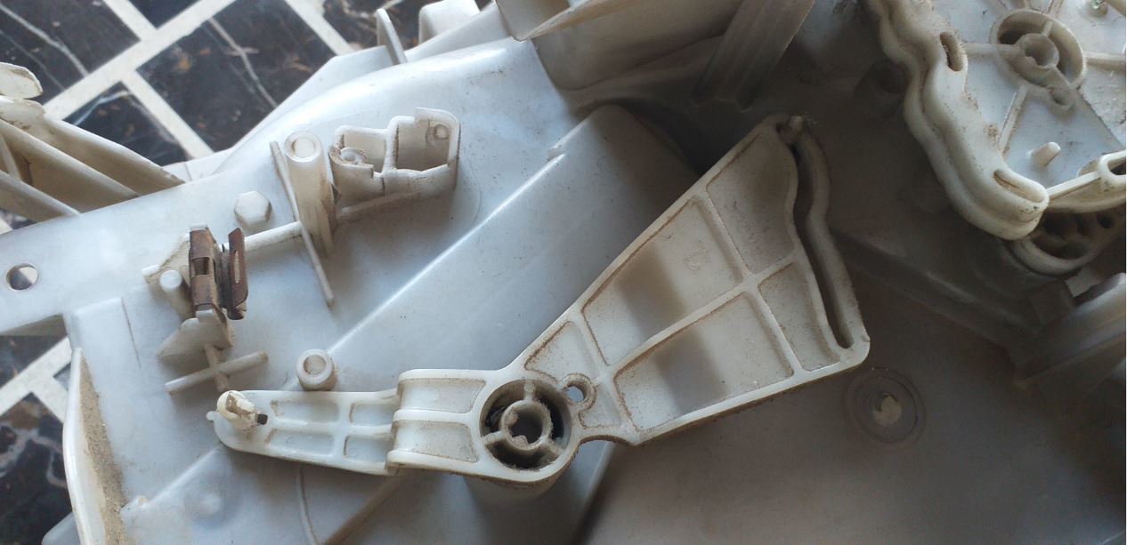

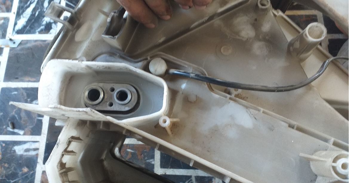

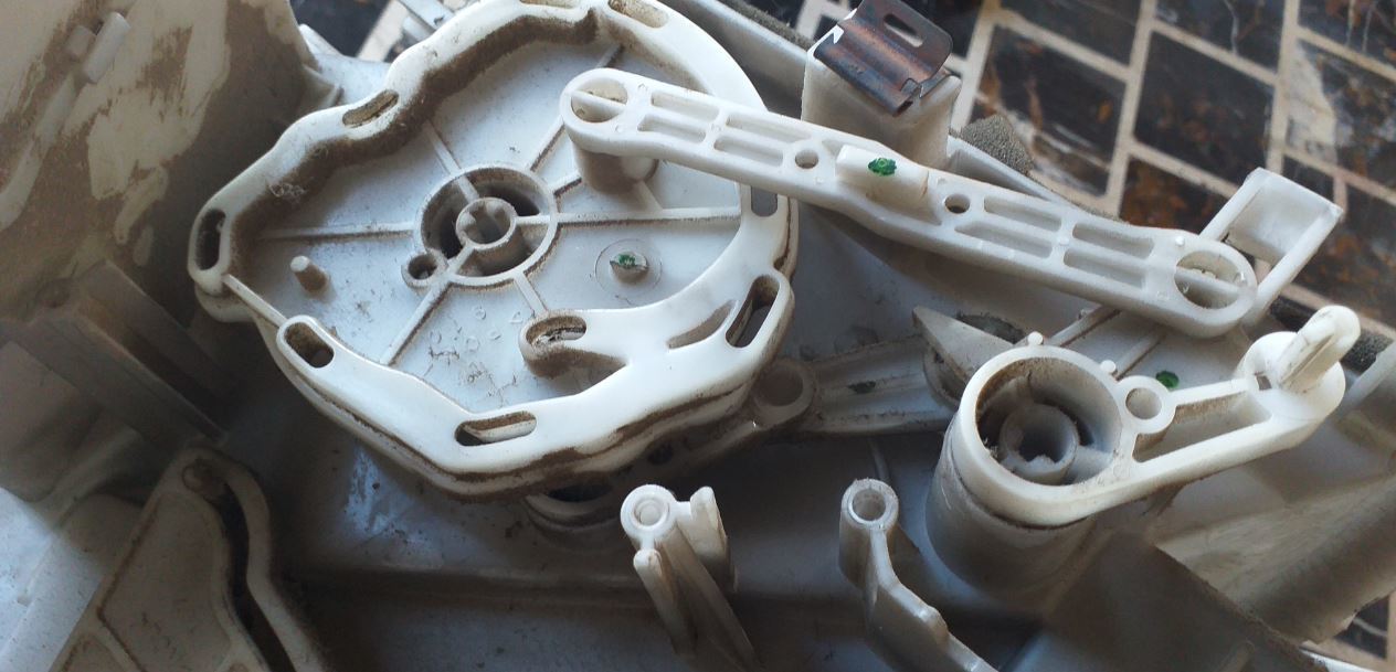

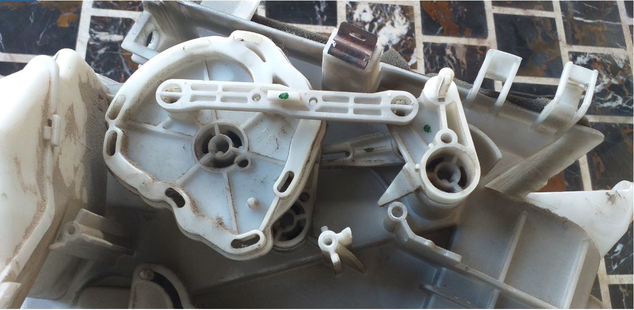

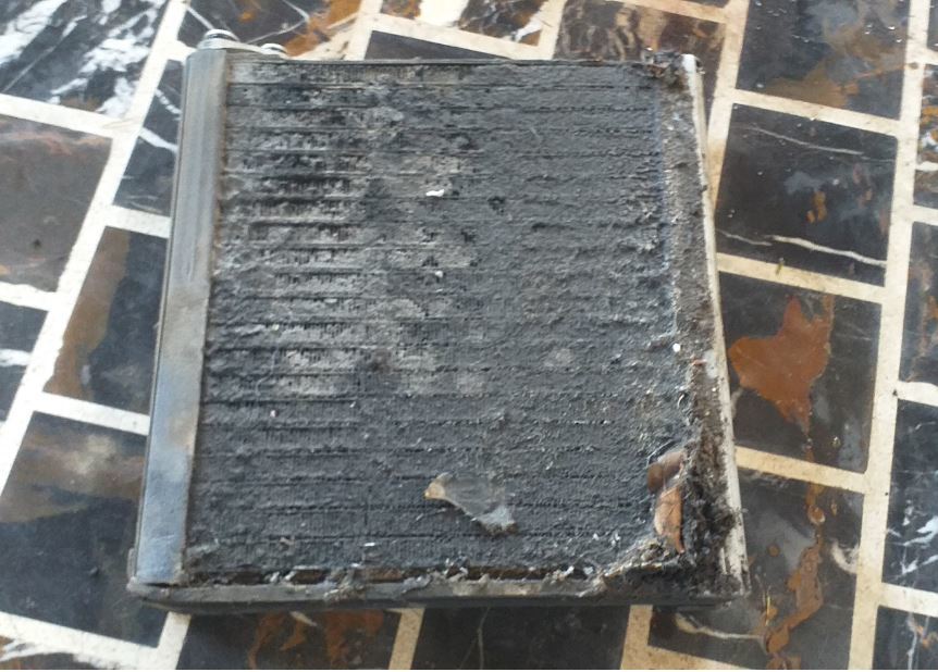

all of this practice is just because of this ...........

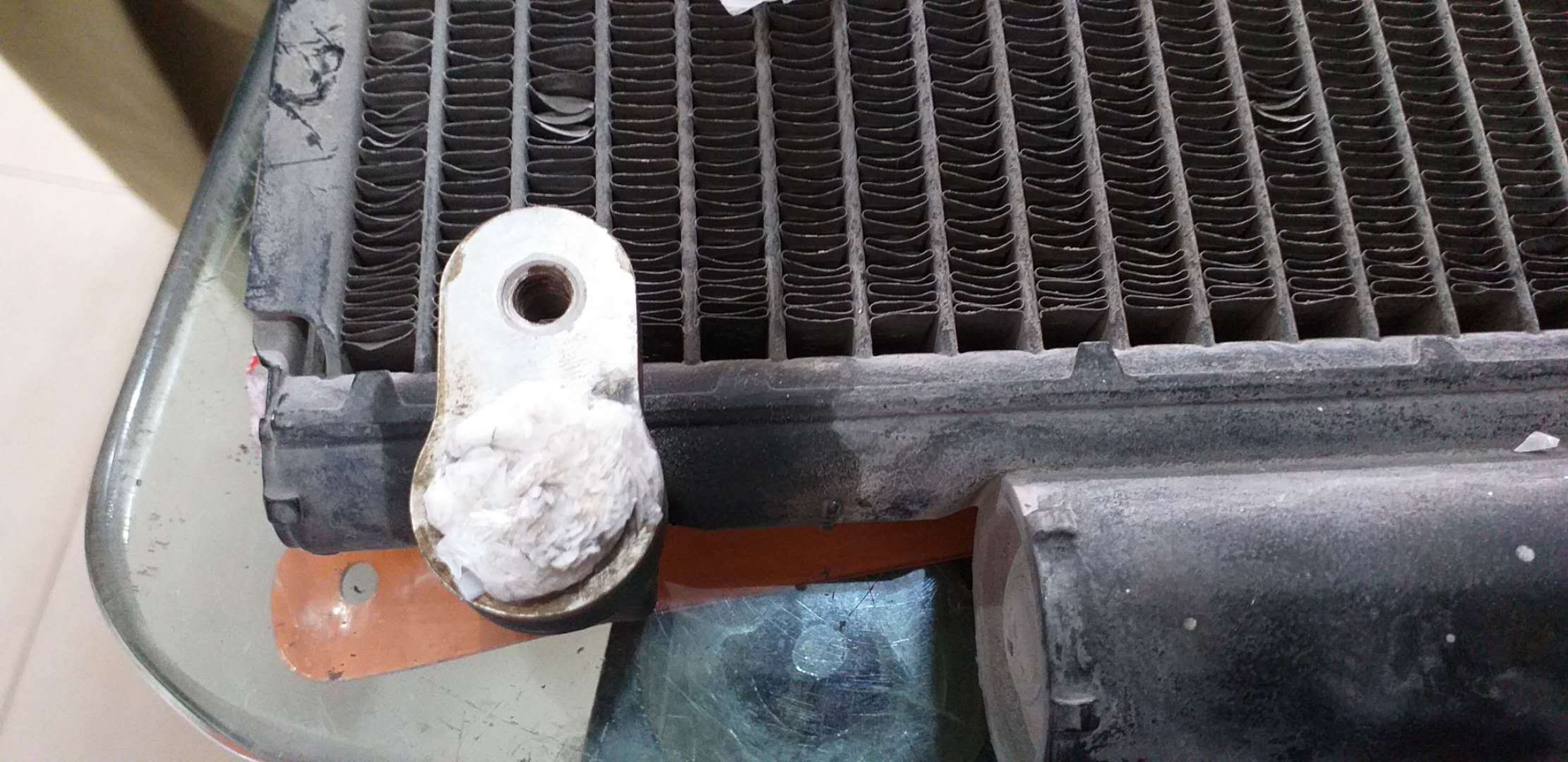

Even after ac filter.

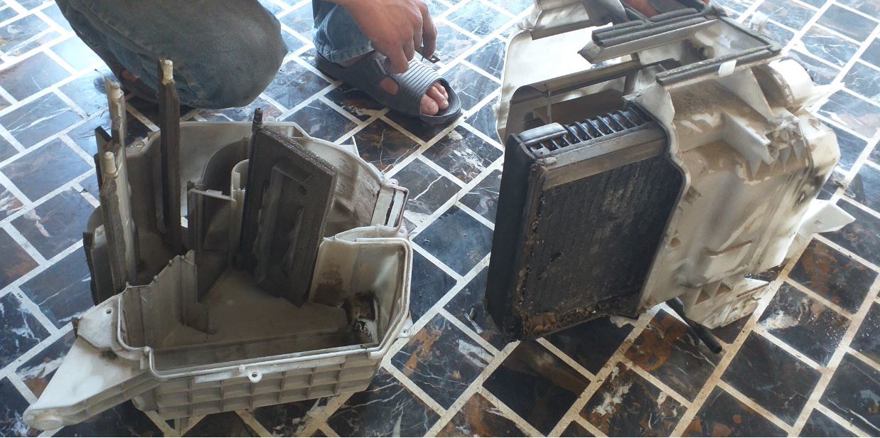

older pak assembled corolla wont come with cabin filter,,,,,,, but it can be added ,,,,,,,

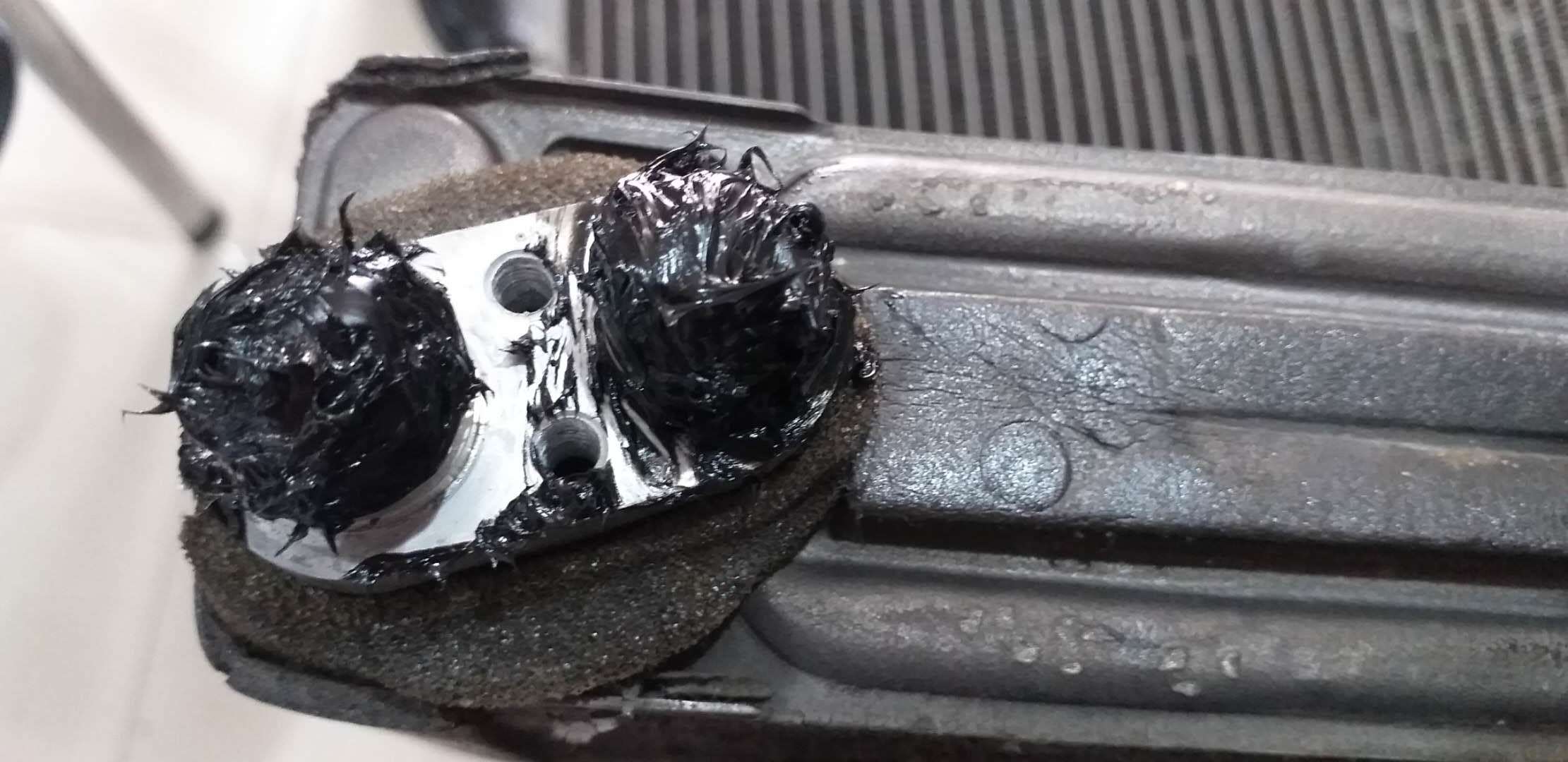

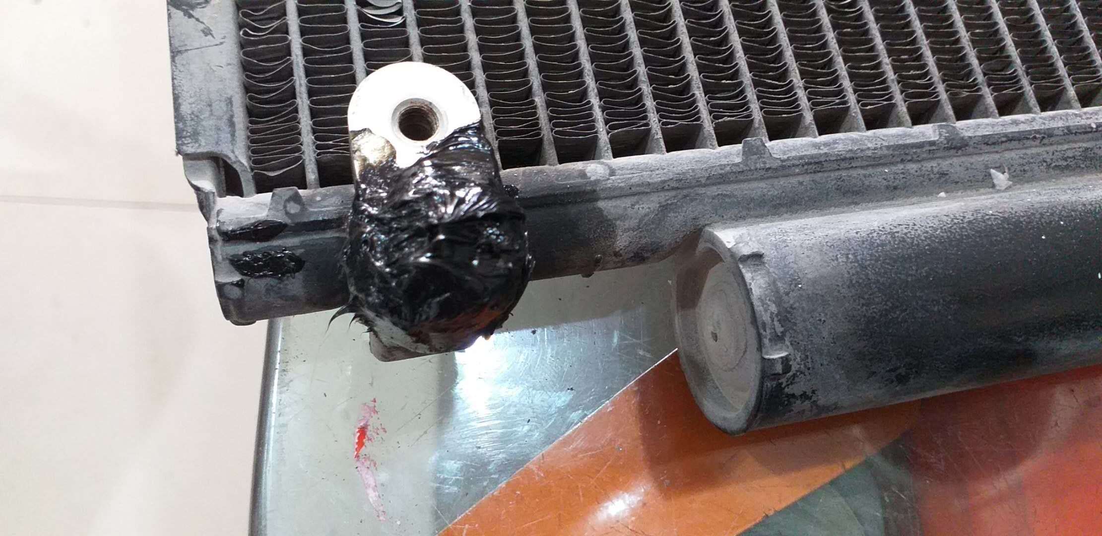

temporarily block the opening with silicon so that water wont go in while cleaning,,,,,,,

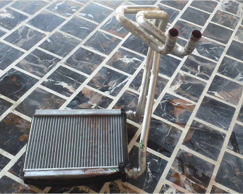

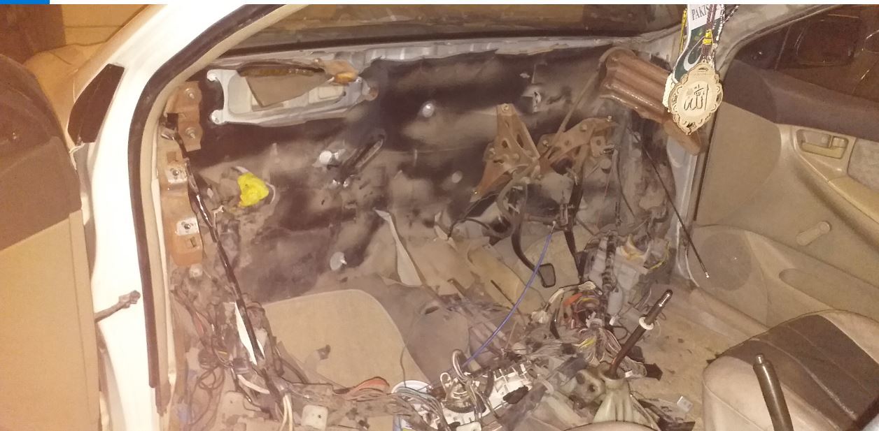

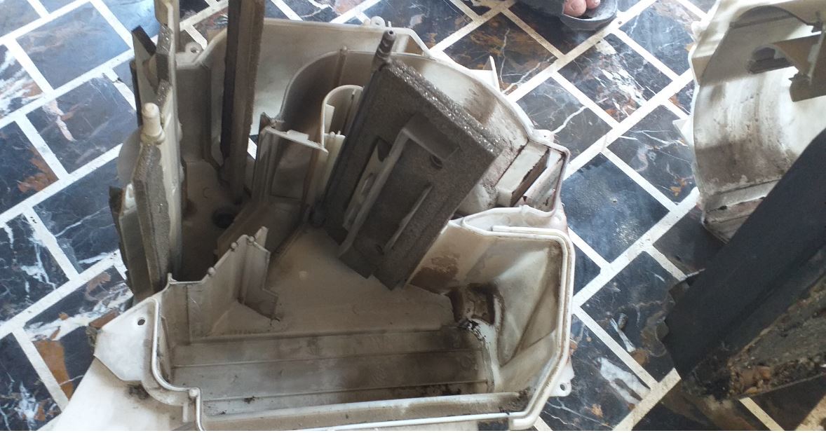

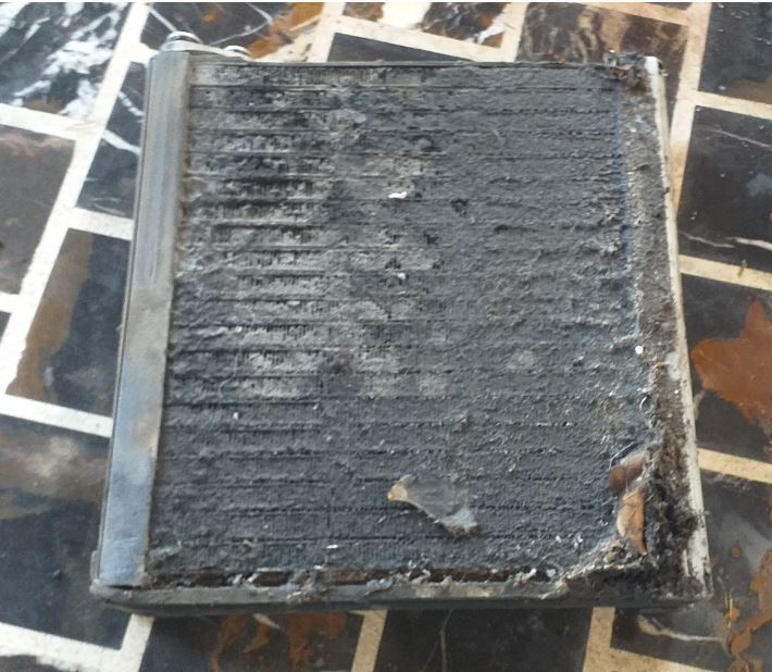

Why did you dismantle the whole AC unit?
Badly choked. Looks like getting serviced for the first time.

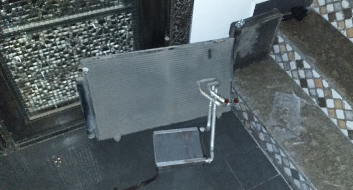

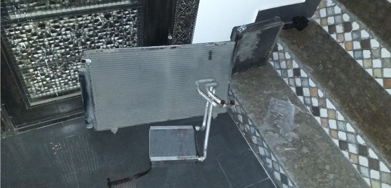

it deserve complete service after 15 year of use ,,,,,,, and its much batter to remove the complete system , flush it from inside out and then fit every thing back ,,,,,,,,
yes first time ,,, and till now it was running with factory filled refrigerant........

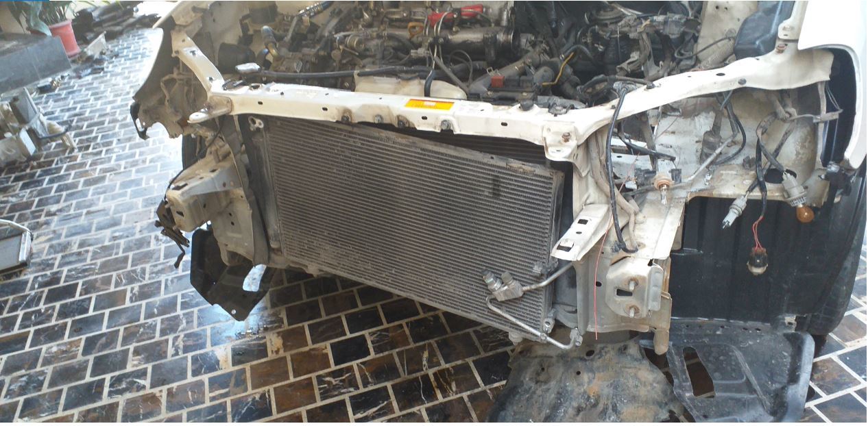

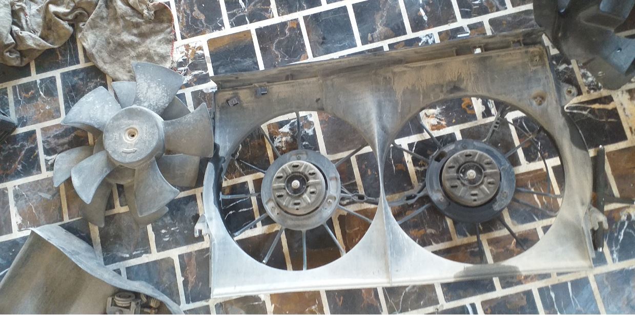

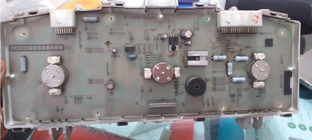

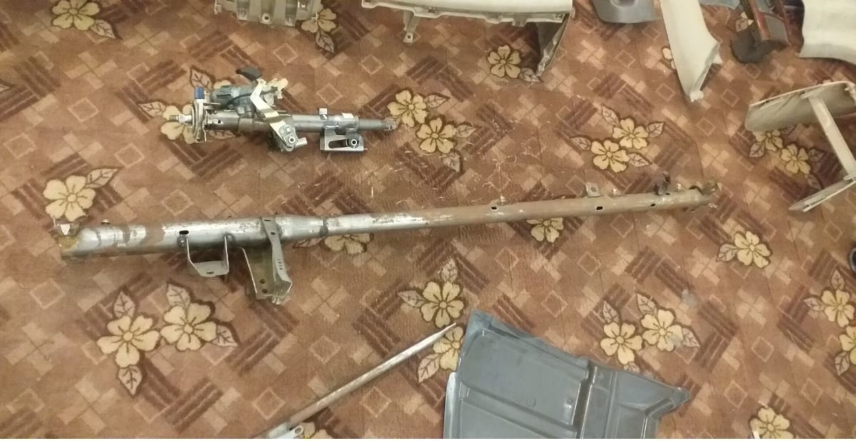

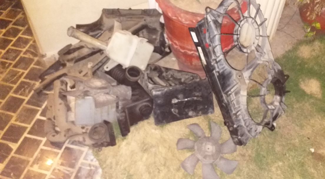

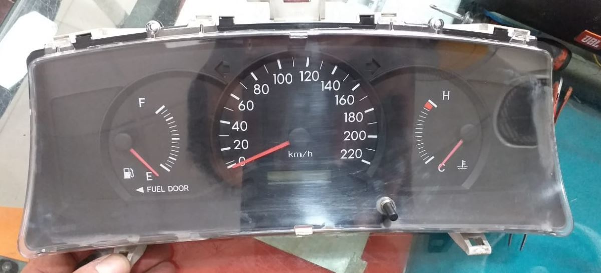

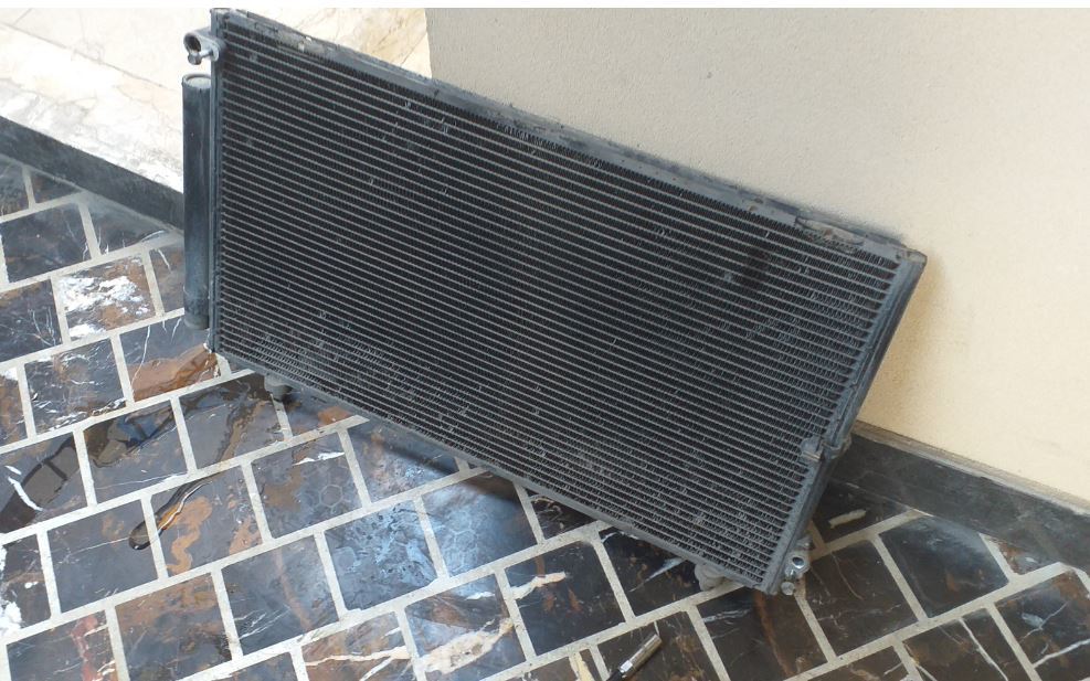

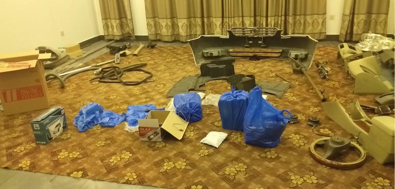

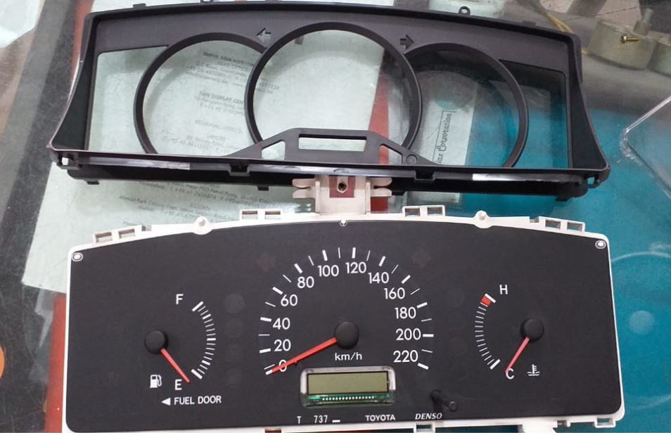

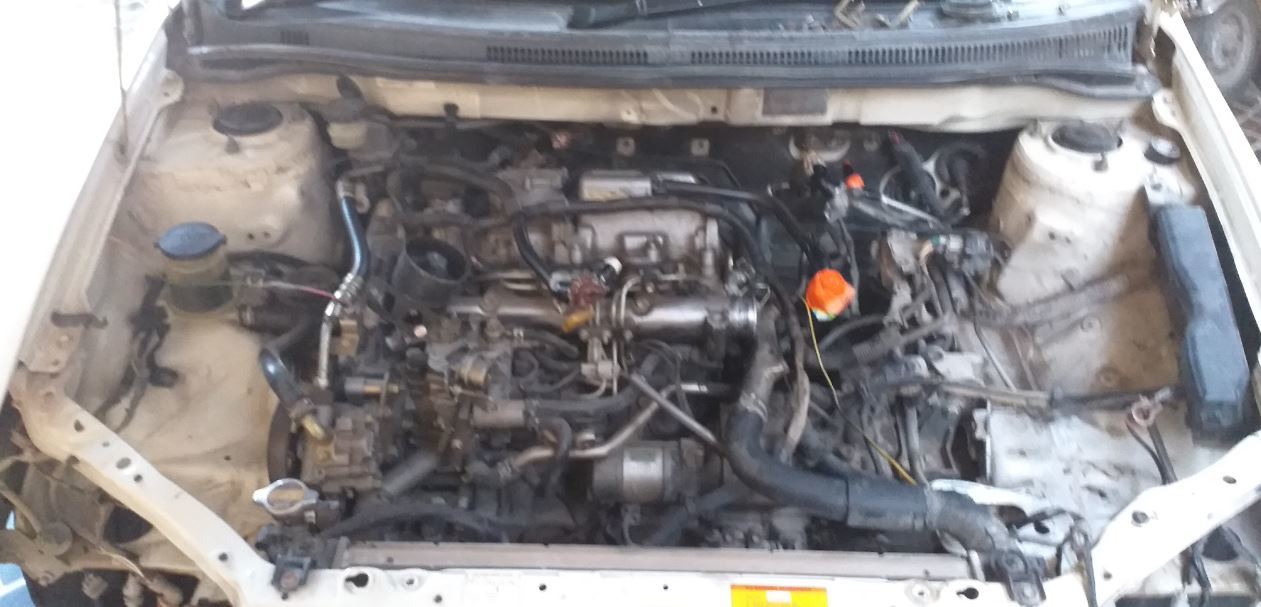

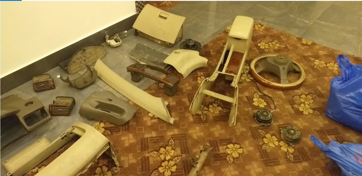

Updates

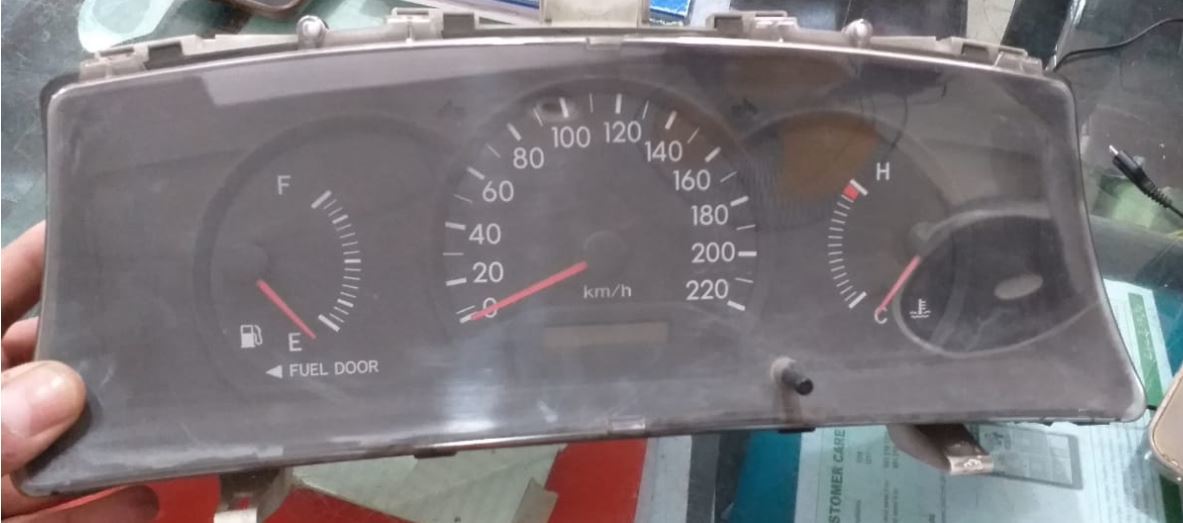

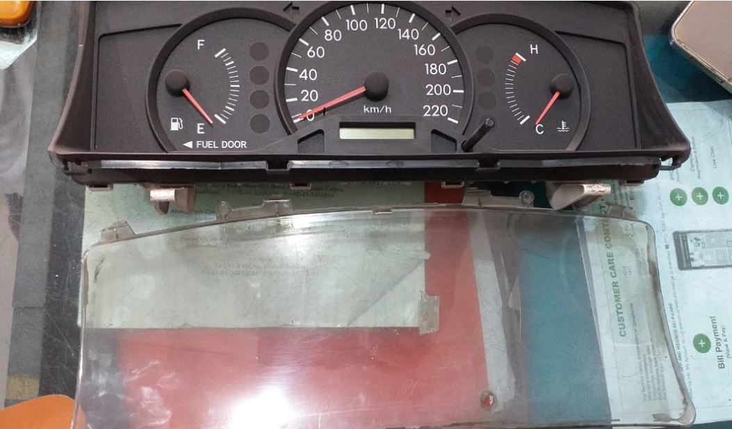

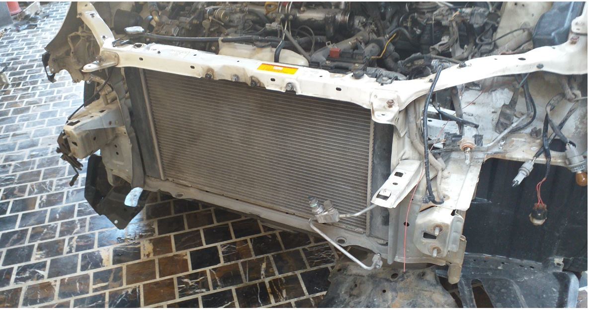

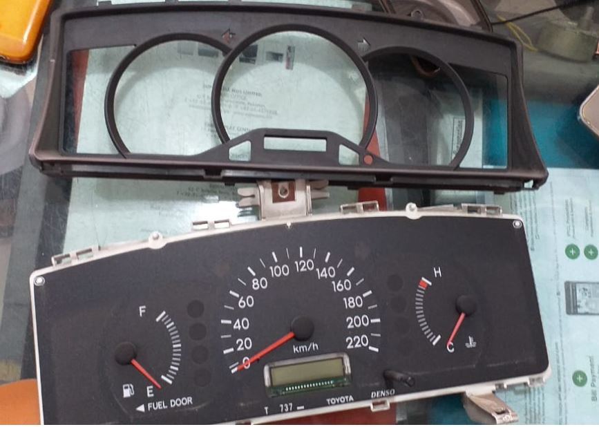

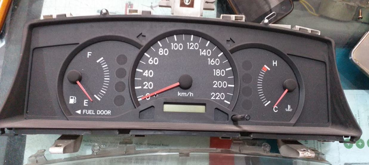

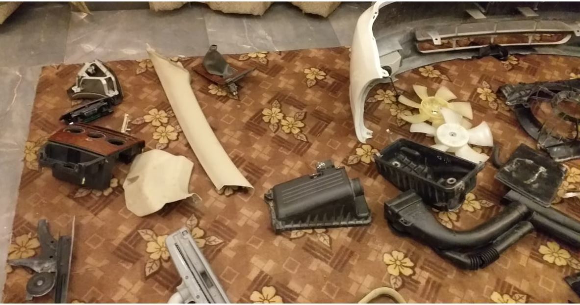

just clear then cluster panel today ,,,,,, also wash almost all the parts which removed before ,,,,,, haven't flush the AC from inside because unfortunately lot of my tools are missing due to home shifting last year ,,,,,coming Friday i will wash and polish the engine bay and then flush the ac system and fit every thing back ,,,,,,

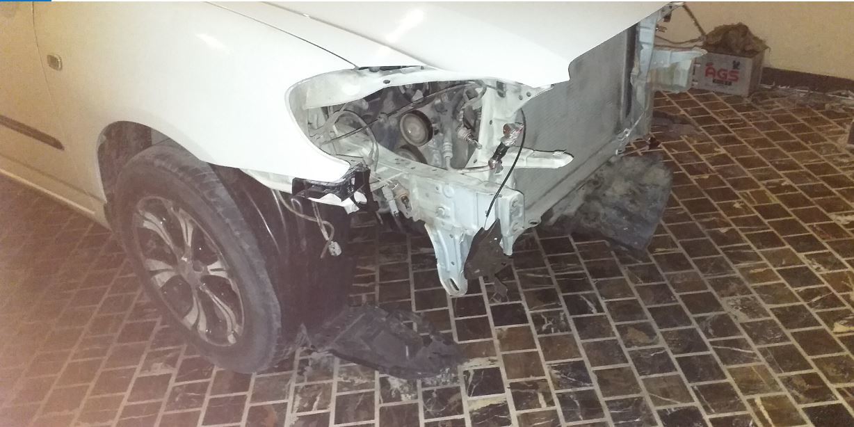

Sir for how much did you get the tail lights for?
A detailed over-haul which we all wish for, I recently bought a 07 xli and learning alot from your thread.
In all a learning for all of us. ---- All the best
Amazing thread brother. I've a 07 2.0D 105k driven. Love the car and learning so much about DIY cleaning from your thread.
4500 PKR , original , not repaired ,,,,,,,
