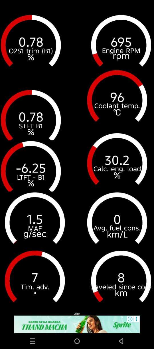

Scan Tool Observations (Latest):
MAF: 1.5 g/sec @ idle → normal.
Timing Advance: 7–8° @ idle, 30°+ @ 2500 RPM → seems active.
Coolant Temp: 96°C → normal.
Engine Load: ~30% @ idle → normal
Fuel Trims: STFT stable, LTFT mildly negative.
Issue: P0012 Returns Despite These Fixes
Experts please support, sharing OBD idle stats Thanks
