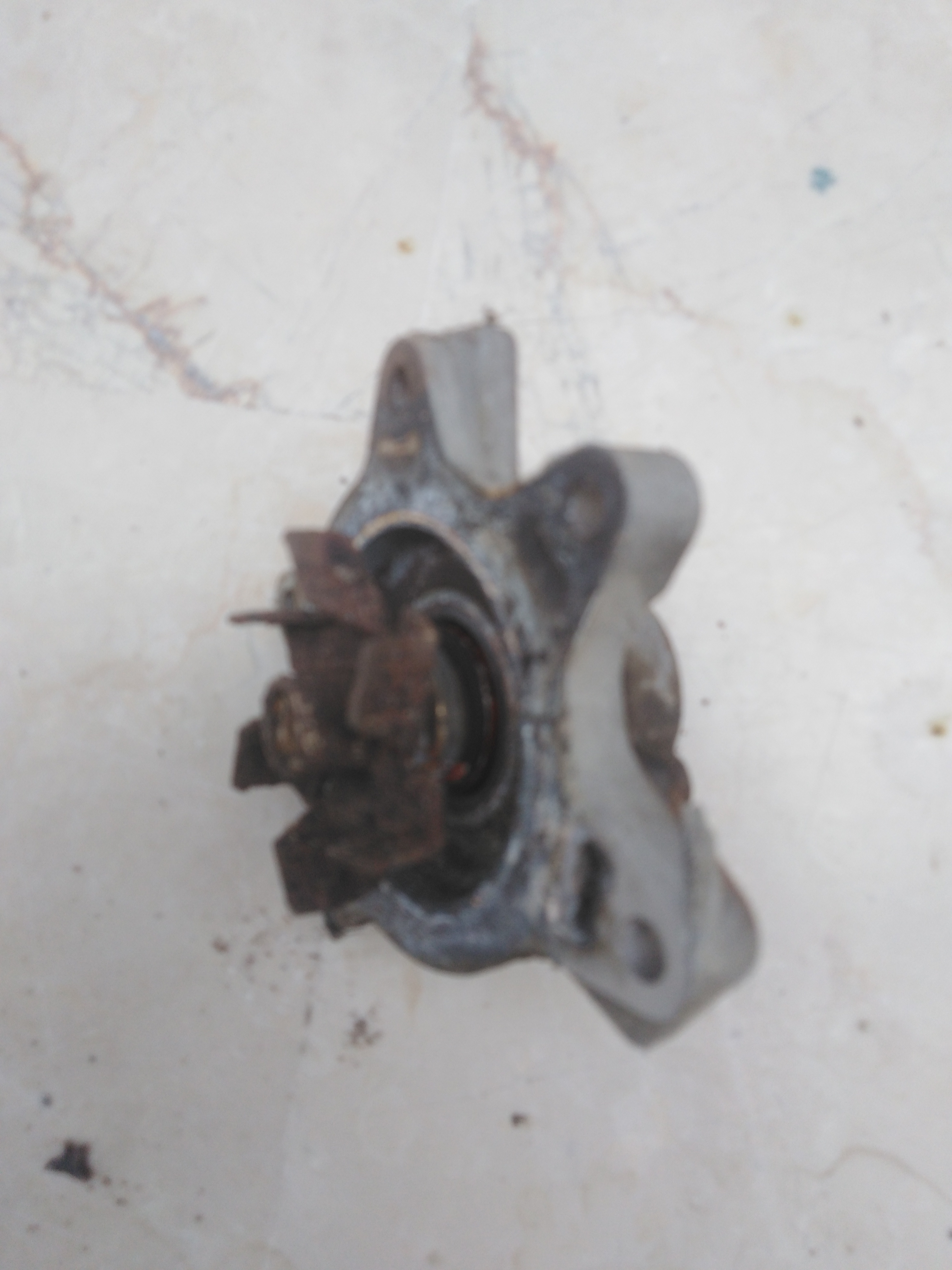

Issue resolved. This is available in local market with size PK1930. however the actual part number is different.
MashaAllah

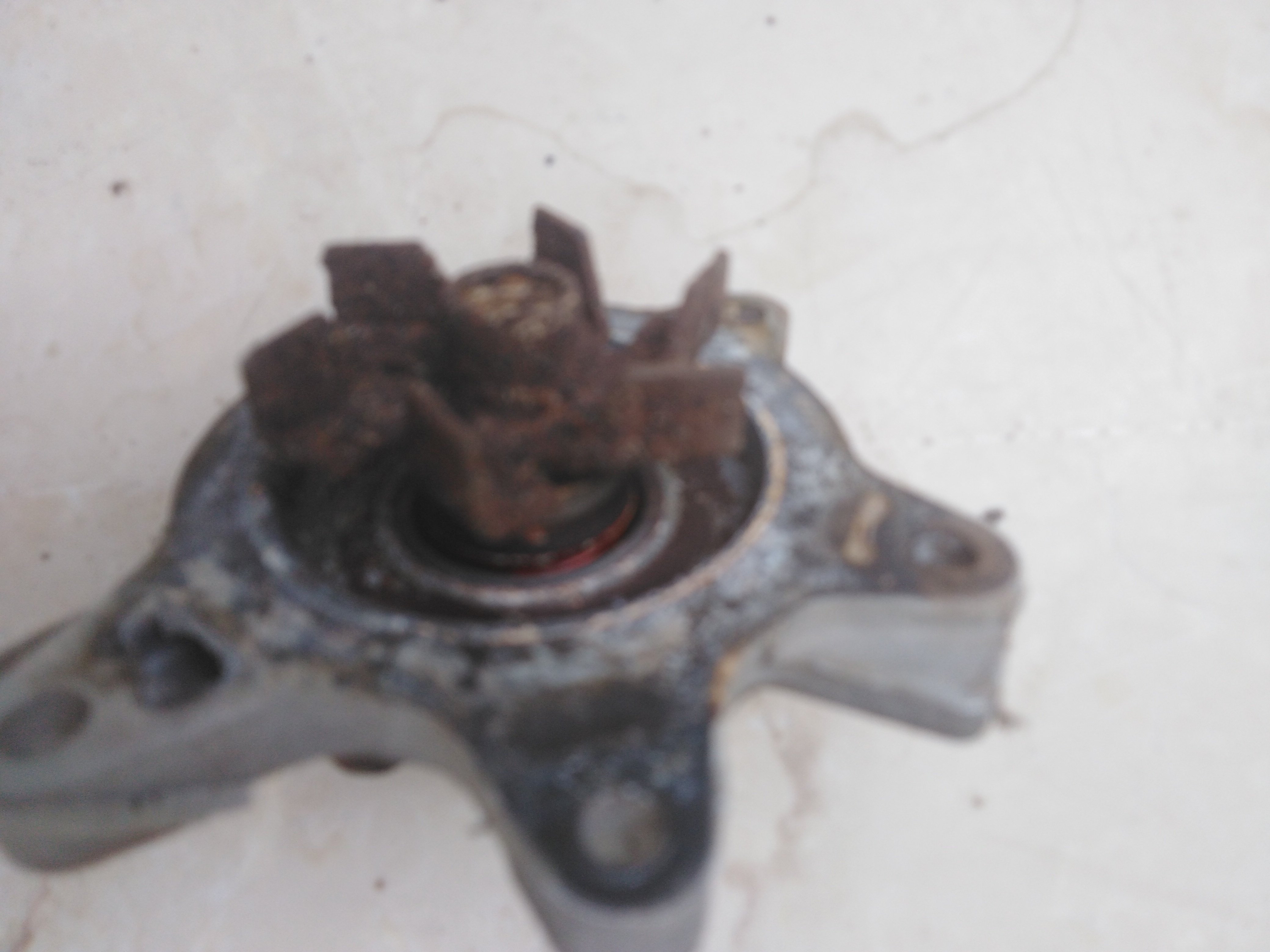

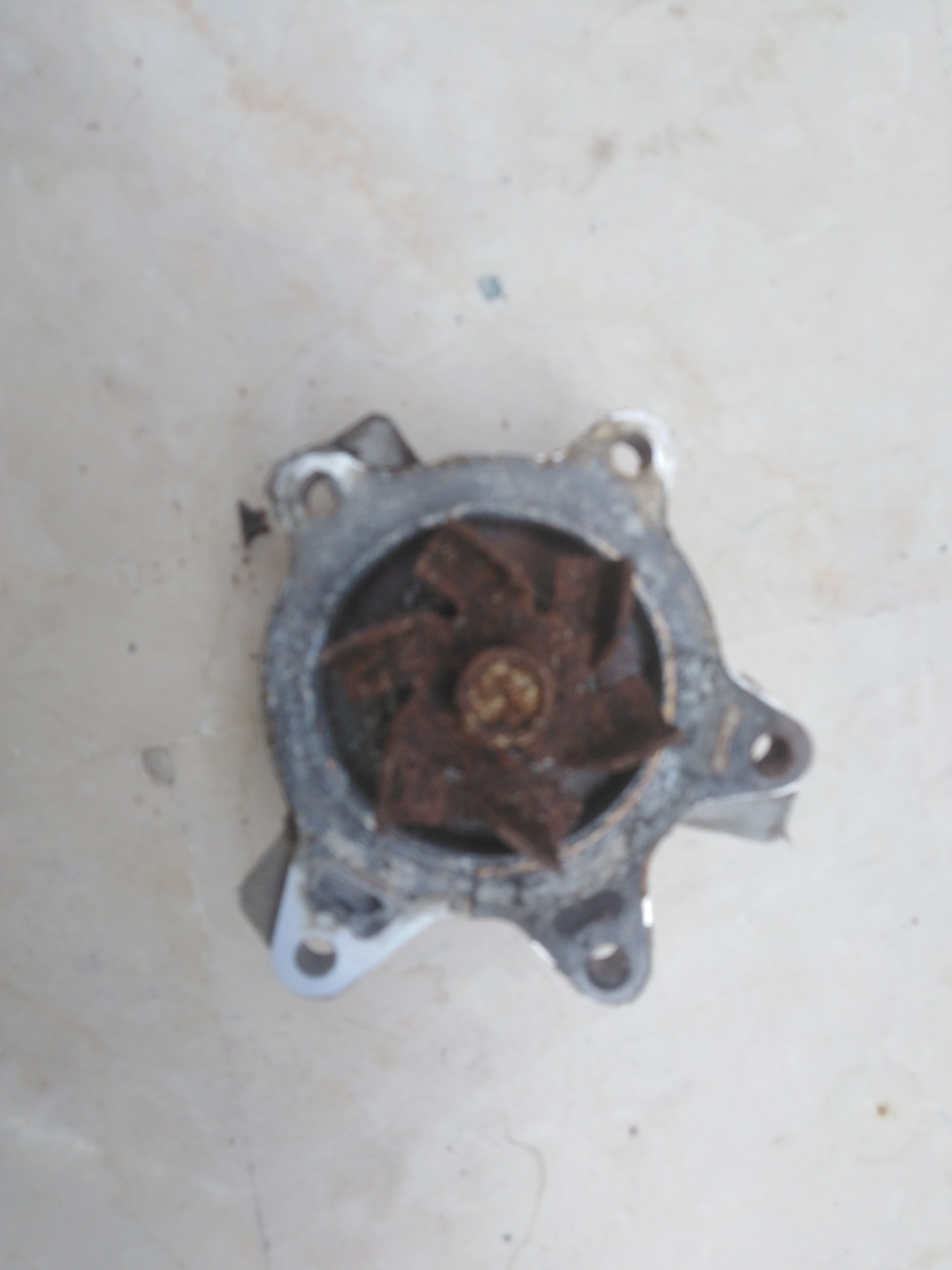

My water pump aka water body stucked during drive and broke the associated pulley.
Pulley was dropped on busy road as my brother was driving at around 60 kmph
So when I went to mechanic, he told to bring Kabuli (term used by mechanics for used parts) pulley, anyways replaced water pump and so total cost:New Toyota water pump(Brand : Aisin) 2,800Used Pulley: 500Mechanic Labor charges: 1,000
