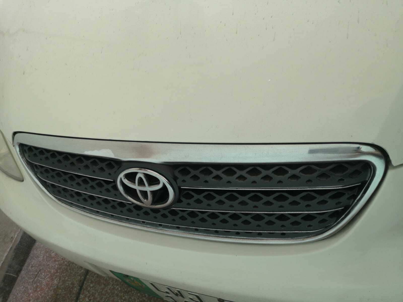

I am facing the same issue since more than a month. I have Corolla SE Saloon Auto 2004. Need an expert opinion/help for its resolution as I am completely frustrated by visiting 5 mechanics/car electricians in Lahore. None of them have been able to resolve it.
