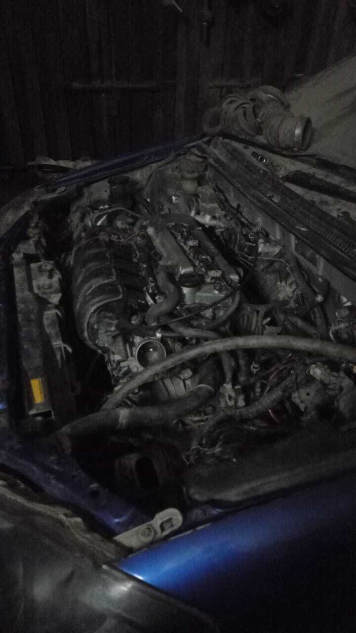

Hey. Just sharing my experience. As we all have dumba community here. And dumba generation is an old generation and with the time wear n tear is increasing. and at some points we all get surprised when things stop working. My dumba's fog lights sufdenly stopped working. And i have started searching the cause. Checked all connectors. Relay. Unplugged n plugged fog lights connector. Found everything was ok just the foglight was not working. Finally i got to know that, there is a tiny fuse box between the wires which connect relay with the battery located behind the battery (tiny black box). One of the wire was loosen up, and was causing issue. And after checking the fuse and fix the wires and little bit cleaning. Foglight started working again properly Alhumdulillah.
If someone get into the same situation and want to fix the issue himself and àlso not that technical like me, should remember this little hack. It might helps to fix the problem. Regards.
