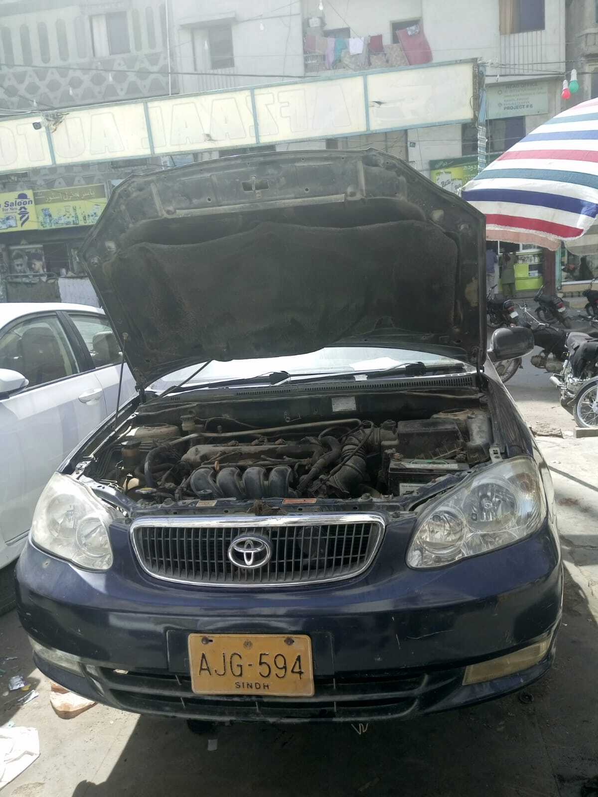

From last 2 weeks, I noticed performance degradation of A/c of my Dumba Corolla so today took it to Bashir Autos, Tariq Road which showed that condenser is leaked very minor plus there were oil (seem selen type) near compressor so they thought it could be seal failure.
Anyhow after opening, when brought in water with pressure, it showed no sign of leakage from compressor but they told that oil was leaking during operation so better to replace seal and associated inside rings too.
