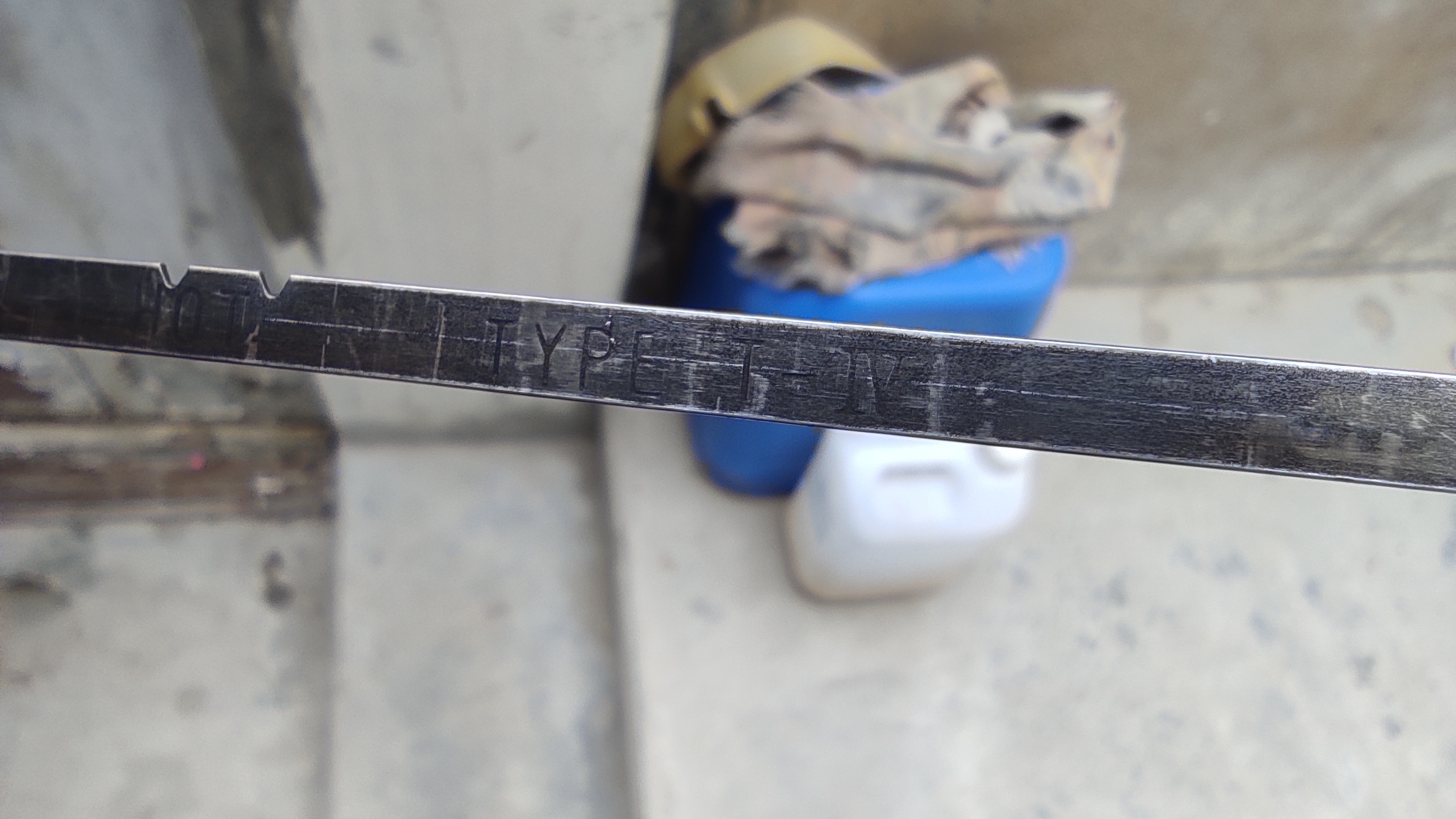

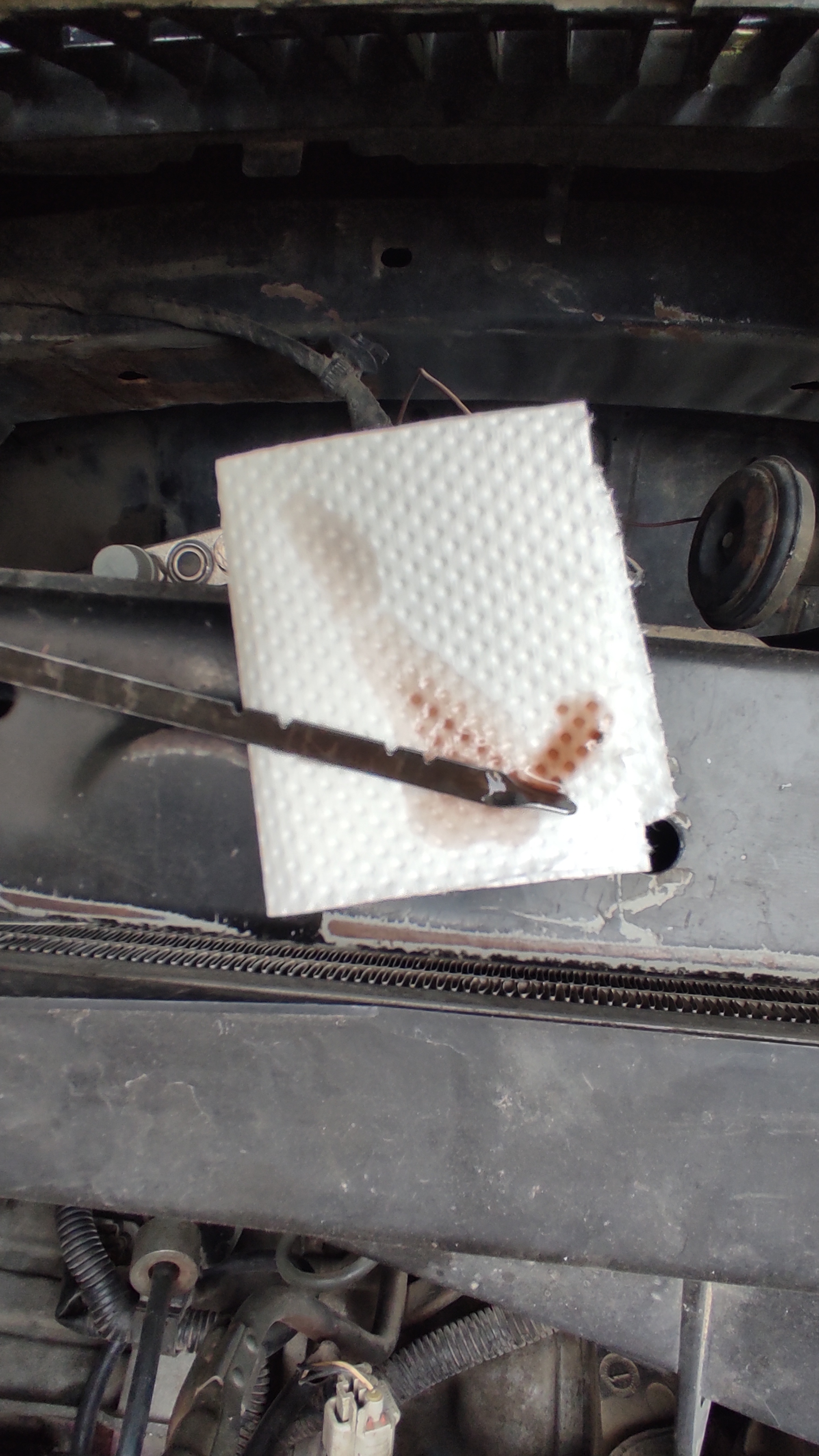

the AT in ur car takes Toyota type IV atf, u can use ATF-WS but better stick to type IV.
watever u do but never pour CVT oil in it.
