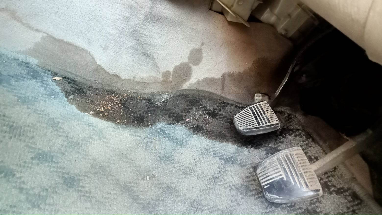

I just noticed the engine of the car is replaced with 1NZFE Japanese 1.5L Assembly only ( although ECU is of 2NZFE)
I just replaced the new Clutch and Pressure Plates (AISIN Japan)
Spark Plugs replaced with Iridium ones DENSO SK20R11 (old ones were not good and they are also Iridium ones)
Replaced Air intake Pipe old ones had cracked from the throttle body side
Replaced Engine Blowpipe
Clean and Service: Throttle body, IAC Valve, MAF, Intake Manifold (stuffed with carbon deposit)
Replace Engine Oil 10w40 Shell with oil filter (previous owner using 20w50, no oil drop or smoke issue vehicle clocked 700KM after oil change )
A little oil is leaking from the passenger side strut shock absorber.
Rear shock absorber rubber buses are not in good shape.
The passenger side rear wheel bearing has some play and makes little noise sometimes.
That is the condition but the problem still exists
the vehicle jerks when I take off the foot from the gas paddle at a slow speed cruising, engine RPM goes below 1000
