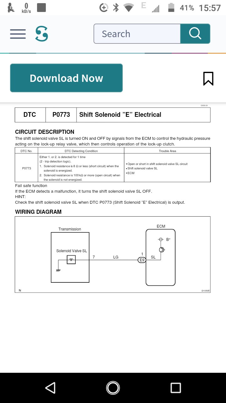

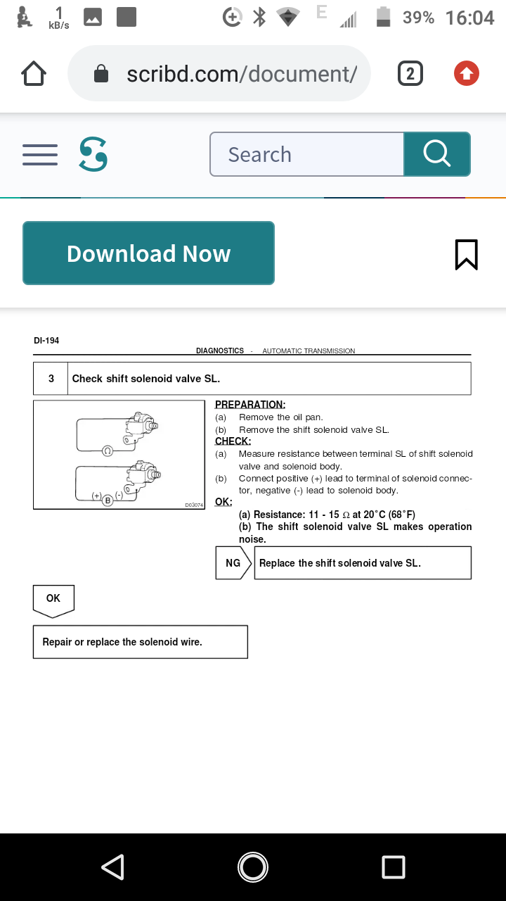

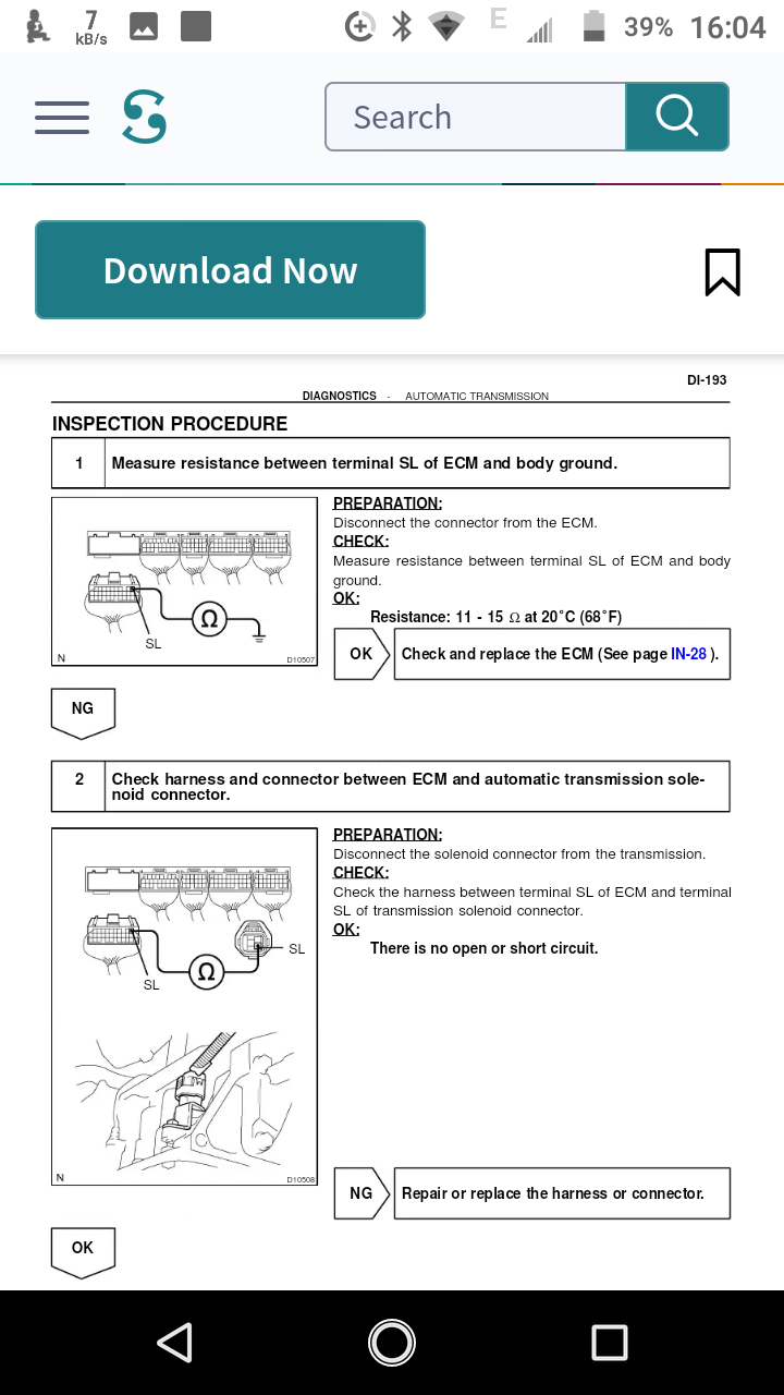

I have found some relevant stuff on the internet to my issue. It is for 4Runner but diagnostic procedure should be similar I guess
this is tcc lockup solenoid error code.
This is quite famous for toyota autoboxes and a pain to solve, remove this solenoid and backflush it.
