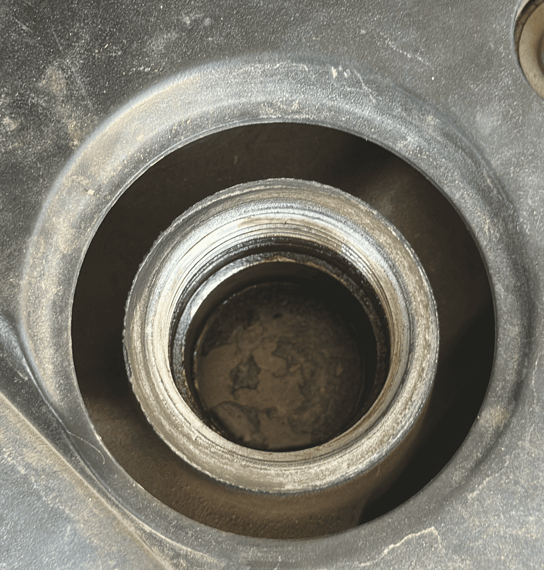

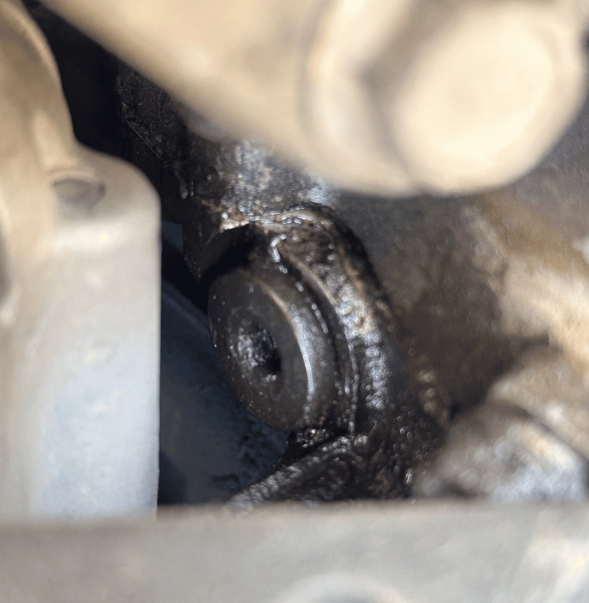

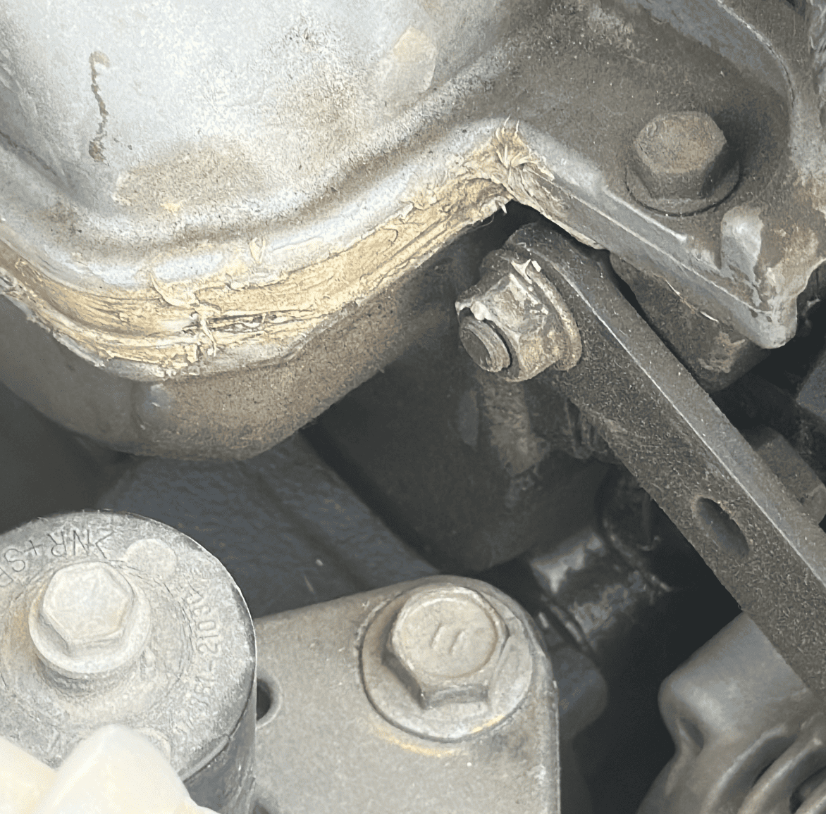

4. Oil Consumption & Leak Issues (2024)
- Recently, I have noticed that the engine is consuming oil more than usual.
- I inspected the engine and found oil leakage near a bolt close to the VVTi sensor.
- Some mechanics suggested that I just keep topping up the oil and continue driving, while others recommended an engine replacement.
- Given the mileage and past repairs, I am confused about whether to rebuild, replace, or just maintain the existing engine.
Images for reference are attached at the end!

- Is the oil consumption issue a sign of serious engine wear, or can it be managed by just topping up oil?
- Could the cold start noise be related to a timing chain tensioner or crankshaft bearing?
- Given the head gasket was once replaced, is a full rebuild worth considering?
- Would a used engine swap be a better long-term solution compared to repairs?
- Any other preventive measures I should take to extend the engine’s life?
- Would love to hear expert opinions from those who have experience with high-mileage 1.3L Corolla engines. Thanks in advance!

PS: The overheating has ever been an issue after the initial head gasket incident , the temperature based on my research is optimal
Oil Leaks Images:
