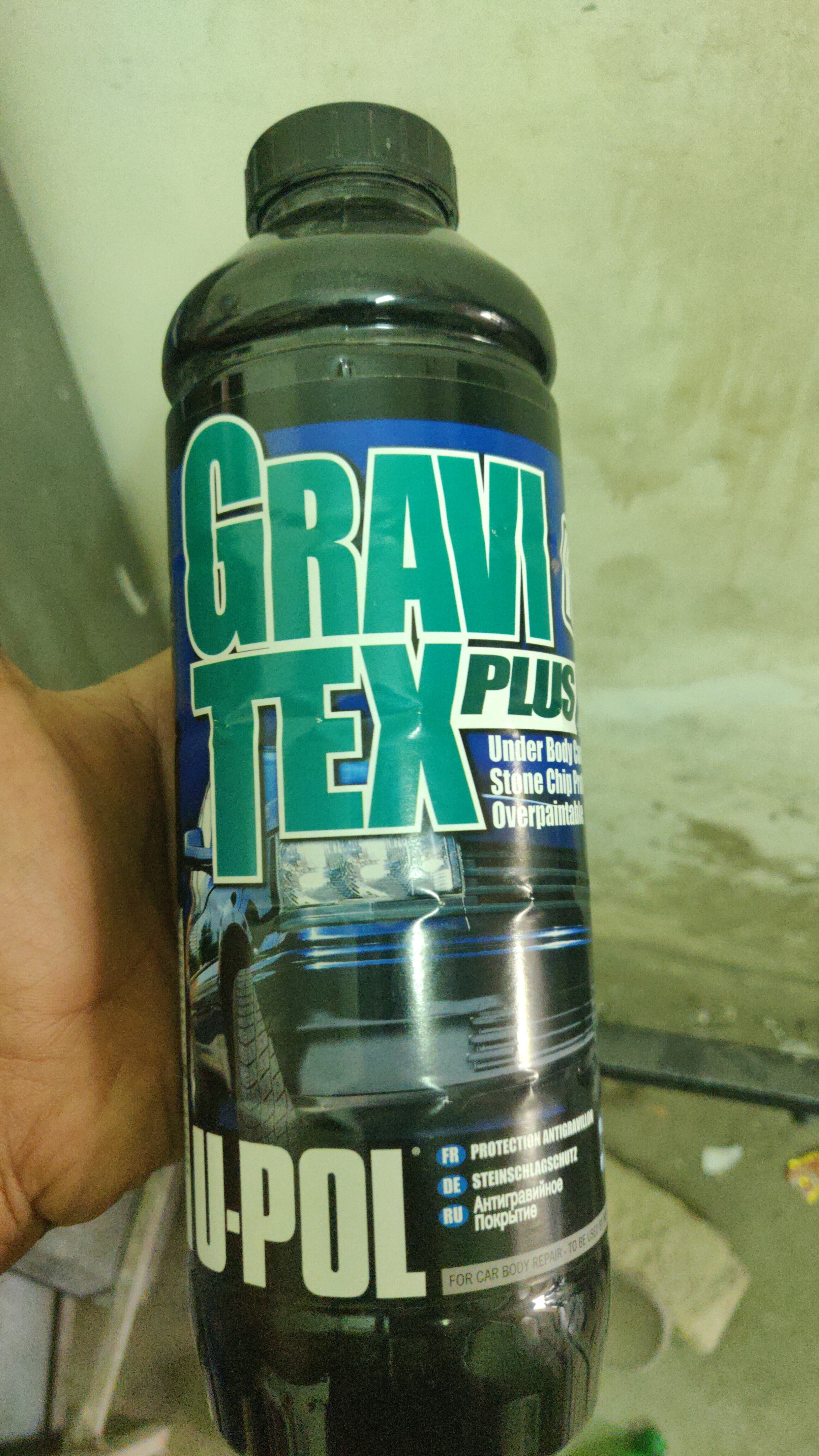

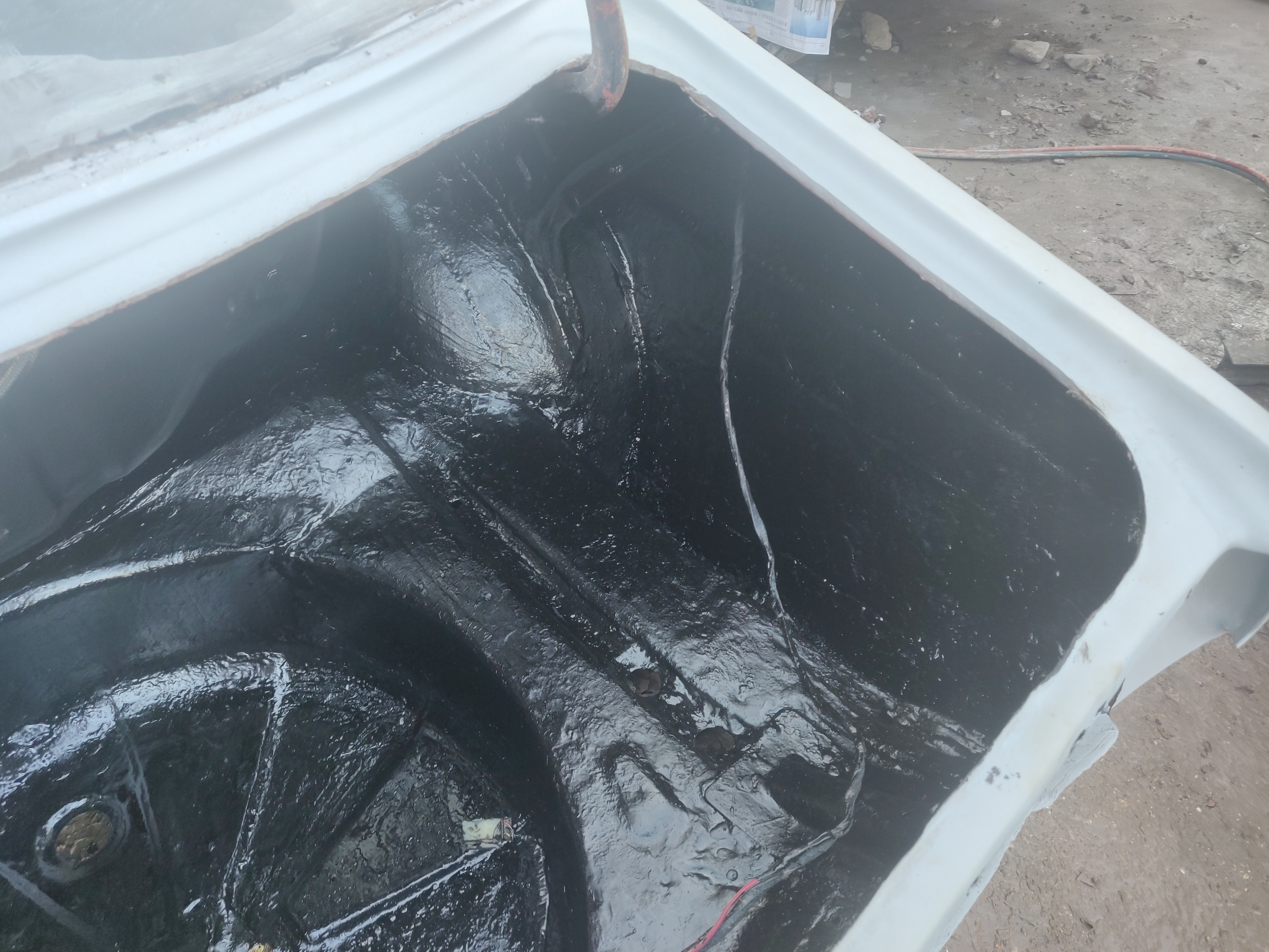

is that bitumen coating on floor & in the trunk? please guide
Its undercoating chemical rubber based..

Good question, I am also confused about using bitumen (Daamar) in my cars...... specially under the fenders and on the floors. Also I noticed that the inner side of the roof is coated black for this car.
Damar is useless I have tried it 2-3 times over thr past years and it tends to come off, i have experimented it by using in different ways but useless. This time i have used undercoating rubber based and it is perfect, the roof is also painted black, it was covered with red oxide and then paint coat in order to avoid any rust to appear from inside which will be hidden underneath the fabric.. lets hope for the best!!
Hmm, I was also not having good feeling going for Bitumen (Daamar) as I had my serious doubts about its bonding with the metal surface.
What is the cost of this bottle and roughly how much surface coverage you experienced?
Hi 1600 per bottle mixed with petrol did 4 doors in one bottle but i had used thick coat, used 4 bottles in total. Can increase the coverage area if petrol is mixed in different ratio.

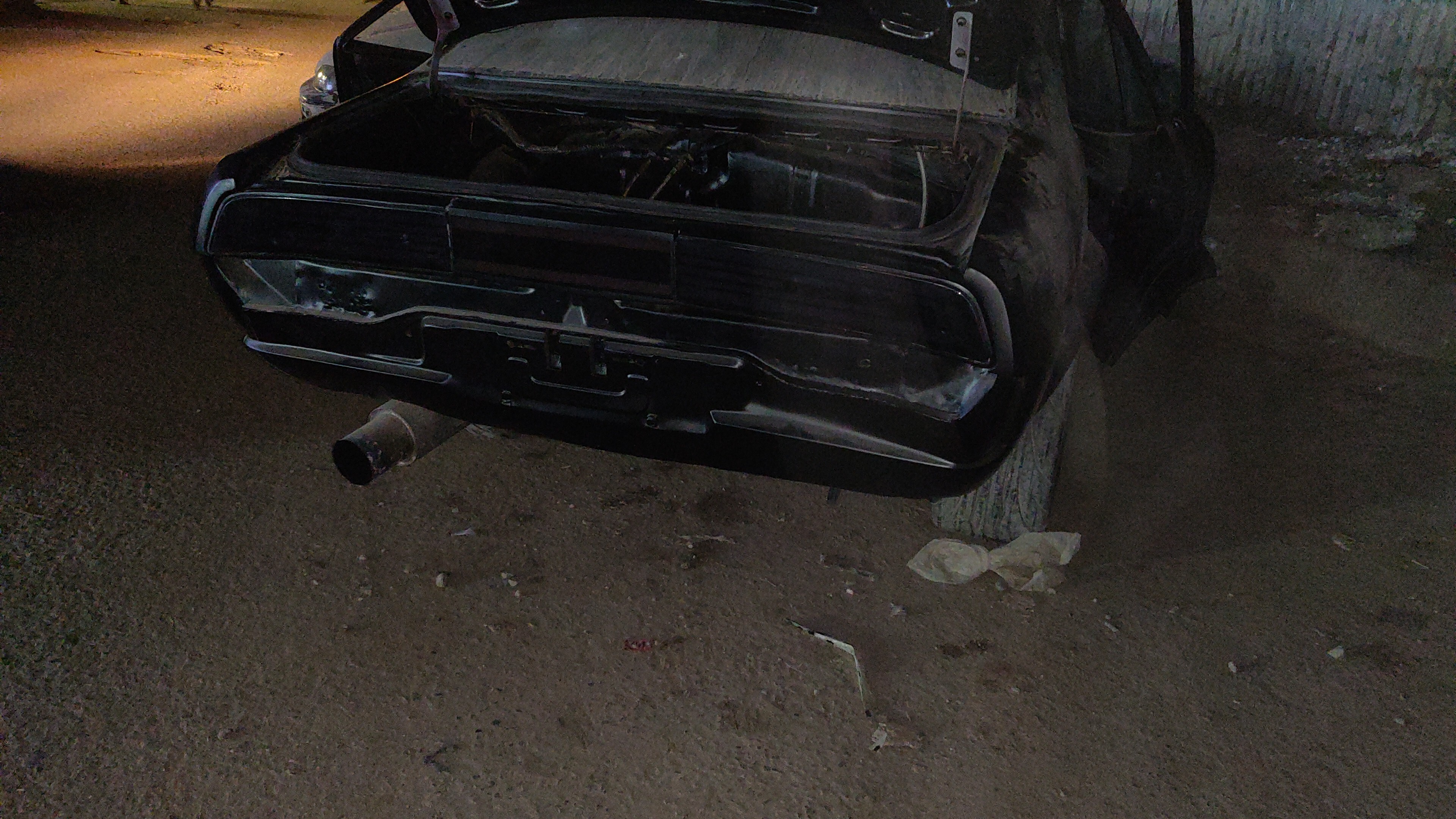

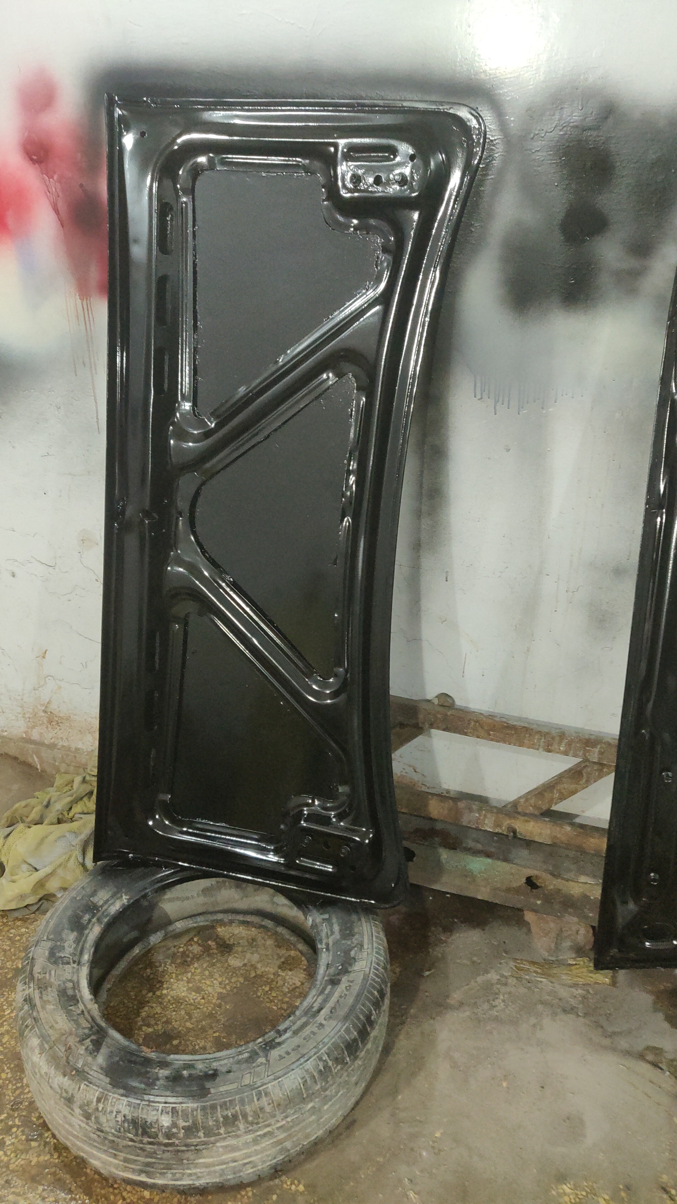

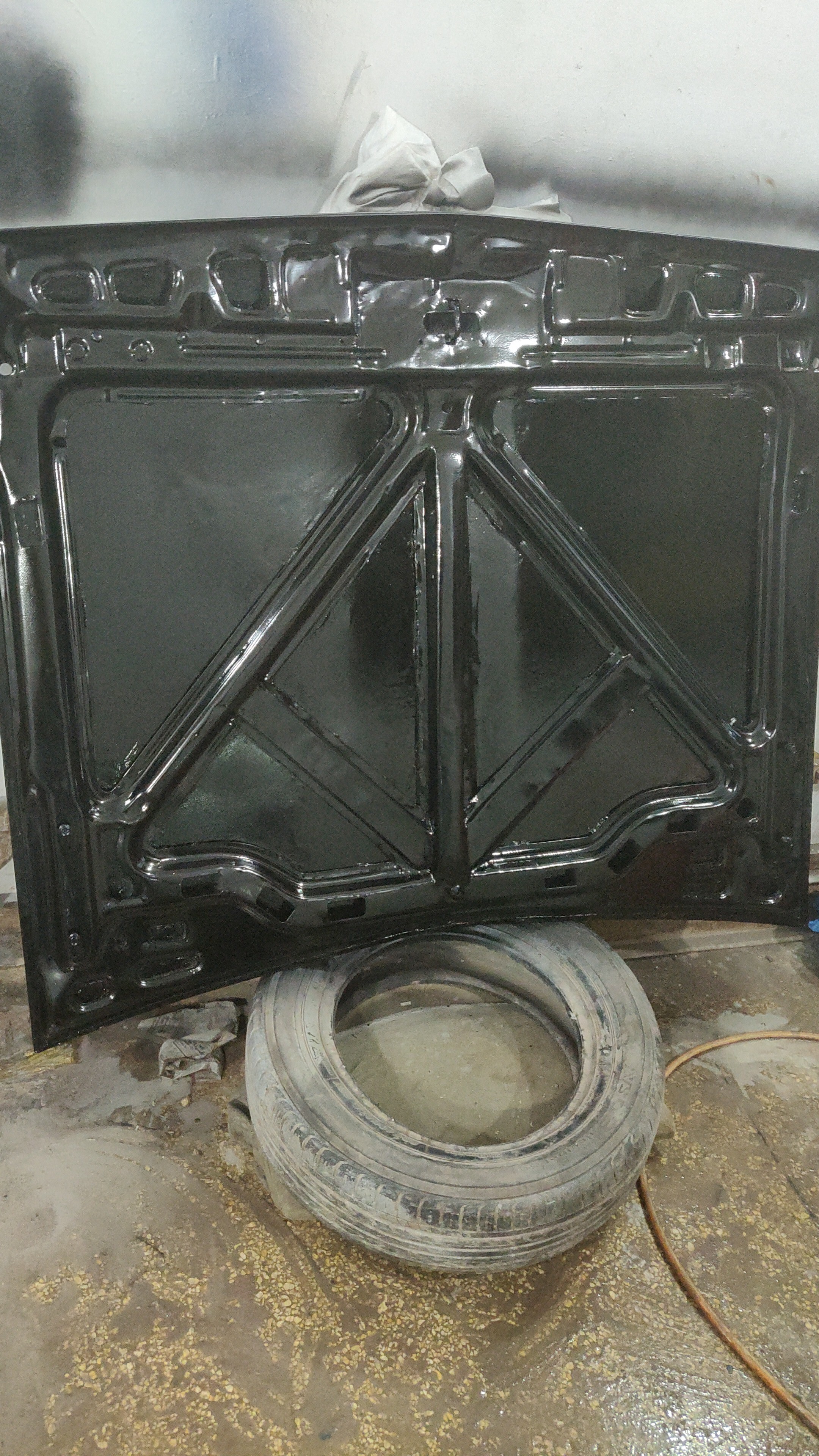

Undercoating done
color?
Lemme finish the interior

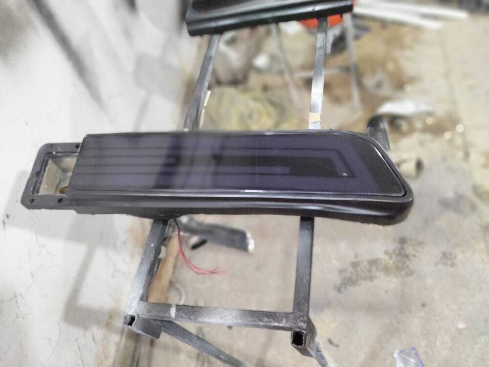

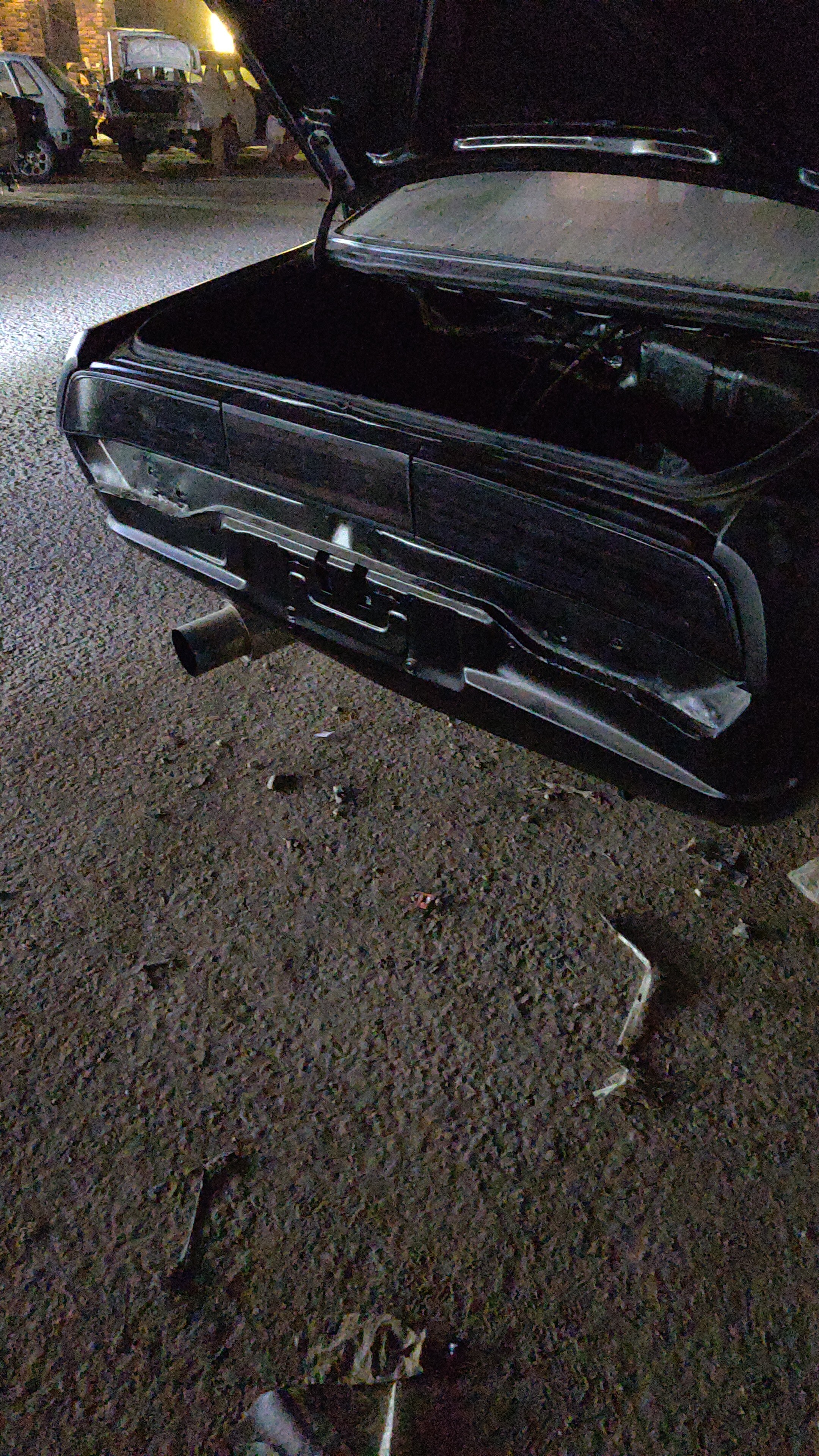

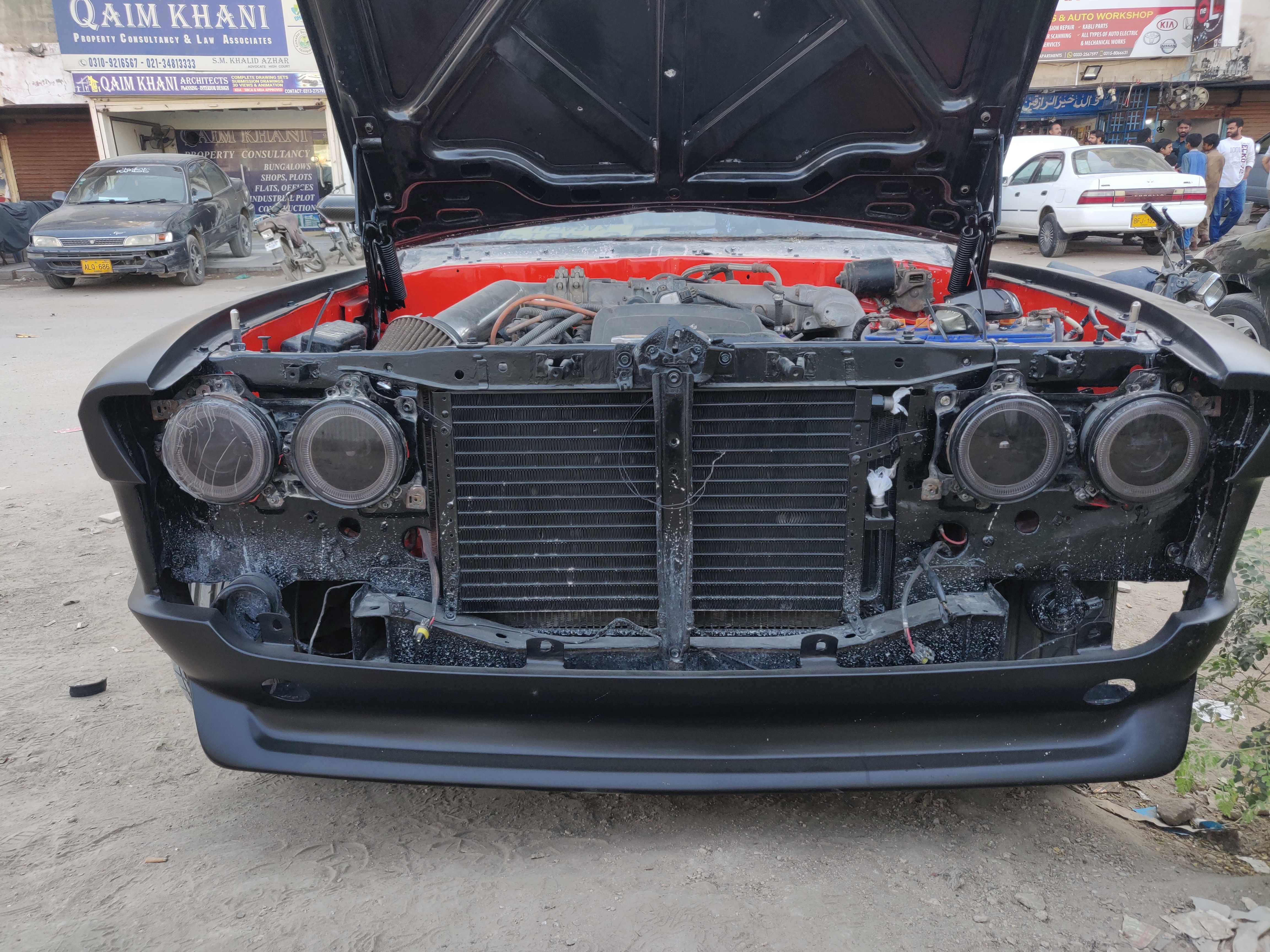

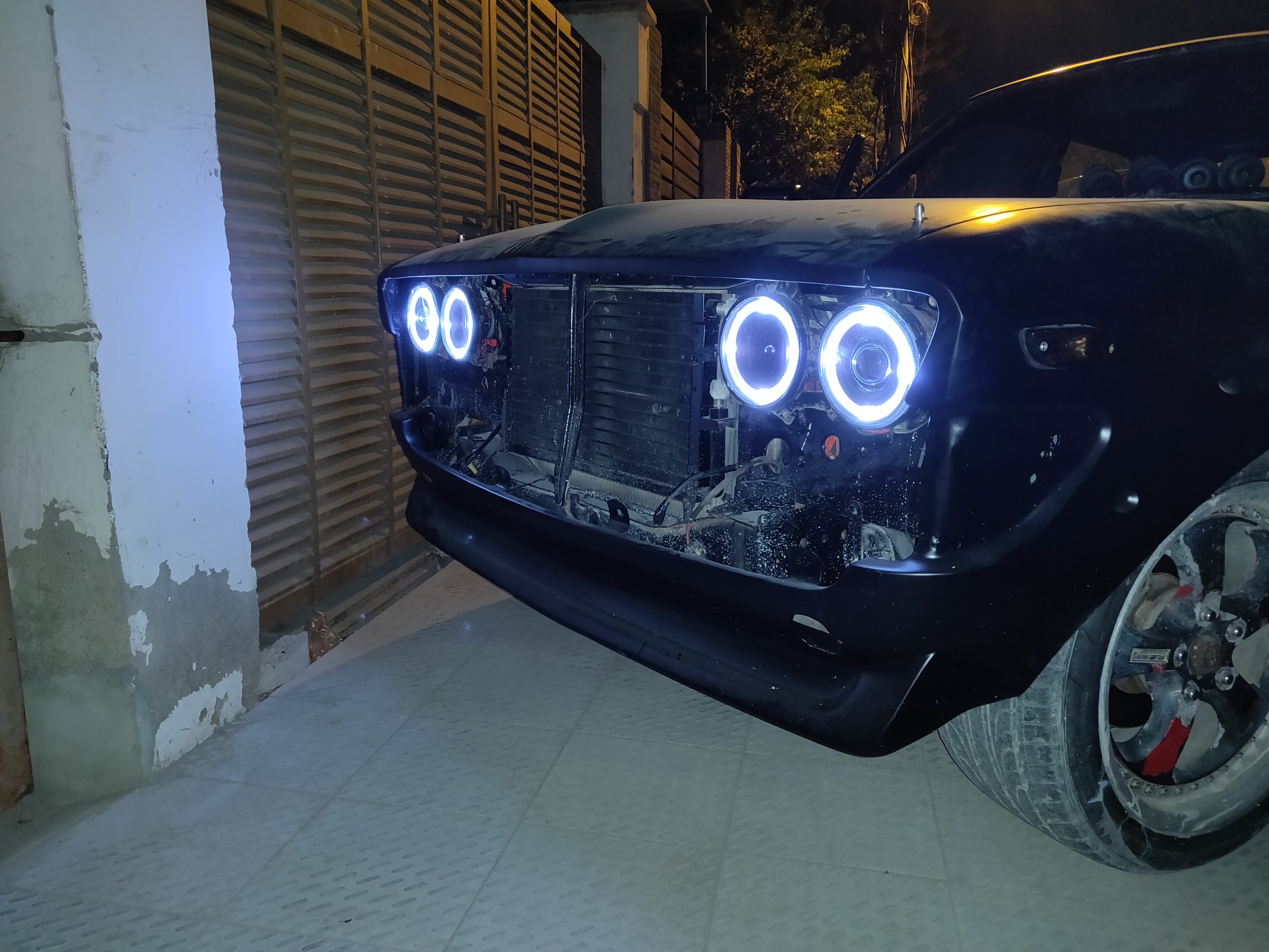

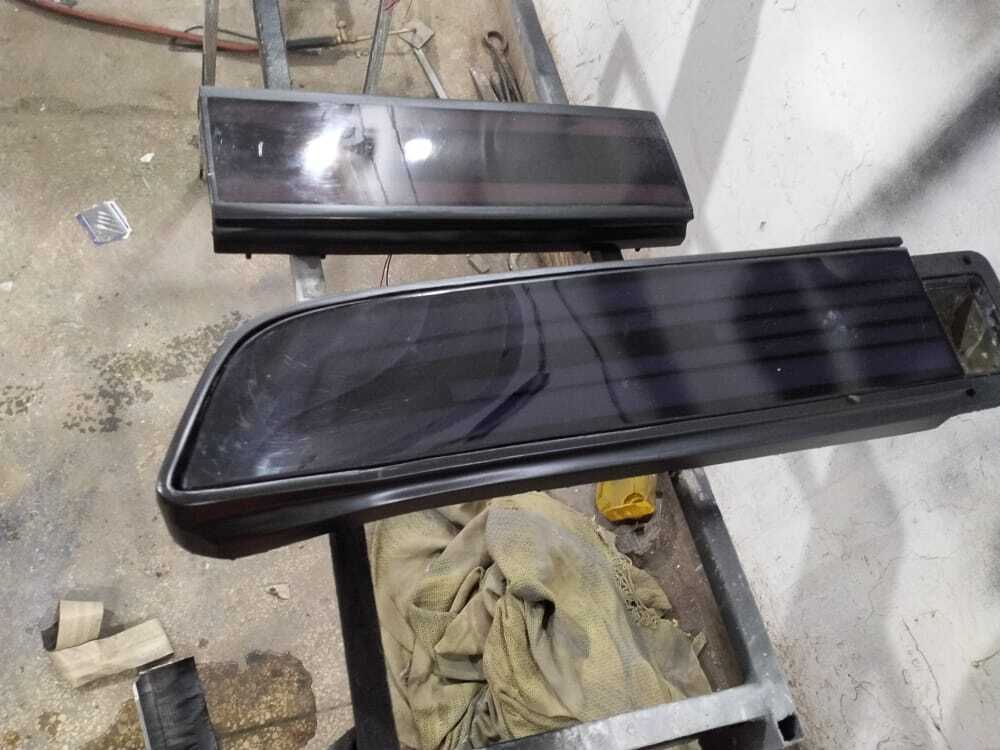

Masha ALLAHUPGRADED FRONT HEADLIGHTS ORIGINAL BMW UPGRADED TAIL LIGHTUPGRADED front DRL

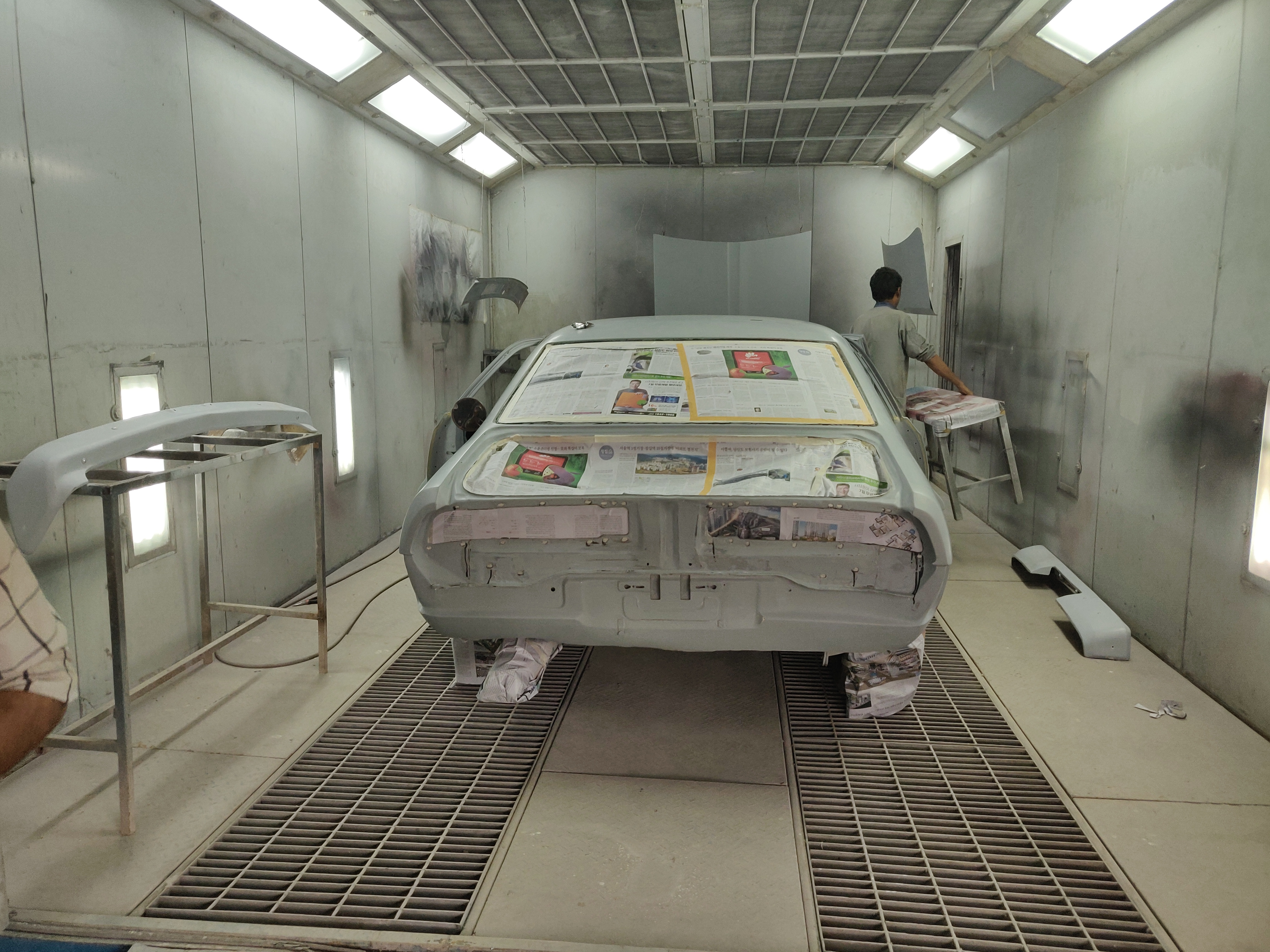

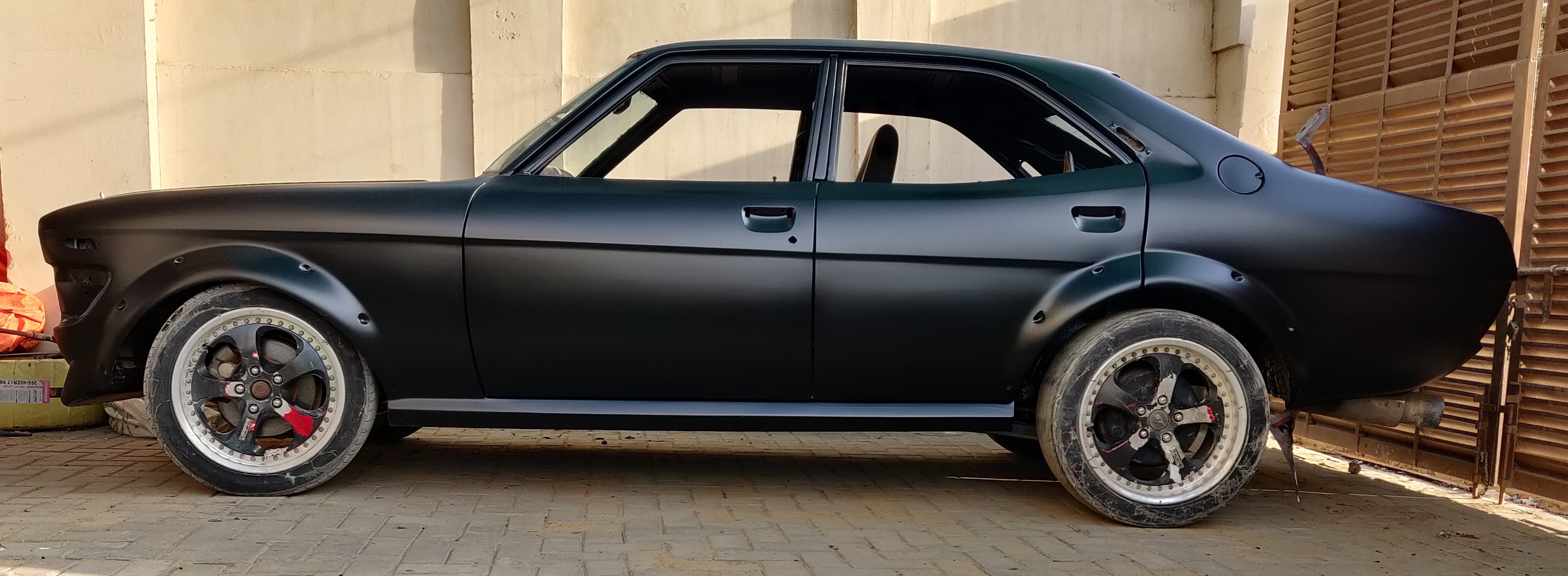

MASHA Allah car colour came out very nice took me 3 weeka in order to make this colour, this is satin finish scratch resistance paint.. ecu busted, power steering lines got damaged, lol even after checking everything shit will happen :).
