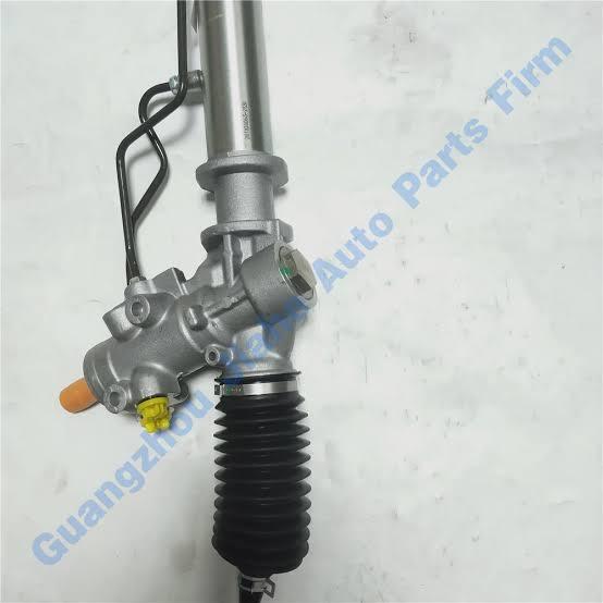

What do u mean by valve body brother ?
Yes i know it's steering rack did u change this
This thing on rack which has twol little pipes
Ok brother m unable to understand its my fault ️ anyway i would like ti suggest u to use good quality ATF warco or worco is not good for assembly health and seals as well
Yes I didn't used warco it was of other company.Can,t remember it's name
