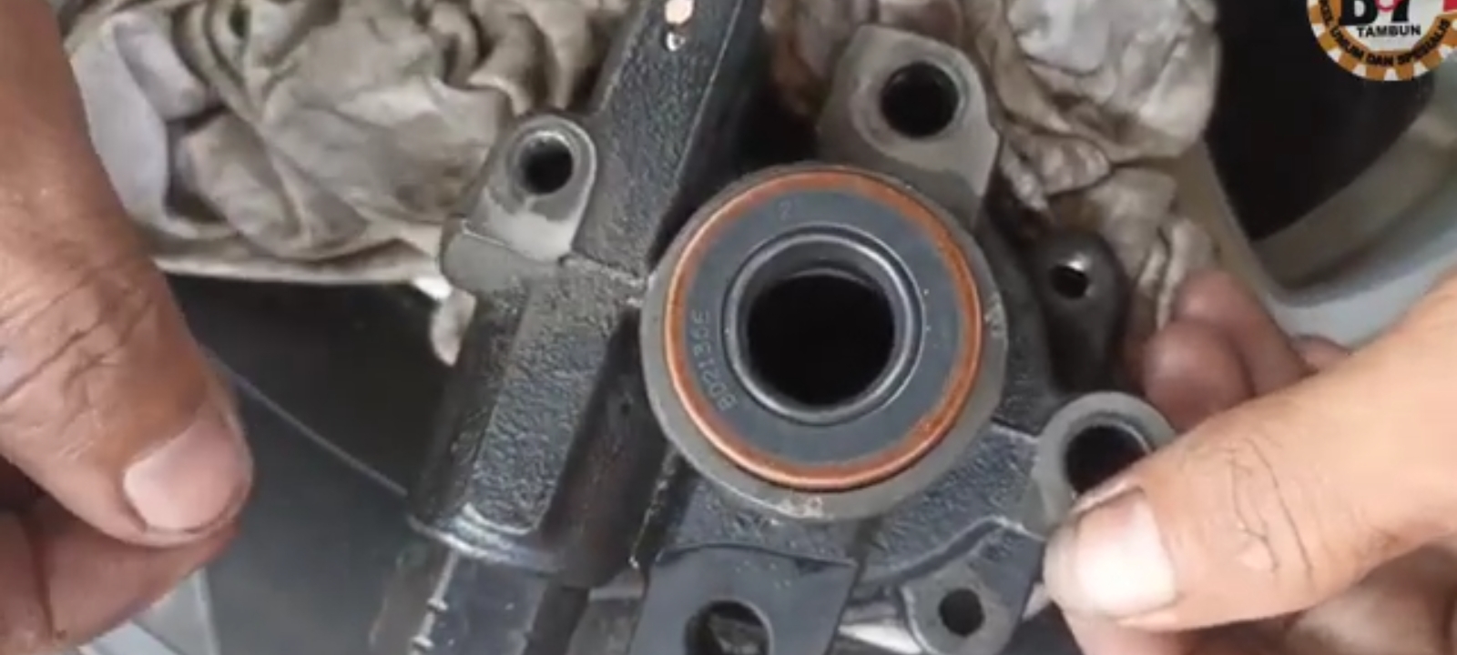

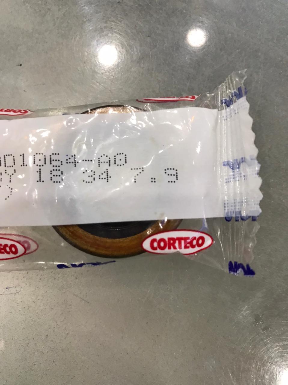

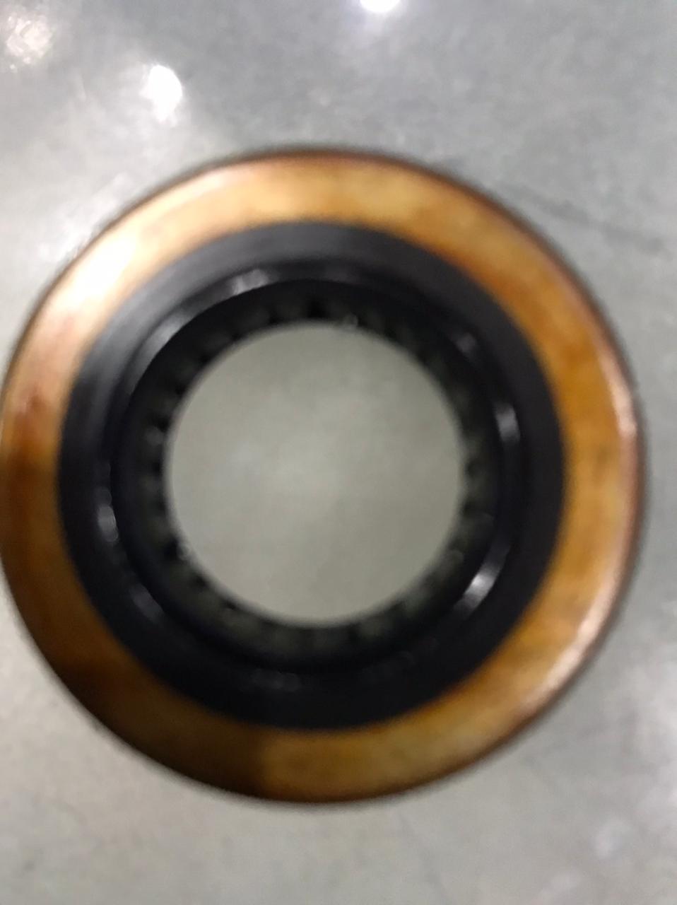

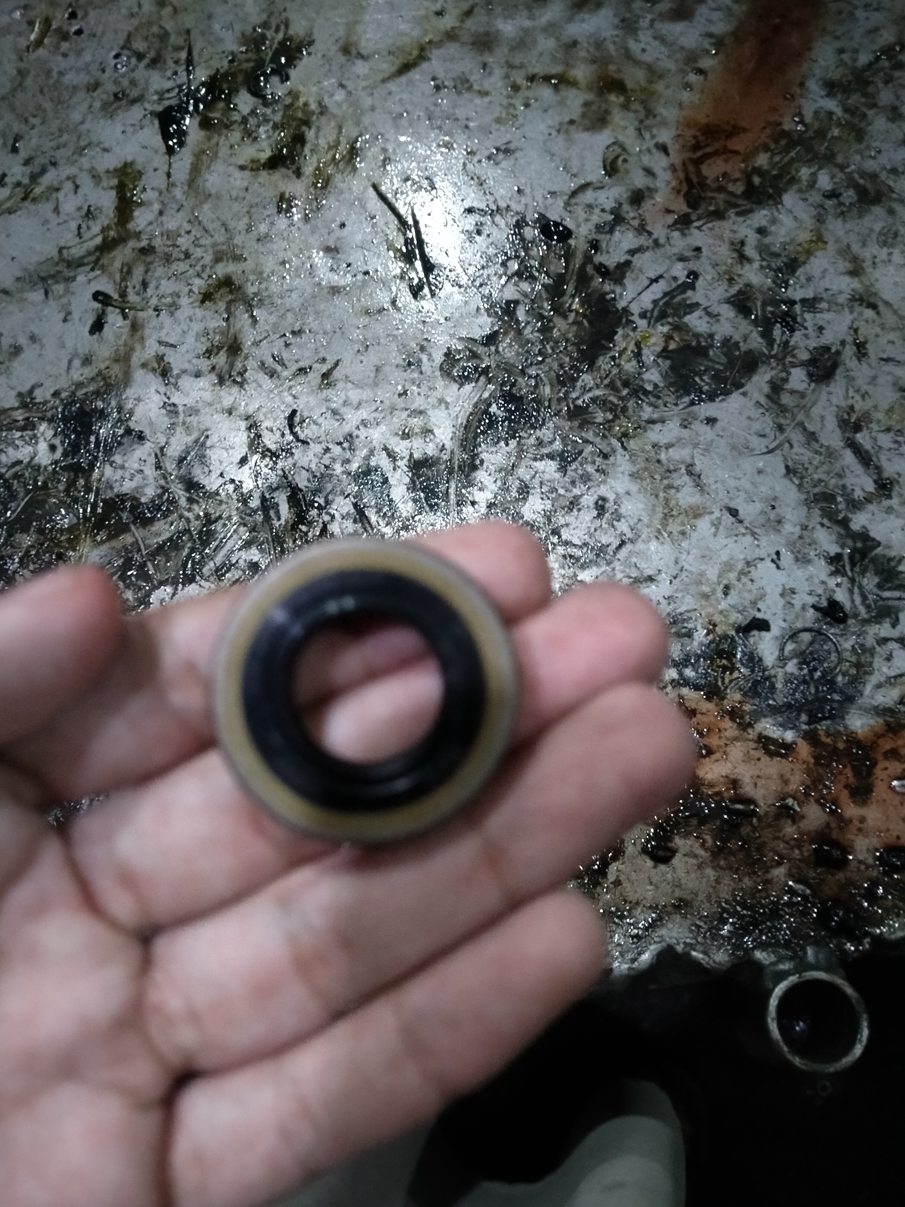

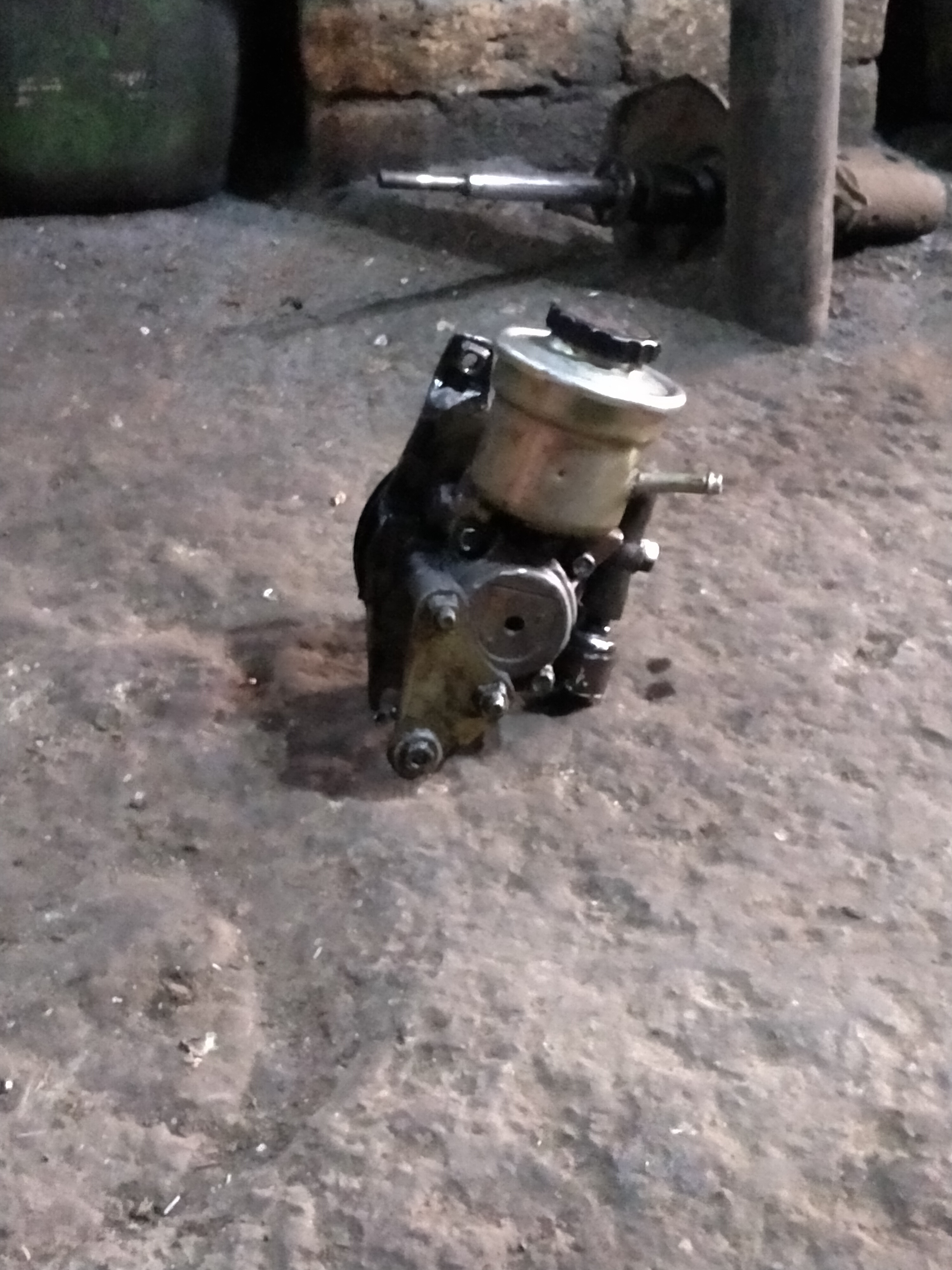

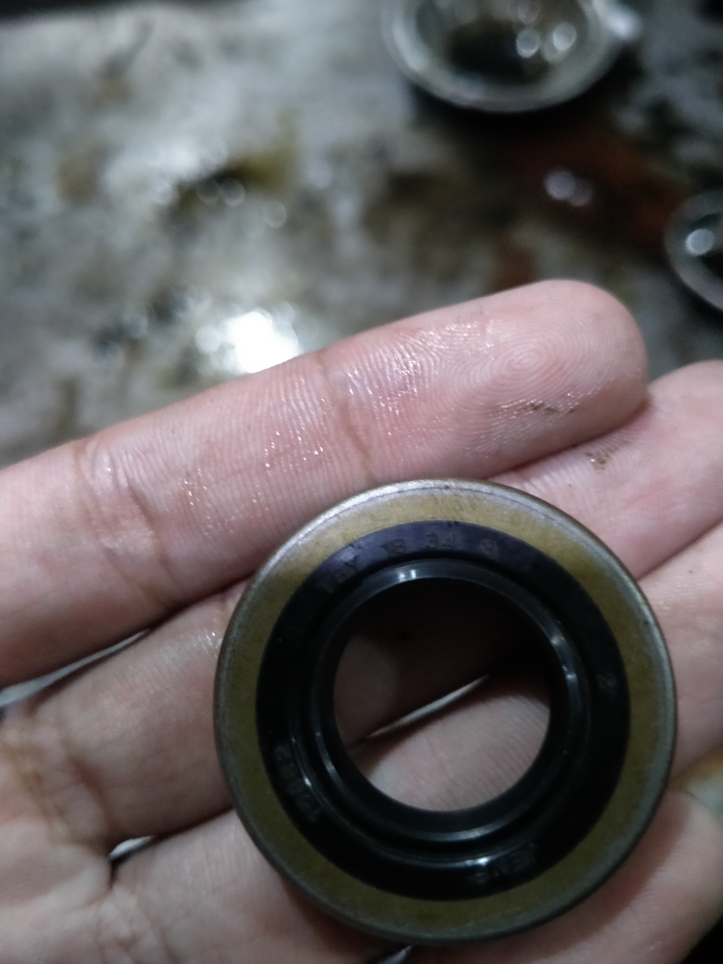

U have to match the seal with the stock one which is inside the Power pump bro
Did u replaced the seal behind the pulley of power steering pump which is called shaft seal.or was it im other location
Yes
Yes this was changed by the mechanic n after that Alhamdolillah no leak by the way how much u paid for this seal
I haven't bought it yet should be around 3-400.Wanted to confirm before doing repair.Thanks for help bro.
Ur welcome brother yes it should b around 300 to 500 it will stop the leaking from power steering pump . Some ppl told me that if ut worried from tje leakage u can get it convert from hps to eps so if ur power steering rack is also weak then I would suggest u to get information about EpS
I will try to get it fixed otherwise eps is much better than this hps which is always a hassle.No oil no tension.
Yes its better but for some reasons ppl like me stick with hps
What r the updates after changing the seal problem solved ,,,?
Seems like it.Because due to this seal power steering pump was covered with oil.And below the pump area was also gunked up.Pump was cleaned with kerosine.Then seal was changed.Machinist said that seals with age become hard and cause leaks.After seal replacement steering feels smooth.Will observe oil level and update in few days.For now it's not leaking.
