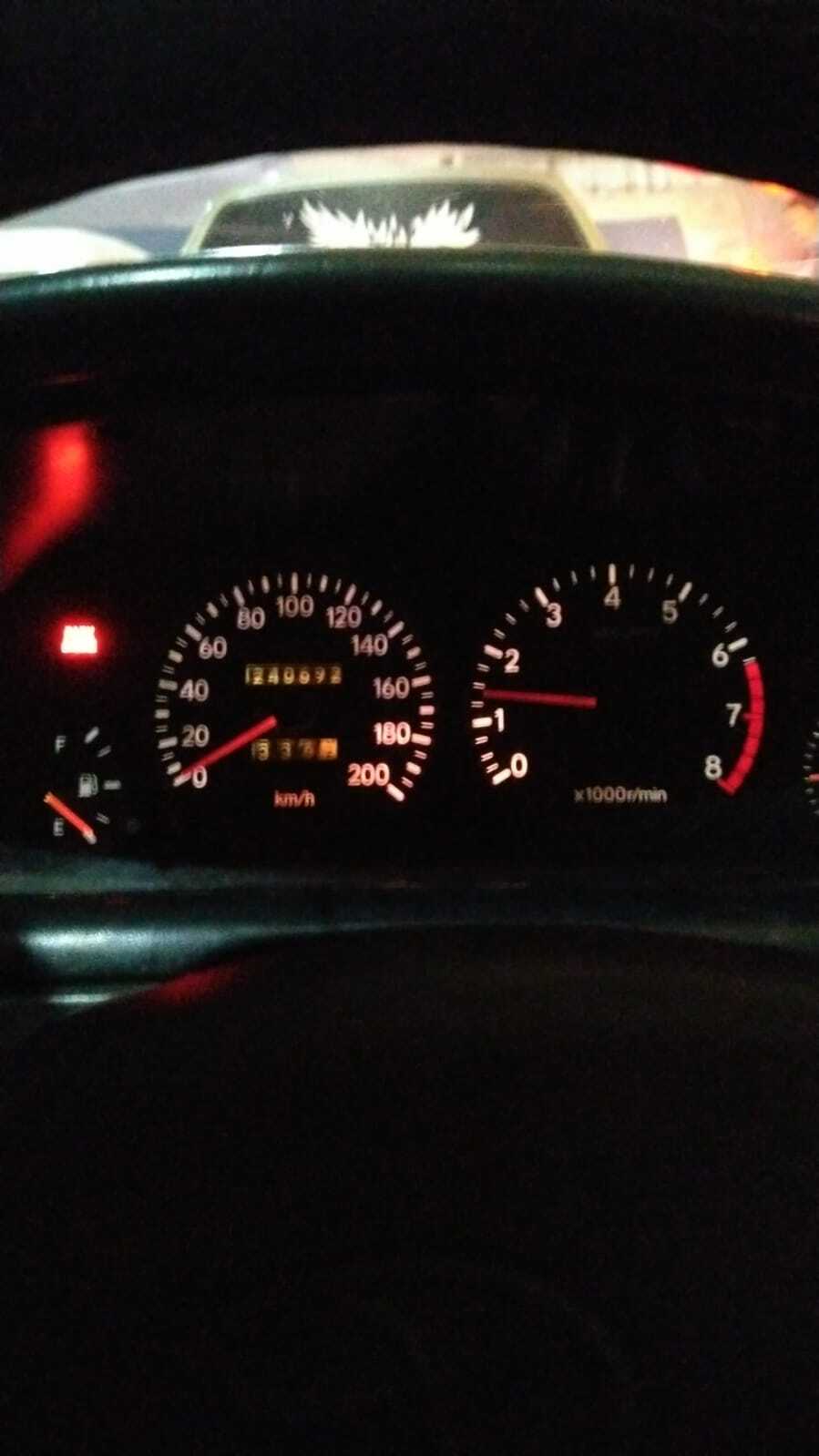

Hard to say for sure; looks ok. you may have downshifted just as you took the pic, the car may not have been on level road.
Road was little steep

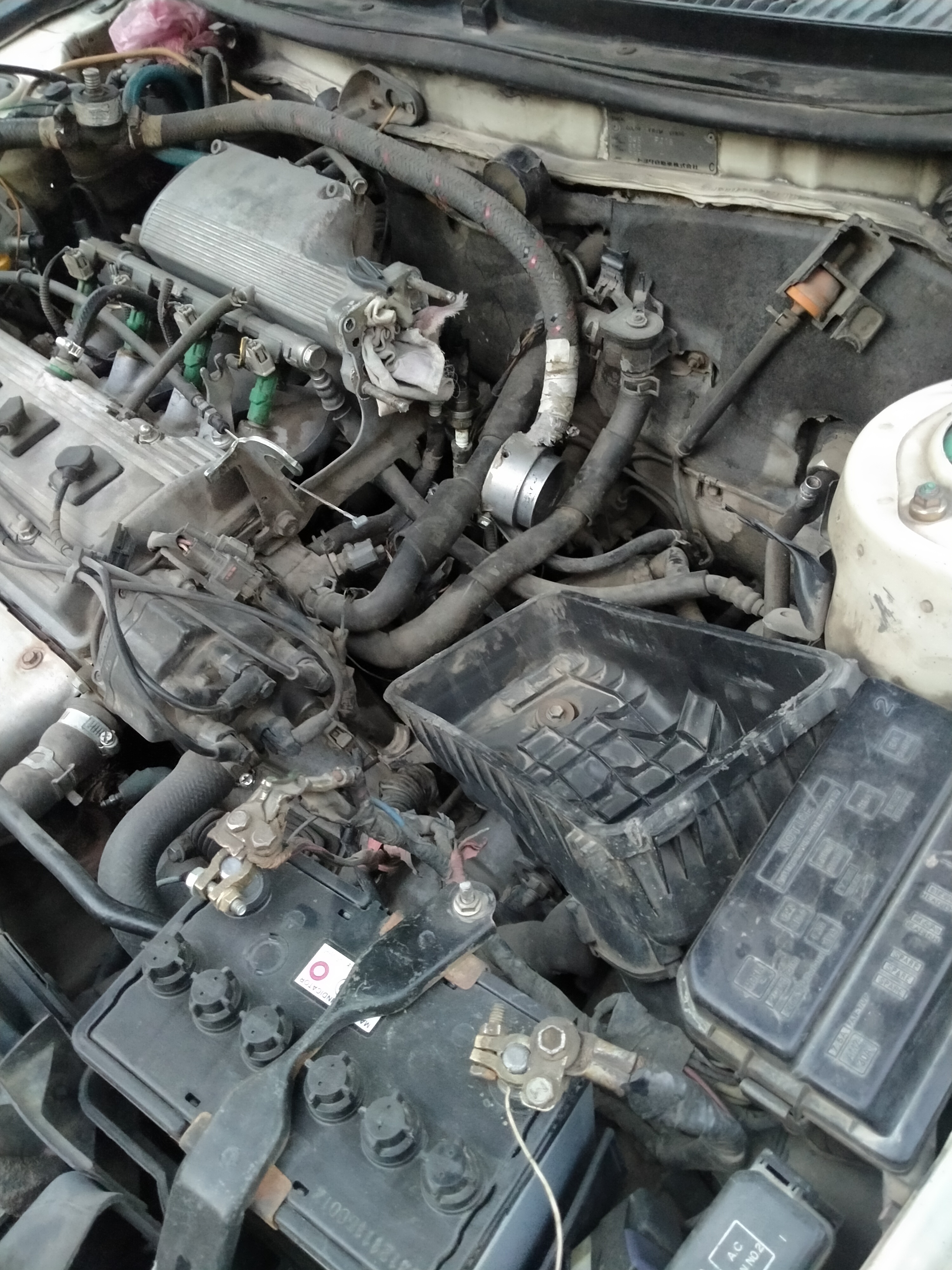

Assalamualaikum how r u bro.Today got cleaning of throttle body and iacv.After this rpm is high at idle.Mechanic said it will be normal after little driving?
Wailaikum AssalamALLAH ka shukr how are you?Retard the iacv.
U mean adjust it's position? From left to right?
Yes. it can rotate few degree.
I disconnected it's grip still rpm was high.I think it's accelerater cable is adjusted wrong
Did he messed with the idle screw?
Where is idle screw?
On the throttle body. There's also a screw on which the level rests check that as well.Also check the vacuum line and the cable adjustment.
Tomorrow I will take it to mechanic.Now too much tired.Mechanic will do it in a minute while I will just goof around
Just ask him to revert back what he did.
Ok thanks

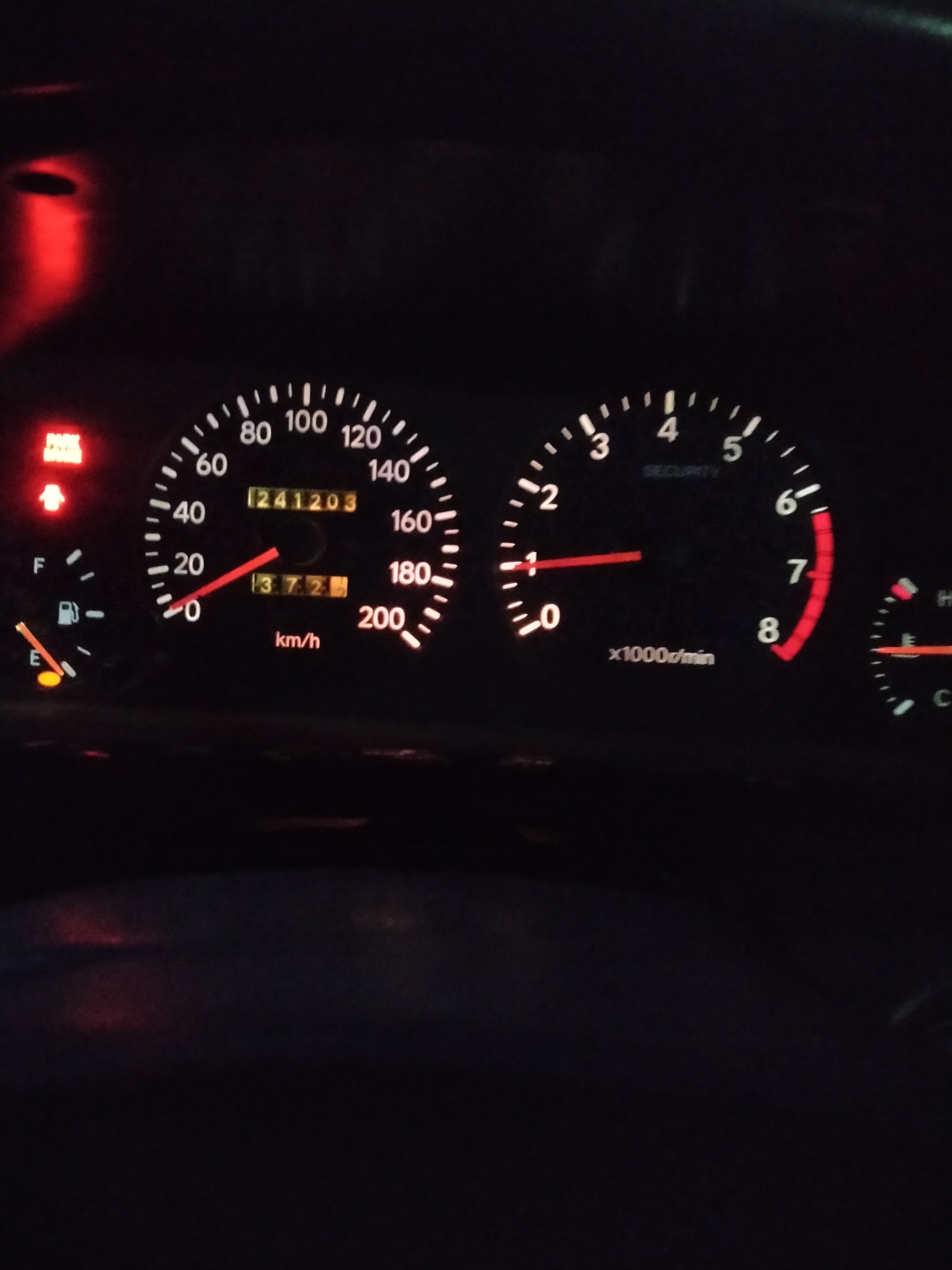

Should be 850-900 when warm.
It's almost 1k.car is tuned on cng
Did you retard the distributor ?
The cng guy did it's setting with poyo oil.3 me dum 4 me gum.
