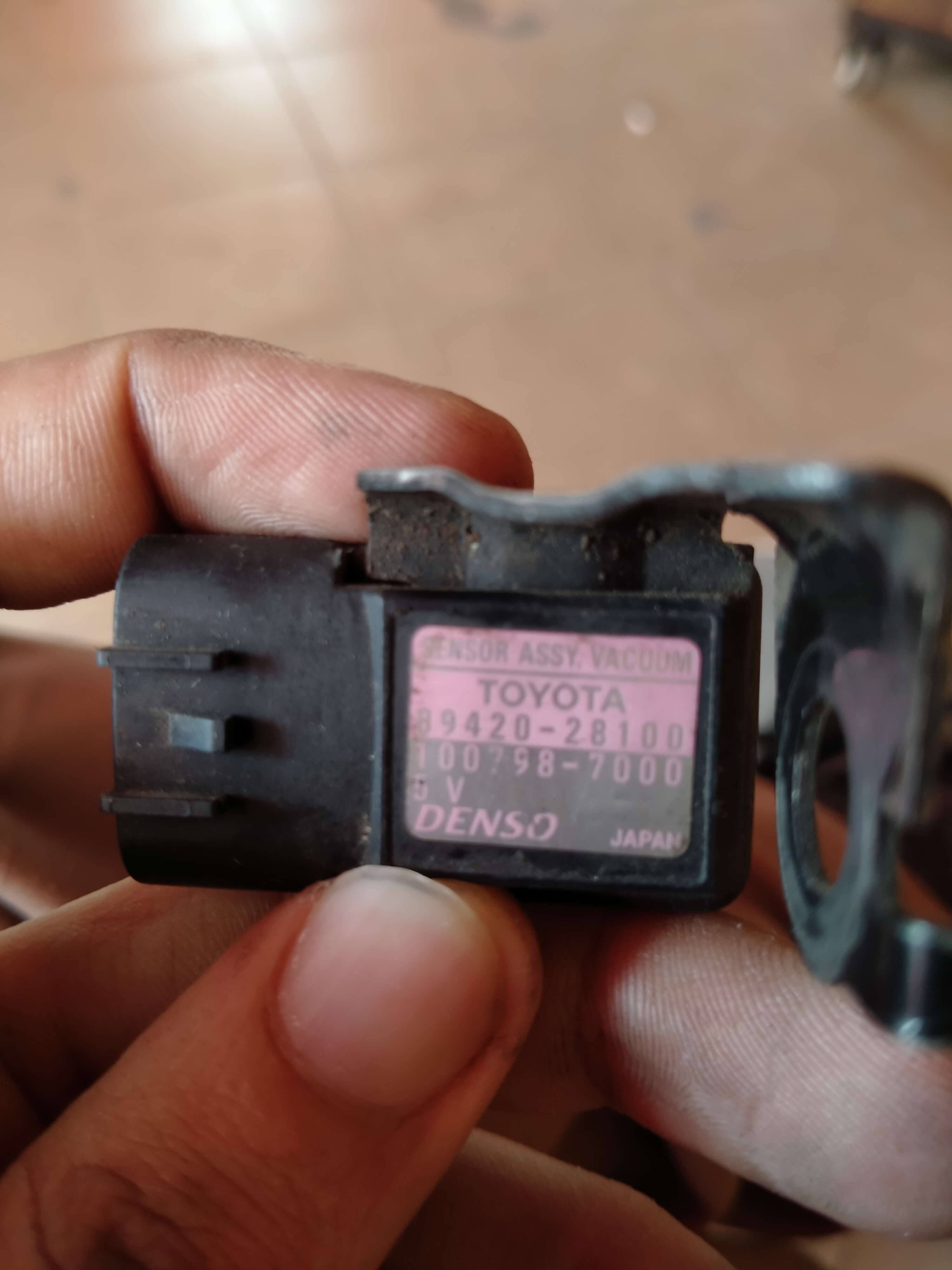

Assalamualaikum how r u?Any idea about 5afe map sensor part number
Wailaikum AssalamALLAH ka shukr how are you?You wouldn't believe. It's from Noah/Voxy 2001-2007 that came with 1AZFSE engine.These are the 5afe map sensors part numbers89420-1207089420-12190
I'm fine alhamdulilahOh okThanks for the information.
Yes that's correct one.

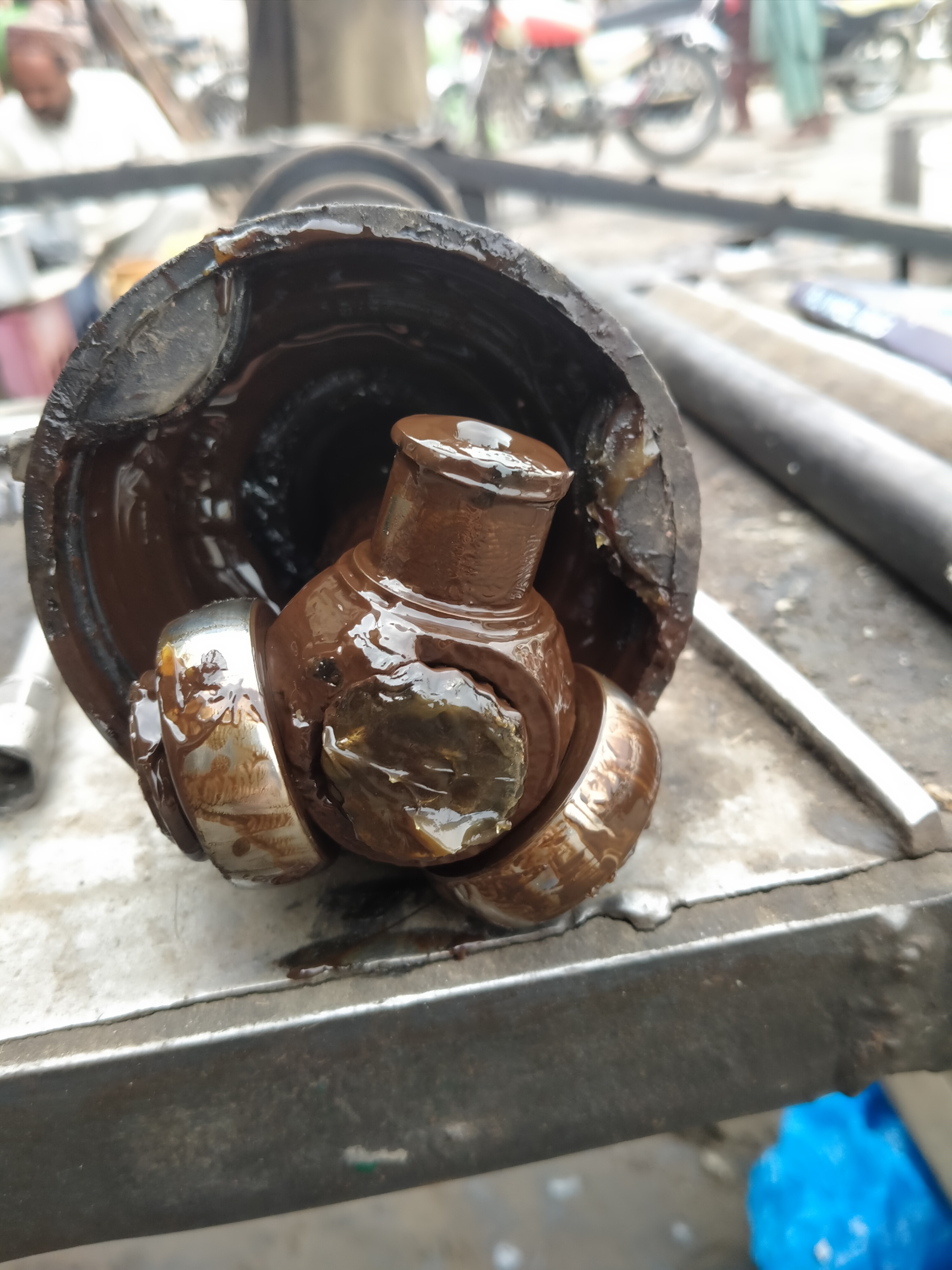

My gear side axle seal has failed again after replacing it once.It failed in less than one week.Any idea why this happened.My inner axle cross is also faulty.Could it be due to that?
How it is being but in?Bad cv cup can cause it.Be sure right seal is installed.
I guess it was hammered in.Will remove axle again and will inspect it's cup.The cross was faulty but it wasn't available at the workshop.
Shouldn't be hammered atleast not without proper tool.By cross you mean bearings?
Yes the inner tripod bearing
You can buy them new.
That looked like water got inside.
Because the clip holding the boot was not there.I cleaned it and put new grease in
Yes looks right
Glad to hear
