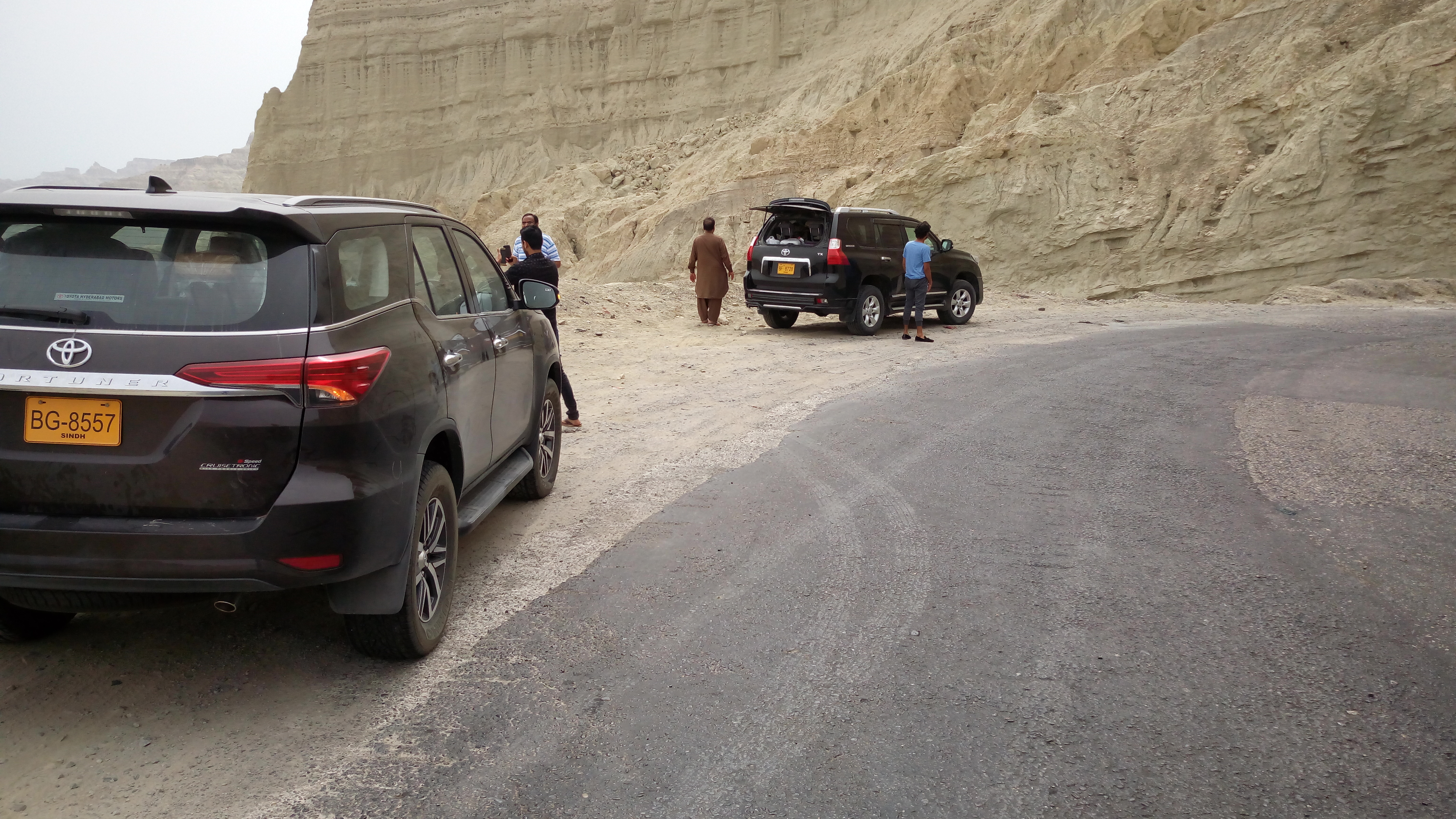

Not a huge difference between the two machines as observed over 700km stretch each way while bothbeing driven on constant high speeds 150km/hr + apart from the hilly area of hingol national park.
They share same engines with a little tweek in Fortuners adding dual vvti ,3 more bhps and 5 more nm of torque. But astonishingly Prado has a lighter more responsive initial throttle response. Prado is 4 speed auto gear while Fortuner is 6 speed auto cruisetronic. Both perform almost equal but to me Prado feels slightly punchy & light to take off while fortuner smoother but acceleration is neck to neck uptil 130km/hr and then there is clear edge with fortuner being smoother and powerful. Prado feels maxed out after 160 topspeed while fortuner did 175 almost 180 often with considerable ease giving significant gap vanishing infront of Prado.
