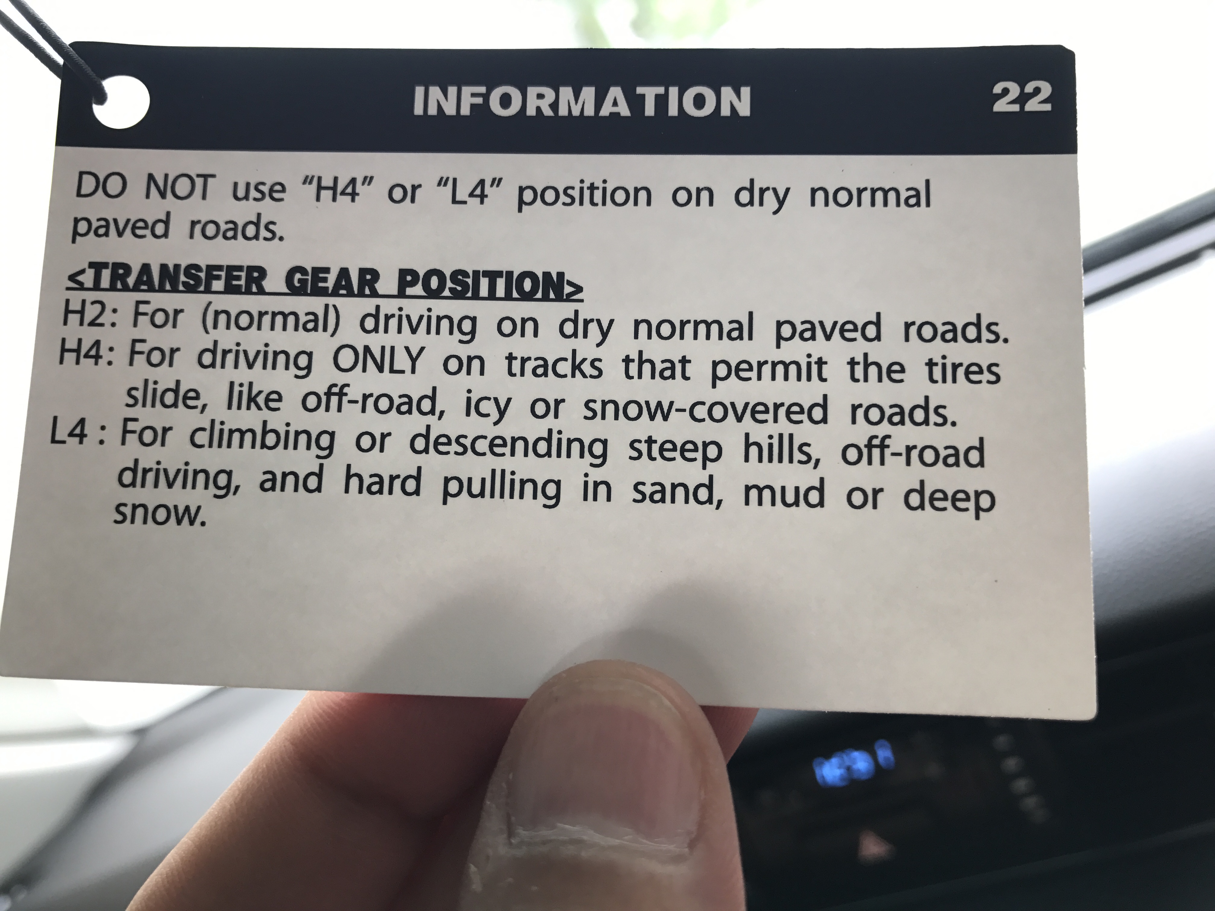

HOW TO USE YOUR DIFF LOCK WHEN DRIVING
First, a diff lock should not be engaged for on road driving, unless weather conditions such as snow or ice mean that extra traction is required. Use your locking differential when you want to go off road, for driving on difficult terrain, such as dirt, gravel, mud or snow. You will only need to engage your locking differential when you need extra traction, so you may only use it for a few moments on each off road adventure. There are two types of locking differentials – automatic and manual. Automatic diff locks will engage automatically when traction is lost. The diff lock will release once traction has been regained. Some automatic locking diffs will only disengage once one wheel is required to spin faster than the others. Manual diff locks put the driver in control, enabling them to decide when and if extra traction is required. There are various types of manual diff locks, most of which are worked using a switch on the dashboard or gearstick. These either work with compressed air, an electromagnet or are cable-operated. When your differential is locked, your vehicle will want to drive in a straight line, making corners difficult. Listen to your vehicle and do not put undue stress on it, otherwise you could cause serious damage to the axles. Off road enthusiasts differ on opinion as to which of the potential three diff locks (front, rear or central) works best, and while a rear locking differential seems to be favoured, you will find your own system as you take to the tracks. Once you have mastered your differential lock, traversing off road will get a whole lot more exciting, as you will be able to take on more challenging tracks and difficult terrains. Stay safe when going off road. We recommend you always carry a spare wheel and tyre, so that you are ready if a rip or puncture occurs.
