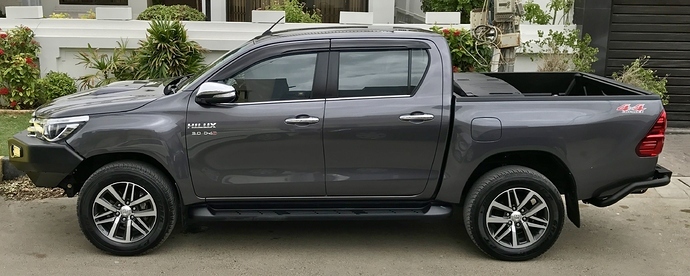

If you are concerned about the cost of air filter at which the dealerships are selling you, please note that I've been buying pretty decent (imported) quality air filters from Plaza Karachi at under Rs. 1,500 per air filter for my Revo and I change them after every 2,500 kms. Moreover, I'm getting cabin filter at under Rs. 1,000 which I also change at 2,500km. Helps keep my fuel efficiency as well as AC cooling at optimum level. My fuel economy after having driven over 16k kms is still average above 10km/L (80% city) and it includes one all-Pakistan 4,500+ km trip as well.
