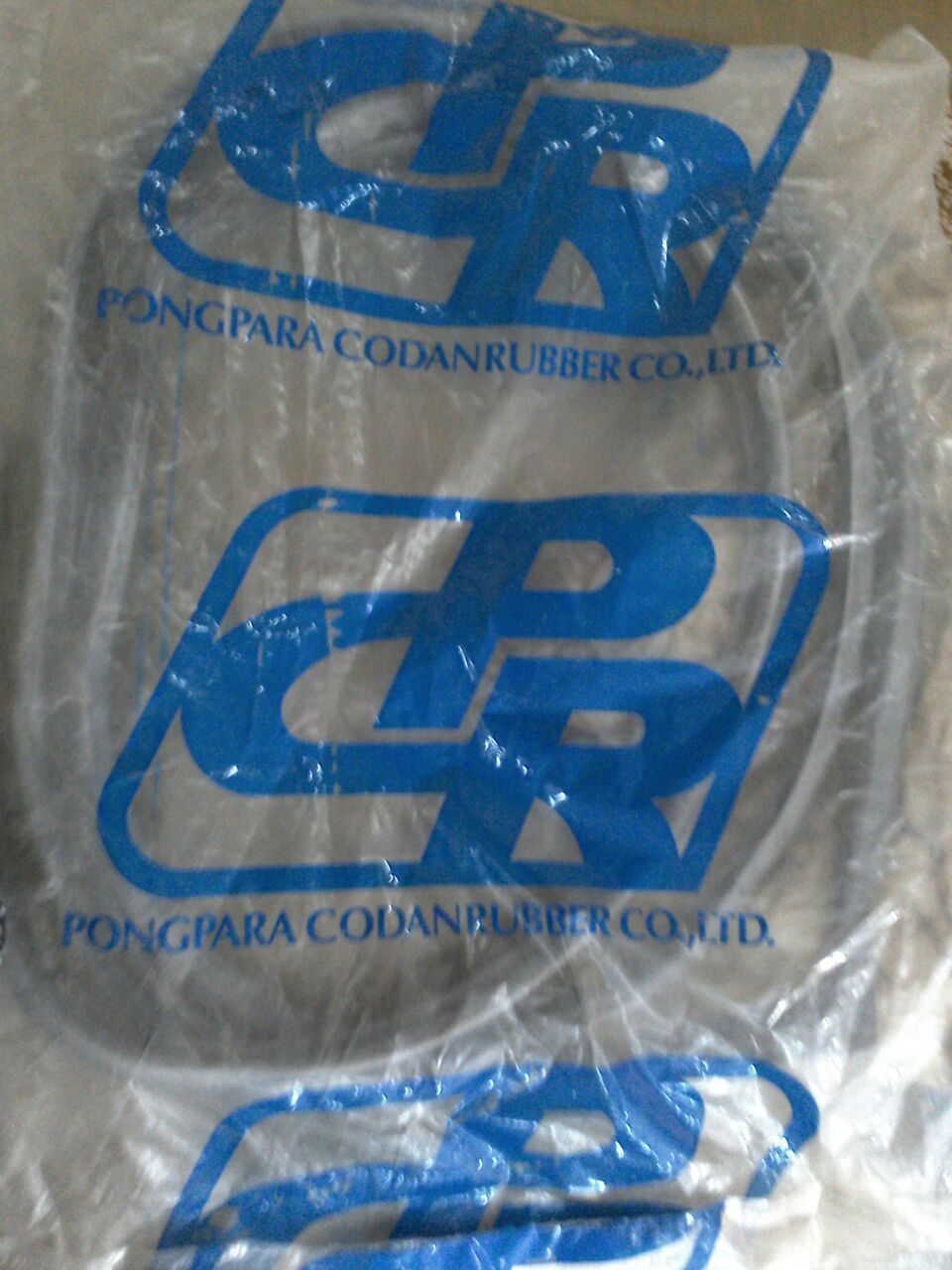

The inspiration for the stock restore is quite old and has been reignited by the restore done by my cousin @adilfj40 and his father. Both of them have been very helpful in guiding me and providing hints and tips. I even visited the City Sadar Market in Rawalpindi with my uncle recently and it was quite a learning experience.
I was able to do some homework along with my mechanic, with the help of the kind people and I was able to visit and do some research on required modifications from Lahore Bilal Ganj and the Rawalpindi City Sadar.
Here are a few photos of the vehicle before and during restoration process. Since I am not there myself and have to depend on the Mechanic and our driver to take photos and send to me, I may not be able to post updates regularly. And considering a busy schedule, the updates can be followed on instagram at umartlcbj40
