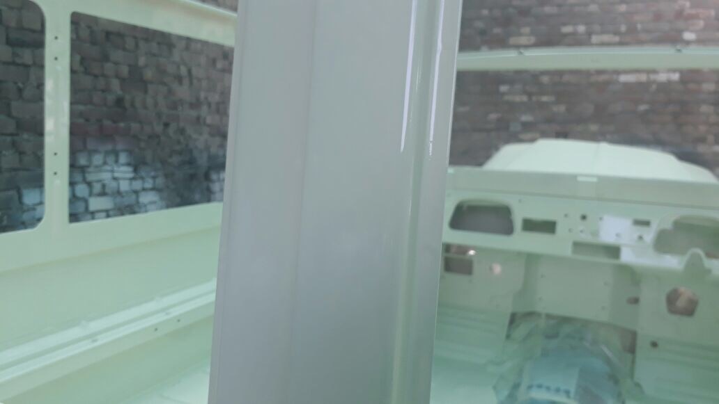

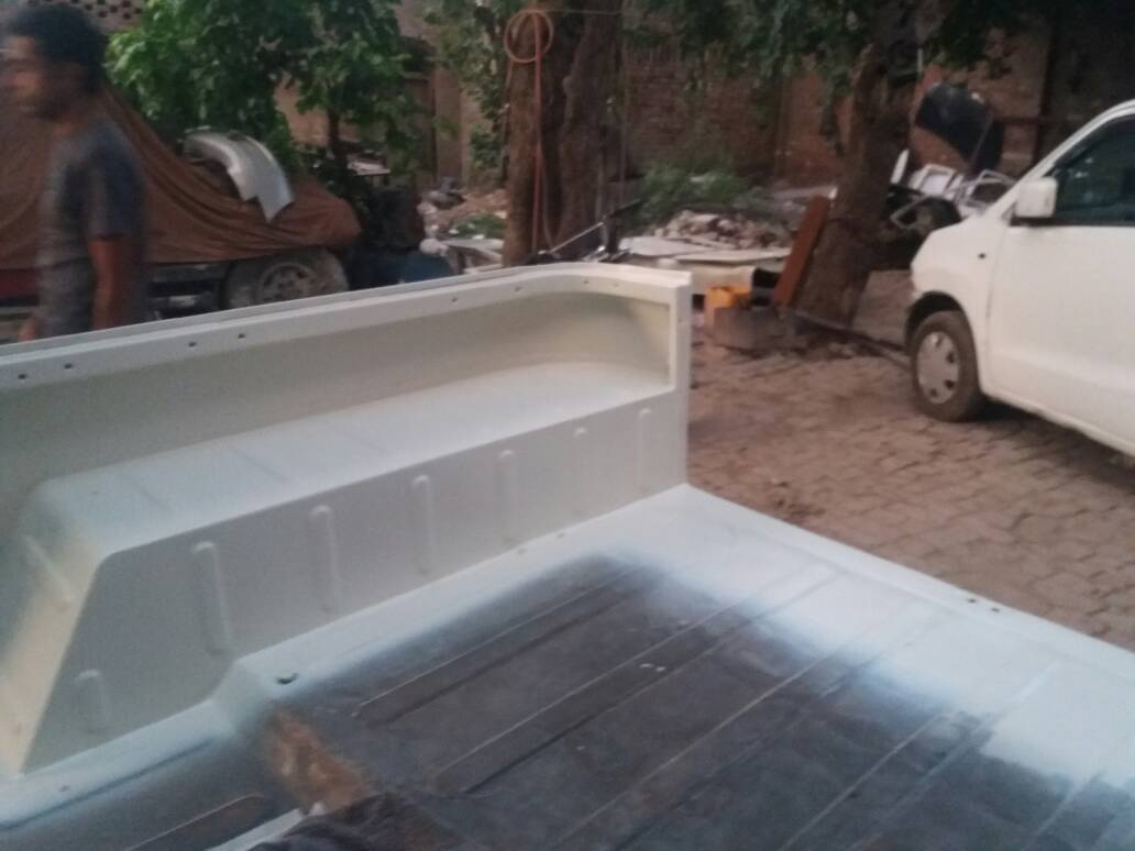

During the last one and a half month, the workshop people have been working on a test fit and body panels alignment. Only recently the painter started working on doors.
The progress has been painstakingly slow. The workshop people were held up on Panels alignments first, thanks to @AdilFJ40 Bhai, and his visit with his FJ40 to the workshop, the panel alignment issue was resolved.

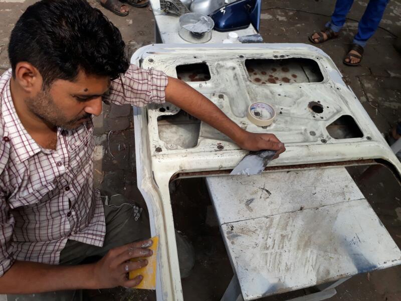

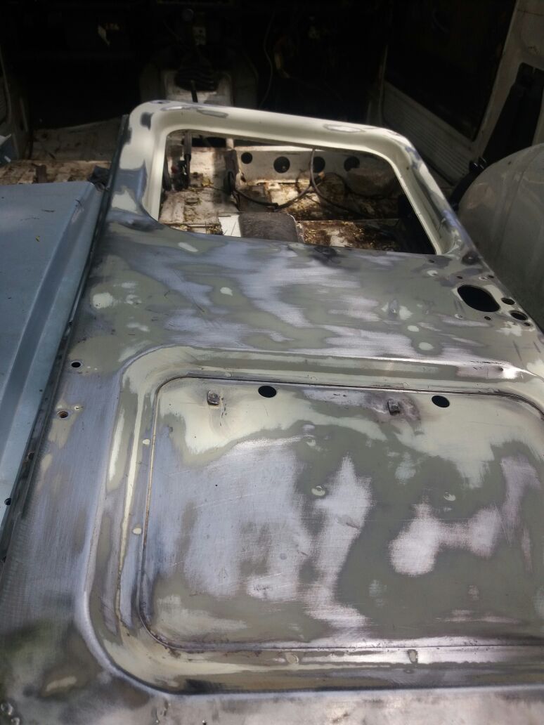

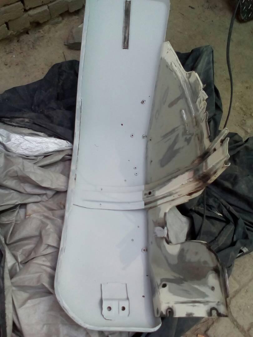

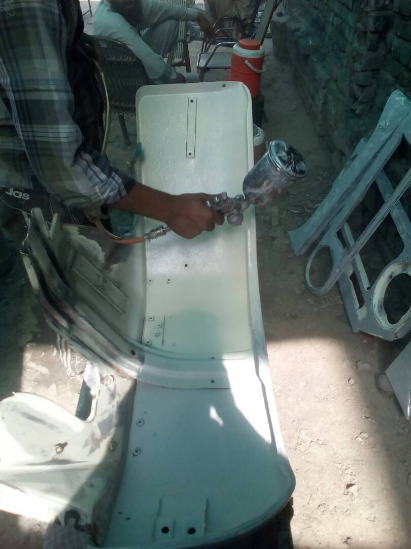

Painter has started with the doors and the bonnet for surface preparation. Rear left door and the spare carrier were replaced due to damage caused by bent spare carrier
The front Disc and hub assemblies are already purchased. The Mechanic and Painter have agreed to complete paint job by end of April, so Mechanic can start the remaining works to complete the project.
