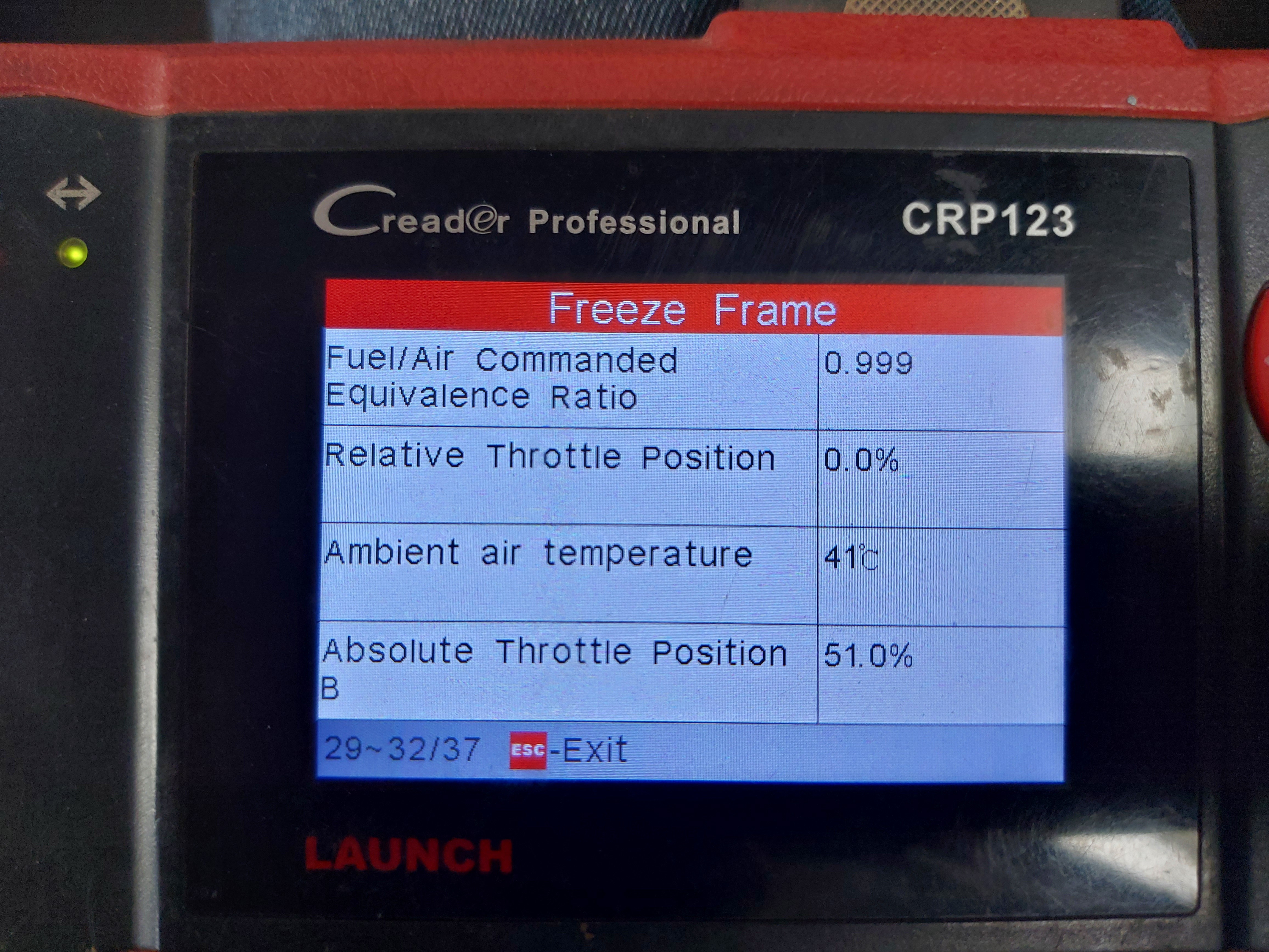

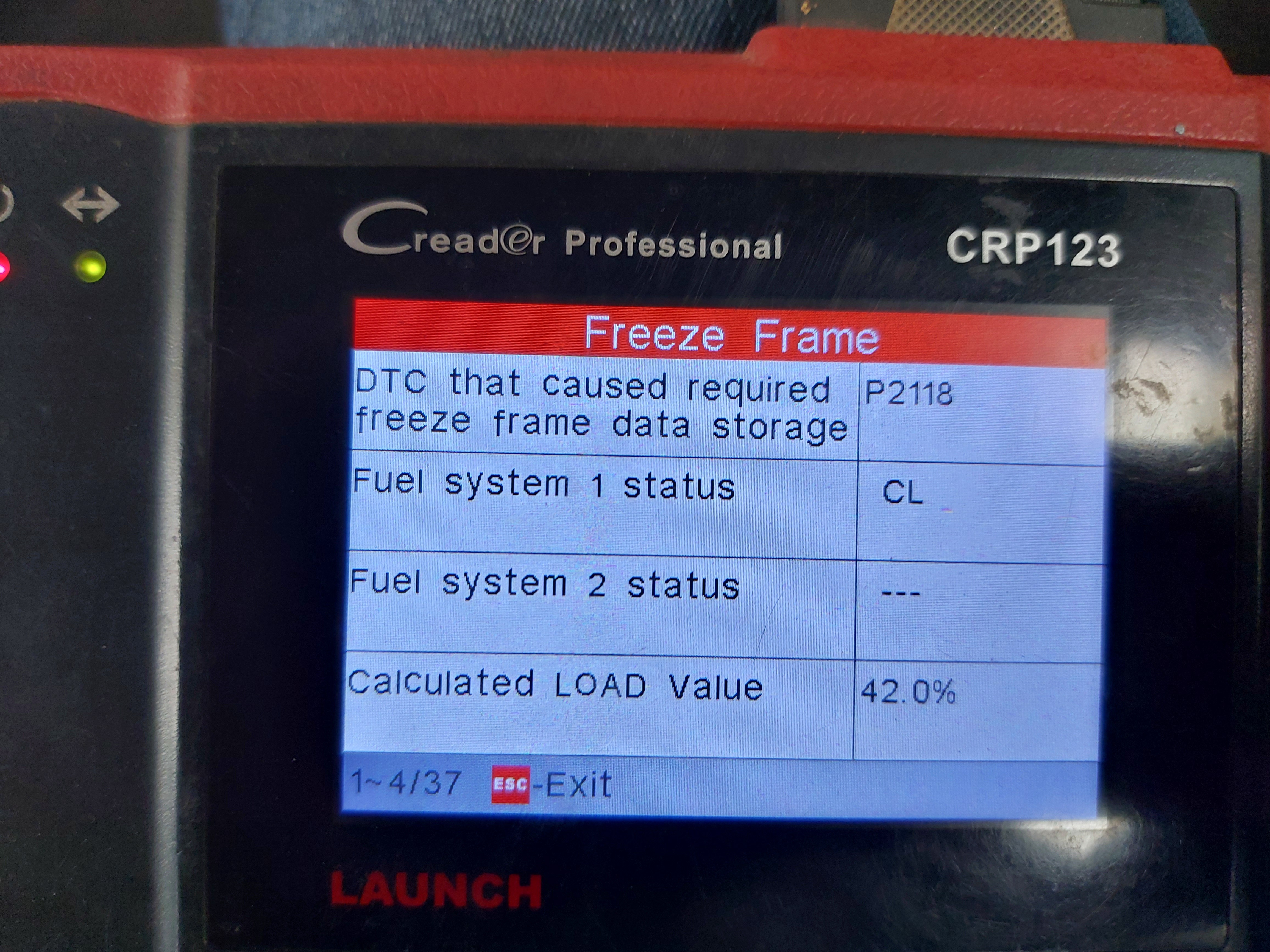

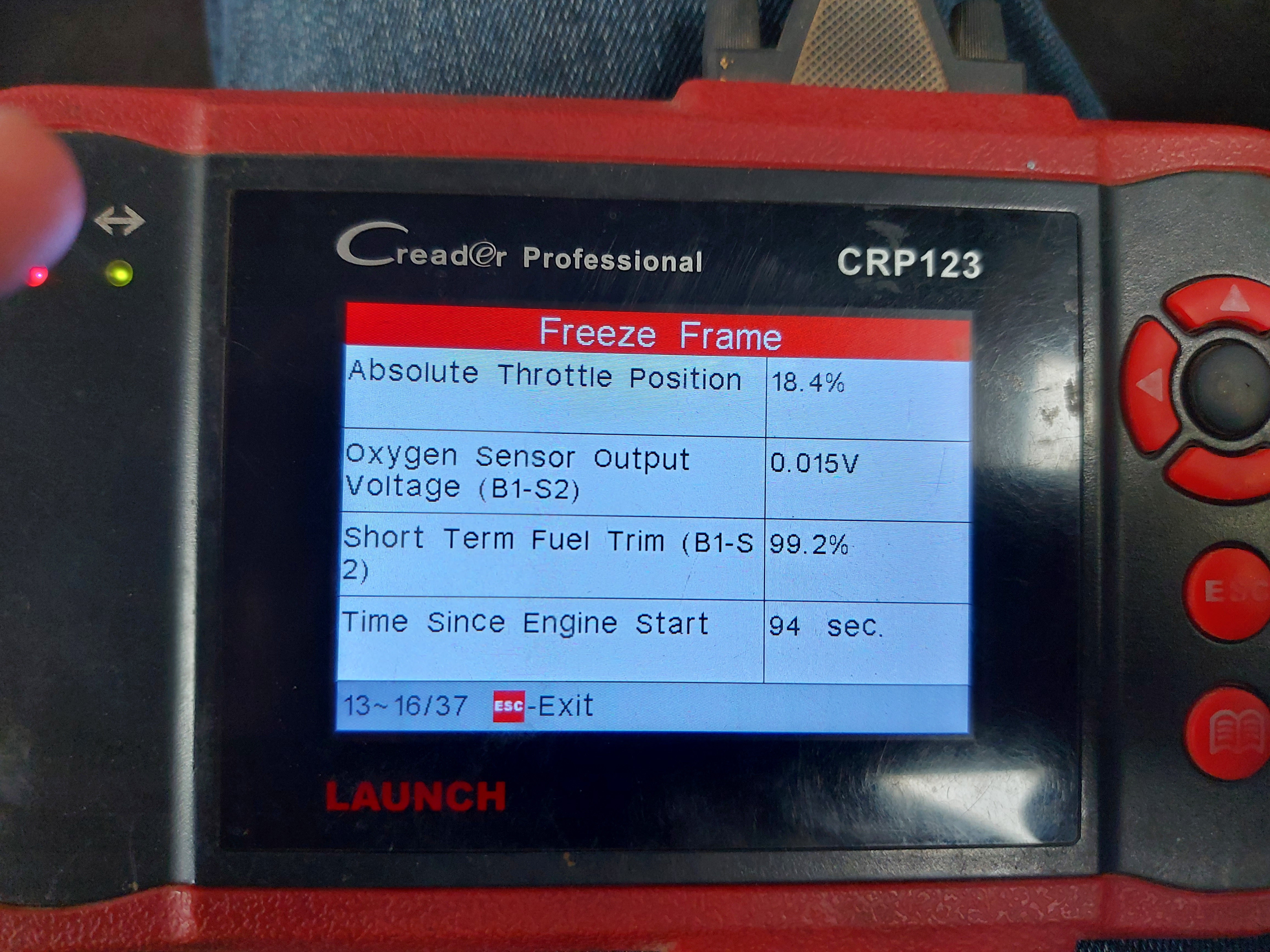

I own a self imported Toyota Passo 2015 (KGC30) currently at 27,000 KM's. Recently the CEL illuminated and upon diagnosis it translated to error code P2118. A quick summary and action that I've taken so far is as following:

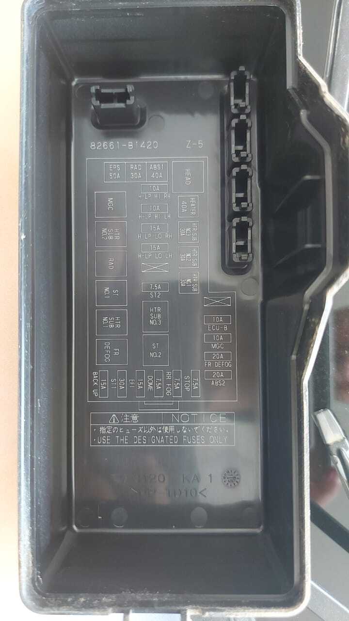

1) The very first time this happened, the CEL illuminated and power to the throttle was completely cut. Turning the car on and off a few times resulted in power restoration till the next time the car was shut off. Initially I checked all fuses in the engine bay per a quick google and found all of them intact.

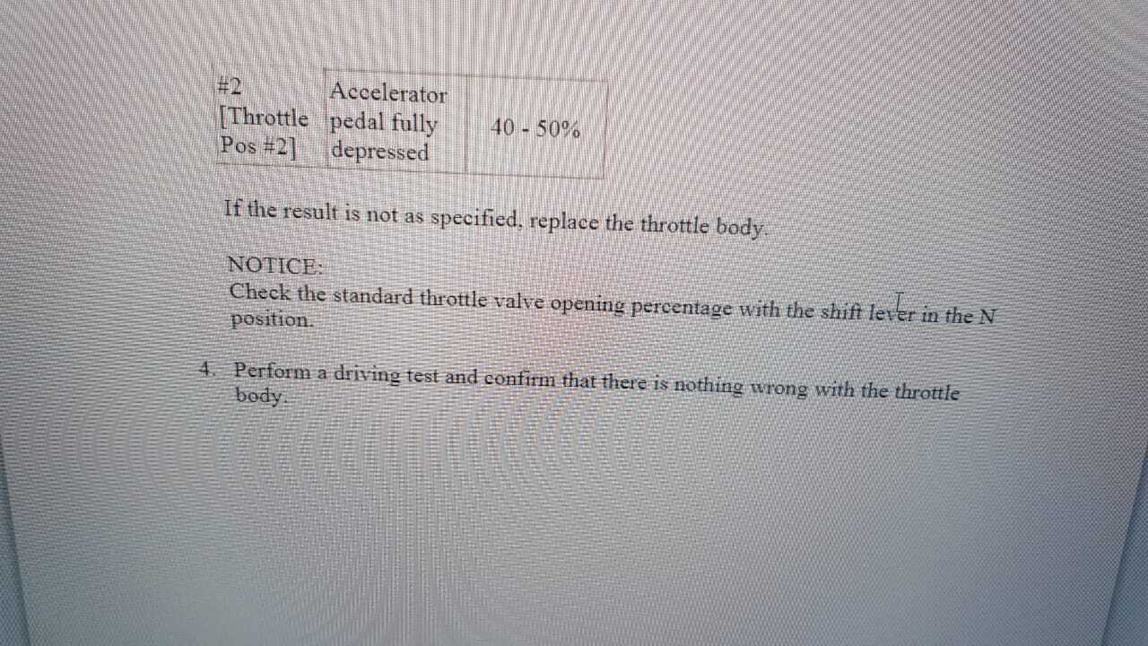

2) Took car to Toyota South here in Karachi. They were clueless and just did a basis wiring check and serviced throttle body / cleared codes. Car ended up working fine for 5 days and then resorted back to it's initial symptoms.
3) Initially the symptoms was intermittent but have worsened as time has progressed. The car is unable to move and the engine shakes at idle as well upon start before it is able to normalize. Have checked the battery / terminals / load tested but it is perfectly fine.
I spoke to a re-known shop here in Karachi who gave a final verdict of ECU change without even looking at the car.
Any advise on next steps - things I should look at? I'm currently in the process of ordering a wiring diagram from Japan so that at least a proper diagnosis can take place (if someone already has this, please reach out). Extremely hesitant taking my car to rookie mechanics who may end up ruining it further.
