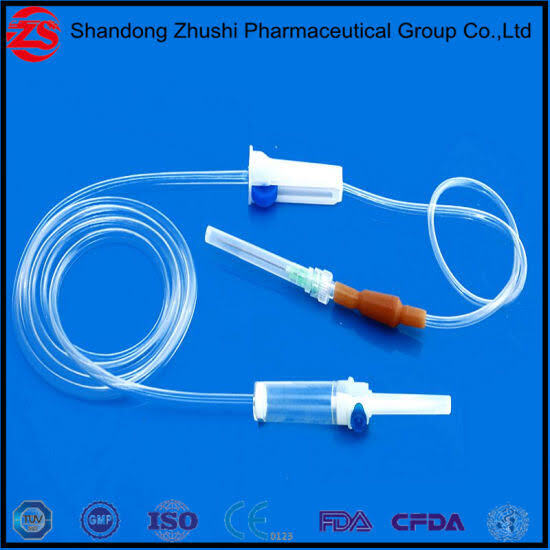

Yes I used it. you will be needing a medical IV apparatus. It looks like this.
Inject incoming side into the bottle where rubber seal is, and make a hole on the bottom side of bottle by keeping it upside down. Insert the outgoing side (remove needle) of an IV line into the intake by removing a pipe coming from engine attached nearby throttle body. Start the IV line at normal pace, and keep rpm of your car upto 2-3k max.
